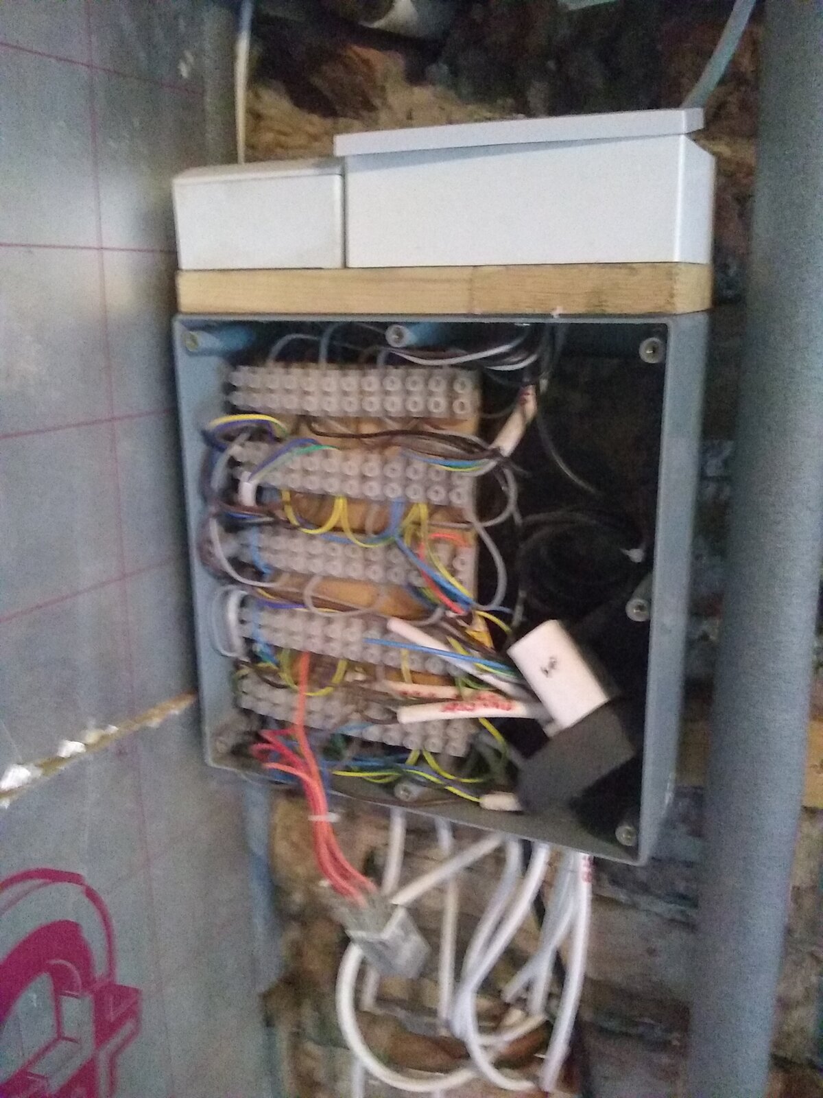

AB = Adaptable Box. Bring all the wiring back to that box, you can then reconfigure switching without running new cabling everywhere.

Is there a link you can suggest for an adaptable box. Is this something you create or buy of the shelf?
Google broken today is it? Adaptable box- plastic or metal enclosure, not specifically configured for anything (metal boxes often have knockouts for conduit). Like this 16150384467571489079480682188438.jpg
