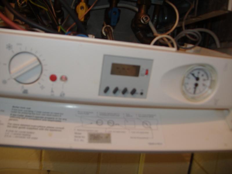

Hi I have had this boiler for four years and had it power flushed in November 2010 and the engineer also pumped some air in the boiler as it was low.
Unfortunately the boiler has developed a fault and is leaking 1-drop-per-20-second.
Could someone advise what the fault could be? flow switch/diverter replacement?
Also noticed that the boiler looses some pressure over a couple of months. Minor amount.
I have included some images of fault in my album.
Any help on the matter is greatly appreciated
Thank you
Grover
The flow switch gland nis leaking ane needs to be replaced but deposits on the shaft bwill need to be removed at the same ime to prevent a reoccurance.

All done.
Noticed the switch was working but the plastic housing was goosed so installed a new switch.
Job done

After leaving the boiler off for a few days the boiler has stopped locking out.
It is still leaking at the gland and the green light pulses in 2 second intervals.
The boiler state is that whilst DHW is intermitant and there is no CH. After removing the clock plug from the pcb the ch sarts to work fine but when it is pluged back in ch stops working.
I am going to replace the the gland and whilst replacing the glad is there any other servicable part that would be worth replacing? (diaphram/divertor valve kit)
Can someone advise how to access diagnostic mode on this boiler and is there any advice on the ch fault?
When dip switch 1 is switched the main green light pulses quickly and other green and red light a on.
When dip switch 3 is switched the main green light is on and the red light pulses 1 per second and the other green light is off
