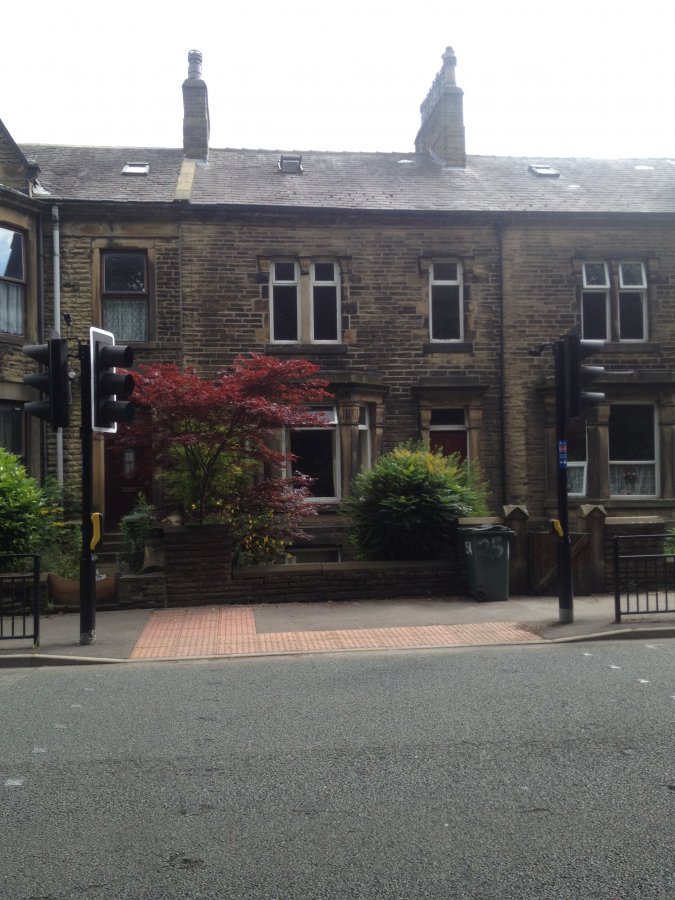

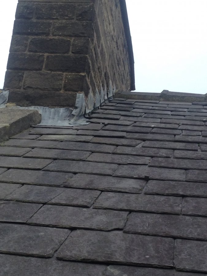

Which is your stack in the pic?
Is it the LH one with what looks like a kind of parapet or left in place roof ladder?
Go up and photo the flaunching on top of the stack, and the stack itself, and the flashings, and post pics on here.
Removing traditional pots can cause the property to look odd, and "small gas terminals" might give even more future difficulties than the pots ever did.

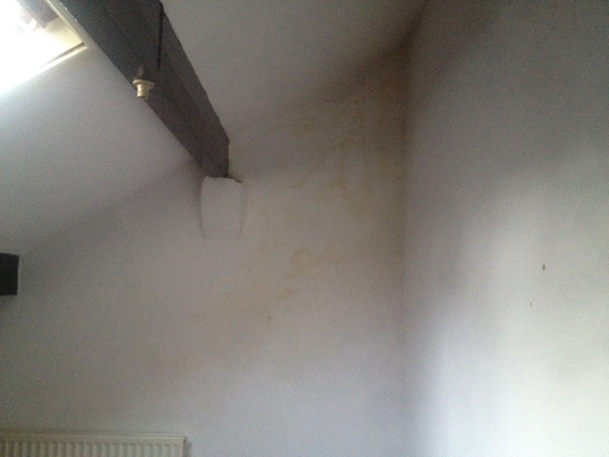

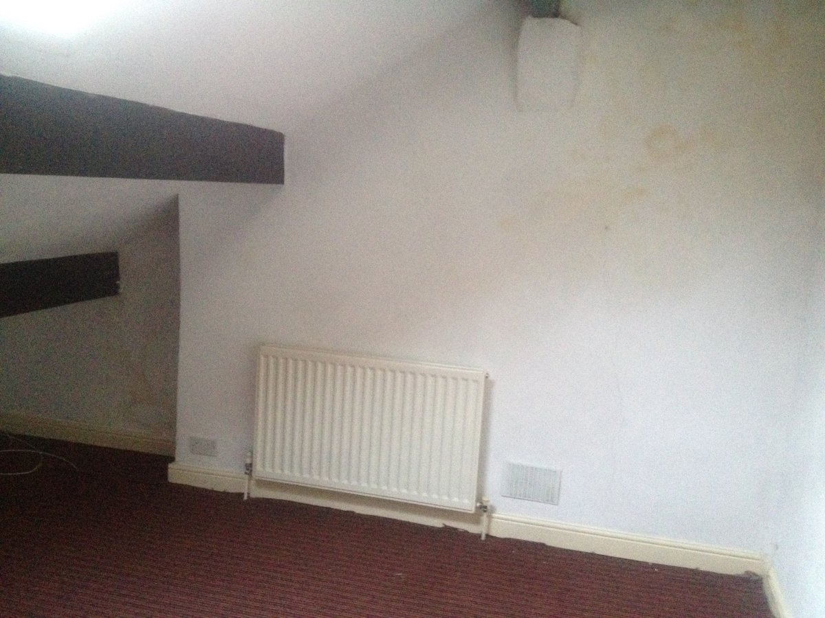

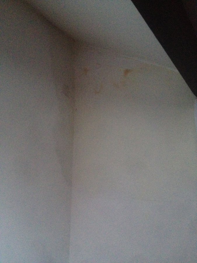

Pics of the leak signs in the loft rooms might also help?
It is the left sided stack. My house has the open velux.
The damp is coming through at the apex of the roof (the highest point). The chimney is big and has 8 pots on it. There is also some damp around the left side of the breast when you are stood in the room. So looking at the photo it will be around the front of the chimney stack.

The first ones are of the inside:

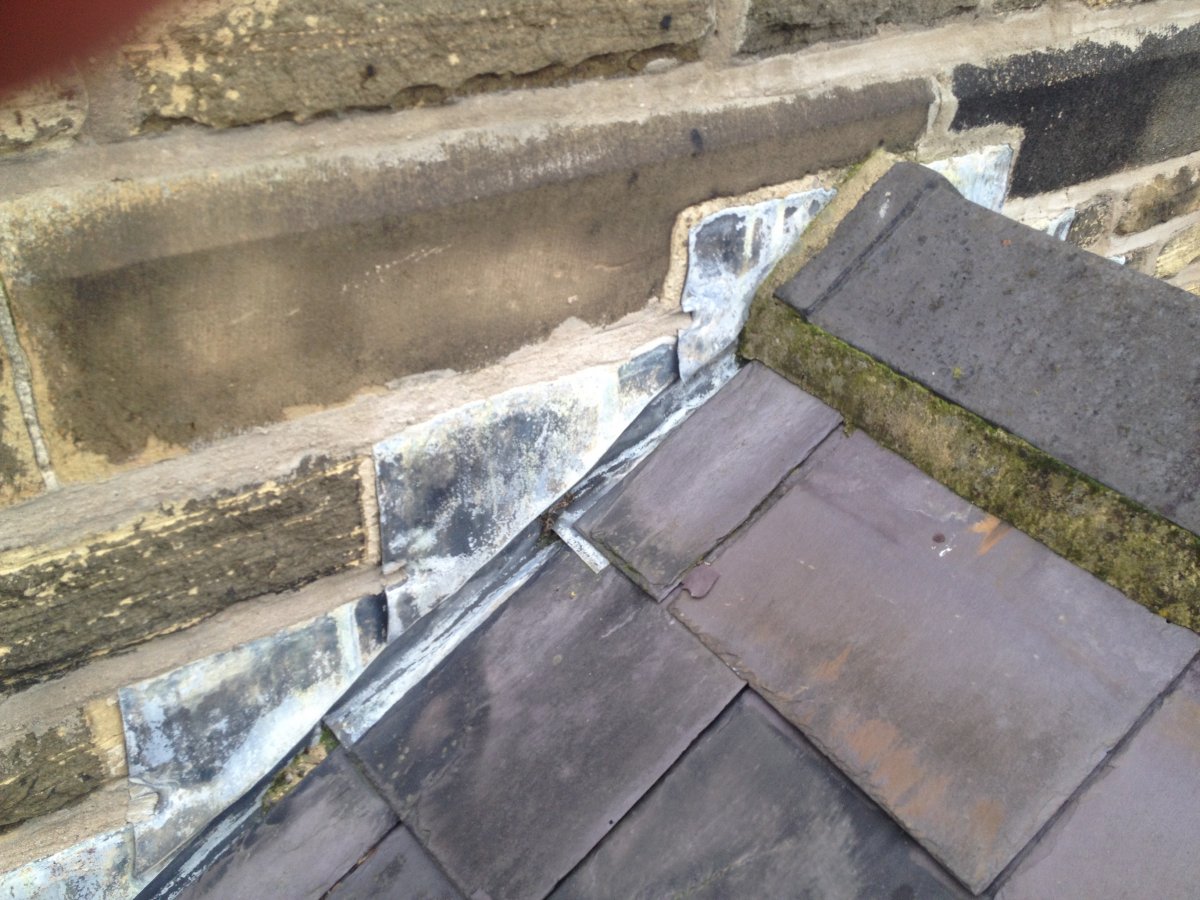

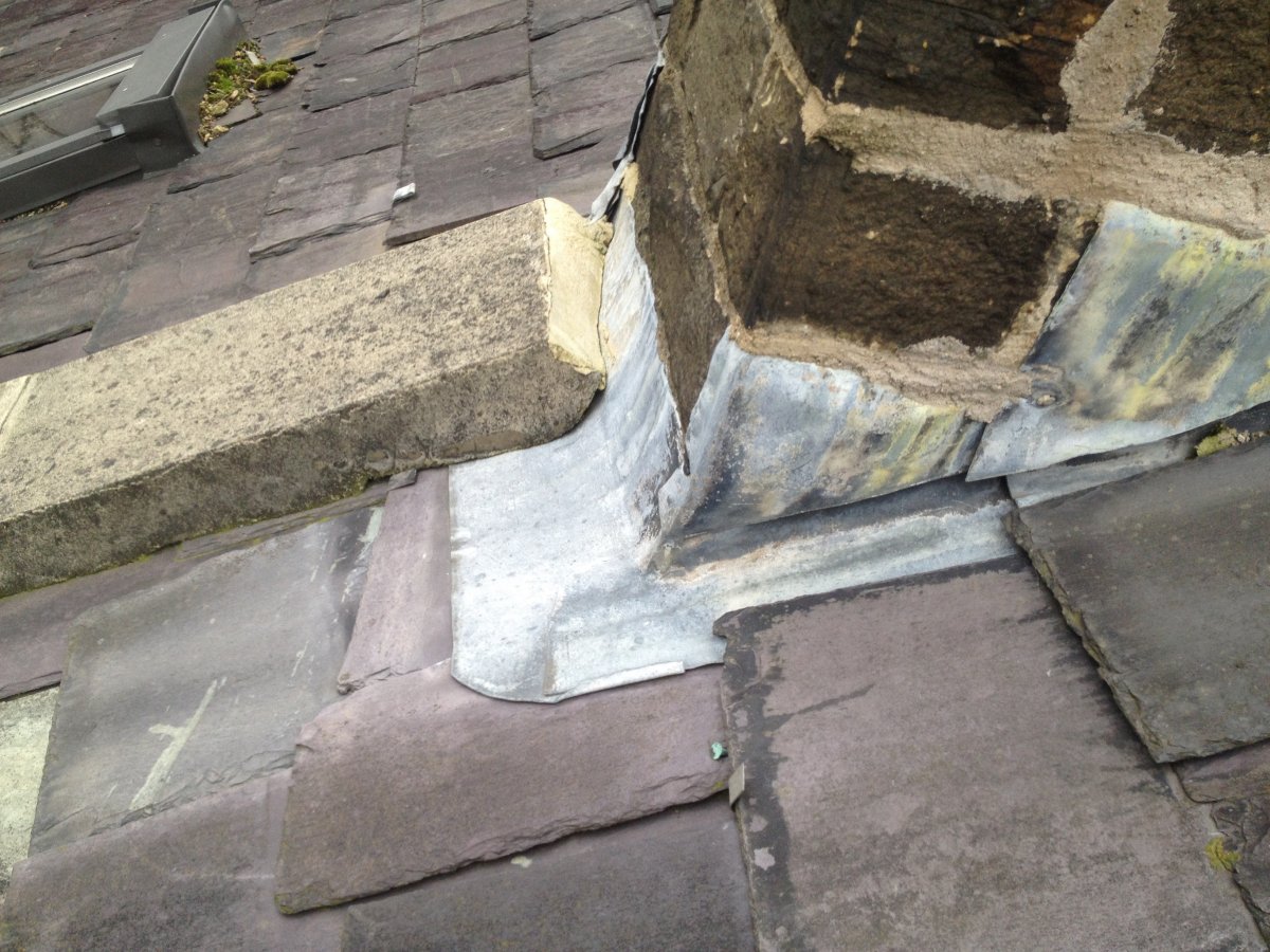

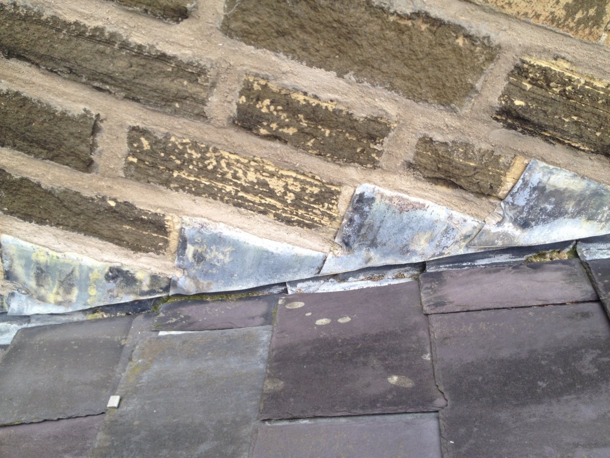

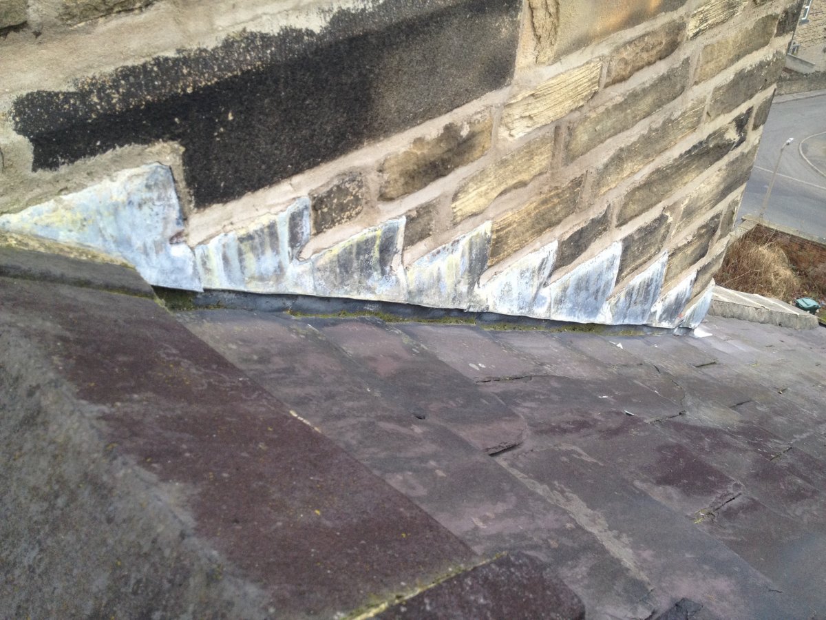

Some photos of the flashings

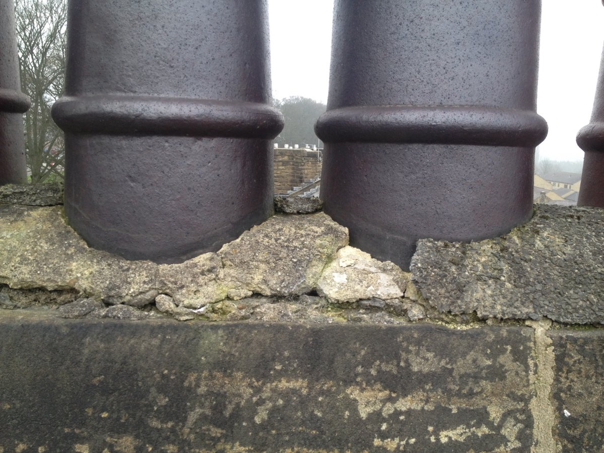

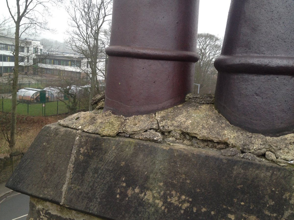

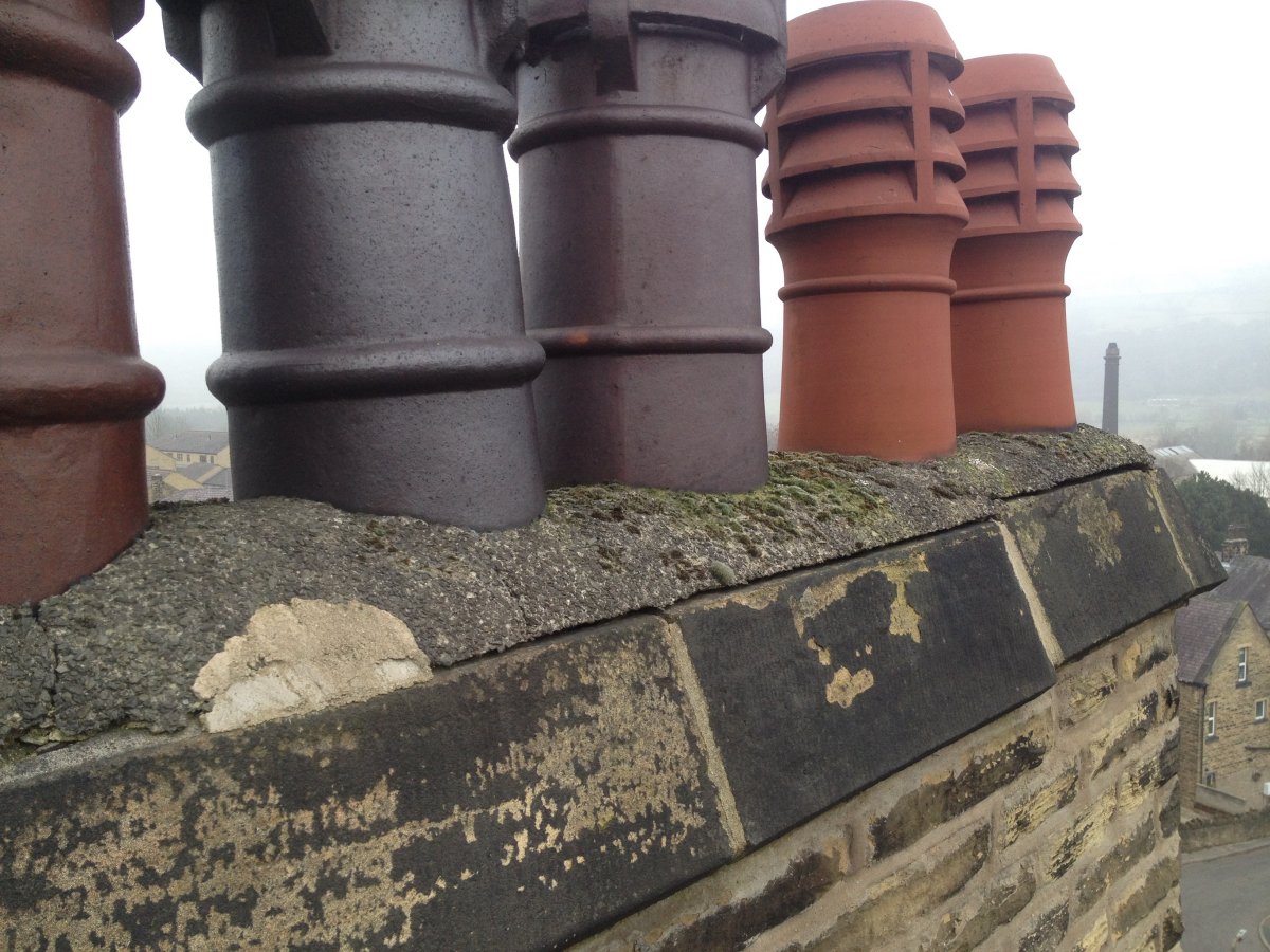

The chimney pots and haunching.
The main leak is the right side of the stack. This haunching seems in better condition than the left side.
Opinions welcome. I am pretty sure i will be removing the chimneys and replacing with small gas terminals. A neighbour has done something similar. None of my flues are being used for any fires as all have been bricked up. They have the vents in place though.

You dont seem to understand what I've been saying with ref to your chimney stack and pots - you could end up giving yourself extra work & more expense doing things your way - just saying.
There is a "parapet" that presumably is on a party wall?
The "parapet" in the pic looks very odd. Why do you even have it?
It appears to have been plonked on top of the slates, and over the apron flashing at the stack - it should have a saddle flashing where it meets the stack, and be properly bedded and flashed all the way down to its finish at the eaves.
I'd imagine that water is definitely coming in under the parapet.
Water will also be entering the roof at the step flashings and soakers. Work will be needed.
Likewise, all the flaunching is in need of completely stripping and redoing. All of it back to brick.
step flashing can not be effective in its current form.
chimney head is knackered
The slates on the adjoining roof do not course through so i guess that's why the coping is there. check slate size and gauge.

Why do you think the water is coming in at the step flashings ? They all look pretty good.
This issue happened 3 yrs ago and so i thought it was all down to the pointing. So i repointed and all has been fine until recently.

Well that last pic shows much more.
The slates are in better order than the early pics indicated but to re-arrange the soakers you will still have to lift some.
Any cracked or off-cut slates should be replaced.
The parapet will have to be lifted and re-bedded.
The last ridge tile usually has a saddle flashing?
