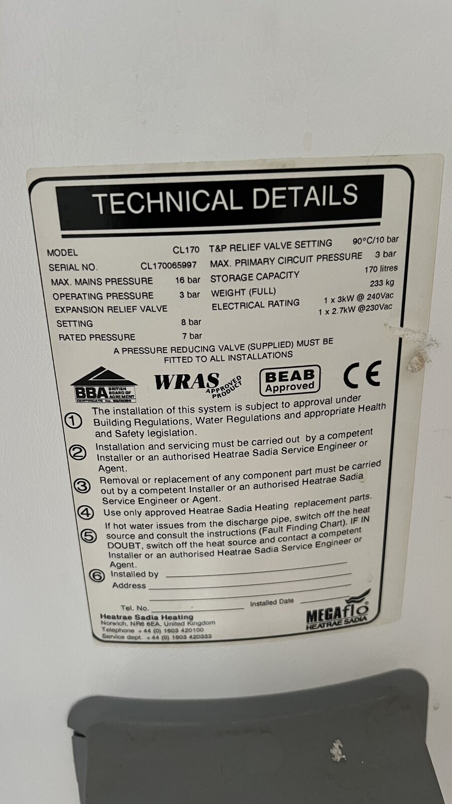

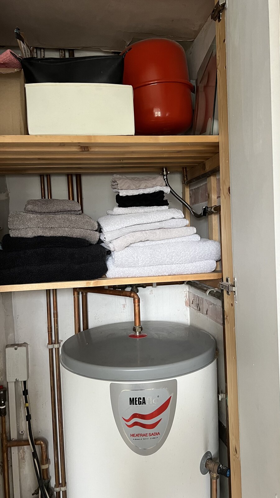

Hi,
Just moved into a house from a flat and I have a couple of queries.
We have a Worcester gas fired boiler - Greenstar Ri (in the kitchen on ground floor) and a megaflow (on the first floor) plus a small red tank that I do not know what it does.
Heating is set to off on the boiler, while water is set to on (not on a timer, always on).
1) issue/question
I noticed that often the gas fired boiler is turned on, and it would seem to happen when using the hot water eg to do the dishes.
Does it mean as soon as I use some water, the megaflow gets the boiler fired up to replace the water used? Is that efficient from an energy perspective? I.e. I might use the hot water only many hours later..

I'll have a go at some of your questions.
The "small red tank" is an expansion vessel.
When water is heated it expands, and without the expansion vessel the water expansion would split open the Megaflow or connected pipes. The expansion vessel contains air which is compressed as the water expands and prevents damage to your system.
The hot water is stored in the Megaflow. When you use hot water it's drawn off from the top and colder water comes in to replace it at the bottom. About two thirds of the way down the cylinder is a thermostat, it detects when the water inside has cooled, needs heating and then fires up the boiler. The Megaflow is well insulated (and so should be any hot water pipes connected to it - yours aren't) once the Megaflow is hot, heat losses are minimal. Using hot water and allowing cold water to enter at bottom will of course cool it. Your uninsulated pipes especially the on at the top will be loosing heat though.

If the expansion vessel is red, its the expansion vessel for the central heating system. Megaflos have an internal expansion air gap that needs recharging periodically (instructions printed on the outside of the megaflo)

Hot water tanks allow you to have a more economical boiler that is correctly sized for your central heating system but can also heat up your hot water in the cylinder and also allow you to heat the water electrically by immersion heater. A combi boiler (what you call a standard boiler) has an oversized heat exchanger to allow production of sufficient hot water when you turn on a tap as well as doing the central heating. A combi will cope with one tap or shower running at the same time, but can't flow enough hot water (unless its massive) to supply more than one tap or shower.

Megaflo 170i reheat time is a claimed 22 minutes (from 15 C incoming cold to 60 C hot). It'll be a little longer in winter if cold in is 5 C (say). Also IF the towel rail is on the HW reheat circuit it may take a longer to reheat, too as some energy is lost to those?
