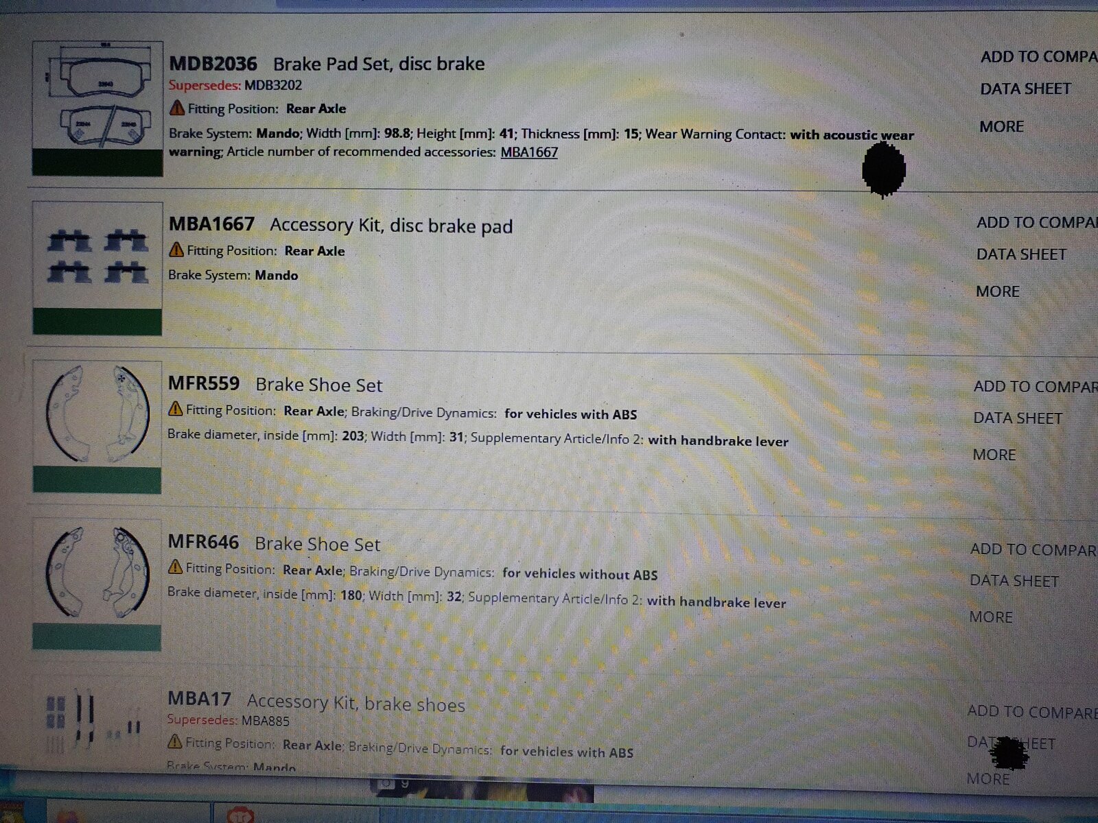

I've looked and I have drum breaks on the rear

I put the reg number into Brakebook.
This is what it has.
