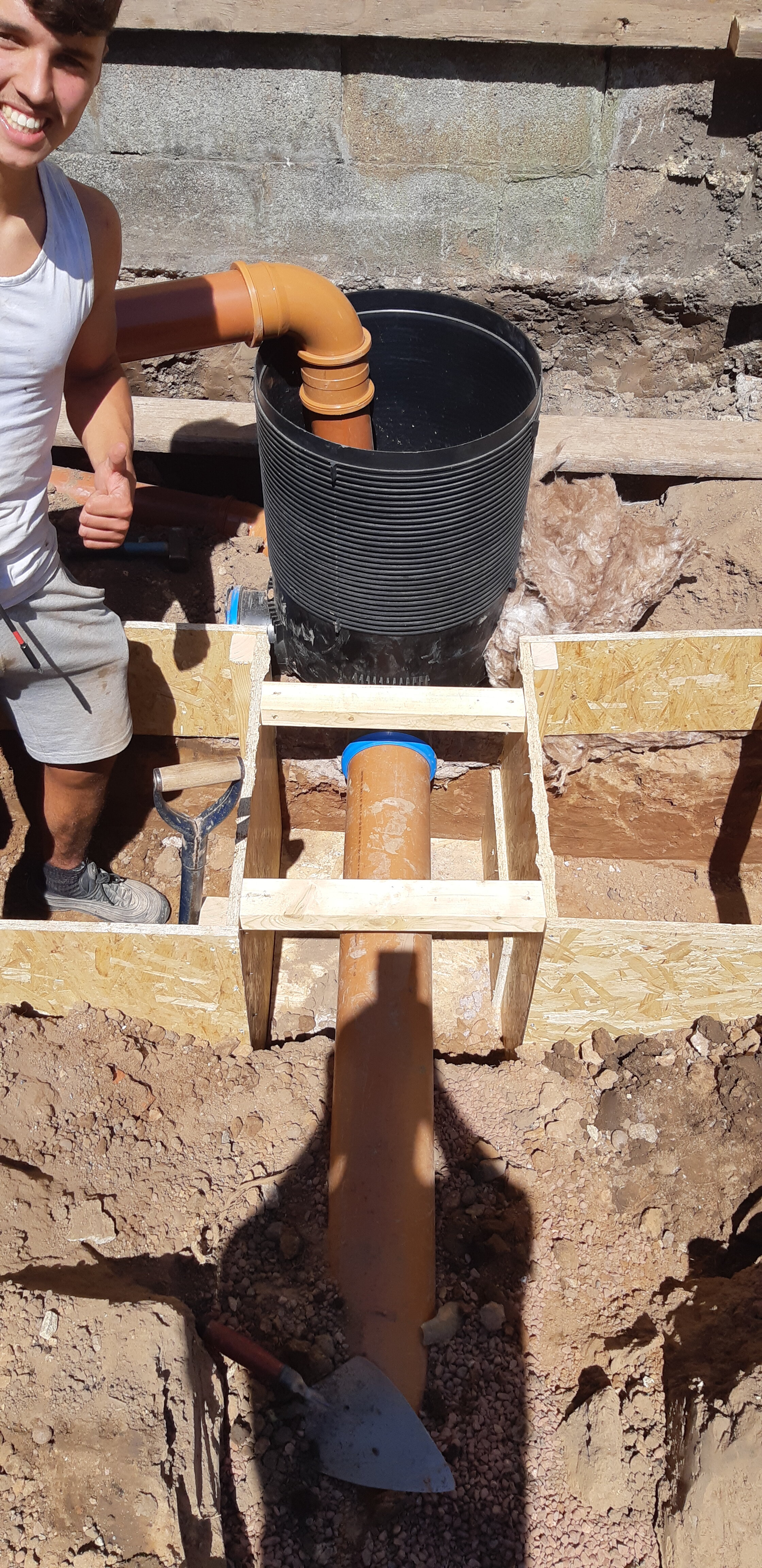

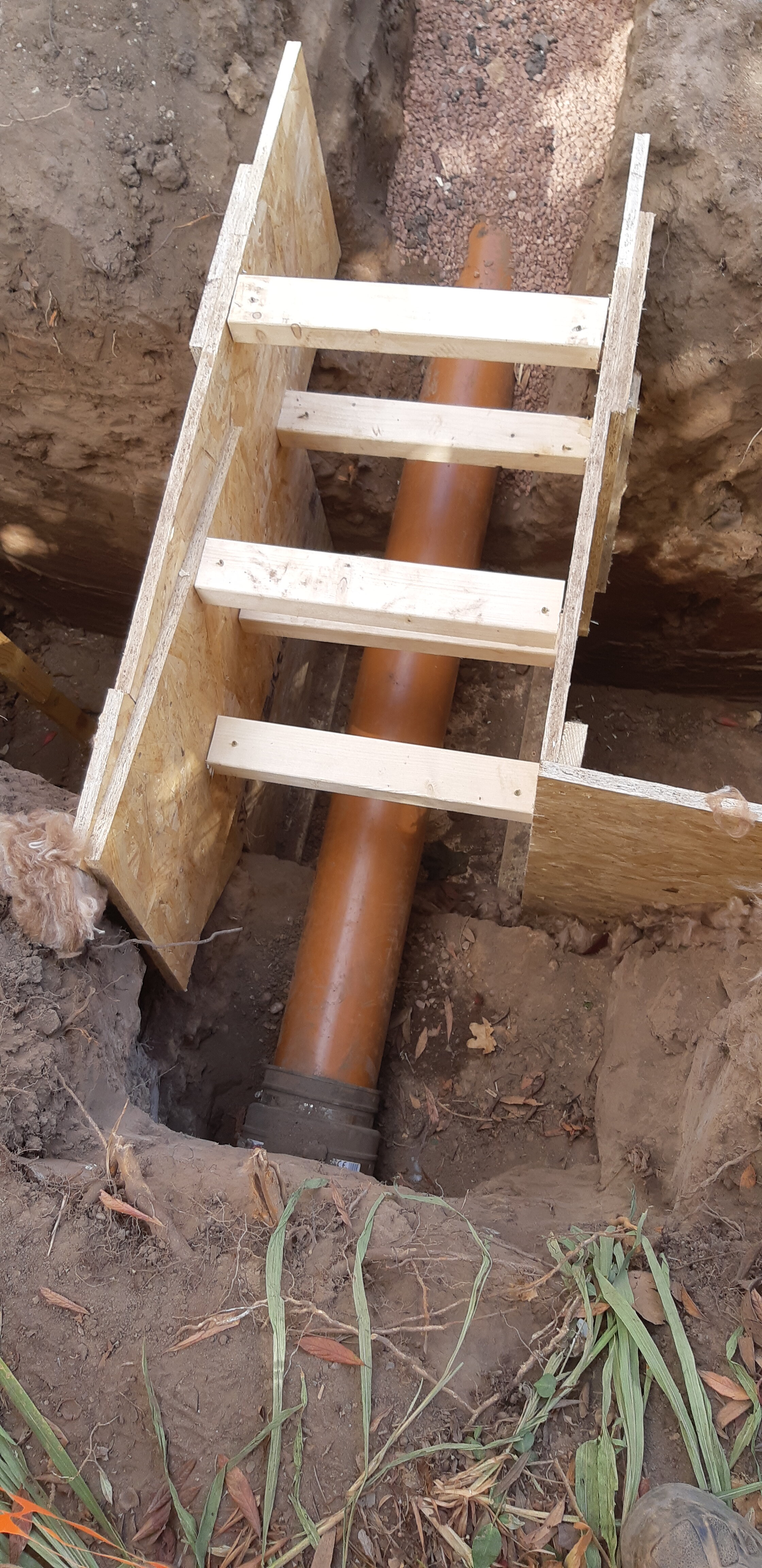

So having had a look at the cctv footage the camera goes down a 150mm pipe (public sewer pipe) then to a preformed pvc 110mm inch junction then goes back to a 150mm pipe (public sewer pipe) downstream
Question: Do you think they will make me dig out the inside of my kitchen area or are there ways around to remedy this?
Question: if it had to be dug up then will my foundations be ok?

So your builder reduced a 150mm pipe run down to a 100mm fitting and then back up to 150? That's nuts and you don't really need to be told not to do that. Anybody with even the lowest level of basic knowledge should realise it's not a good idea.
I can't see any way that your builder is not liable for this and I think you should, at the very least, make them aware that this might become a problem.
Yes I have and hes kinda fobbed me off really and said that was the only way to do it and that the building inspector signed it off. (He keeps passing it off to the building Inspector)
The builder now wants to get another CCTV survey done by someone else he knows! I said fine it doesn't change the fact that he has put a small junction on two bigger pipes.

What would you do in this situation? I think it needs digging up and sorting? No idea how building control passed it as any drains and foundations need inspecting even before the final CCTV survey stage? To reduce a 150mm pipe is just ridiculous.
What would you do in this situation? To reduce a 150mm pipe is just ridiculous.
Correct. Fudging ridiculous.
6" stuff is ridiculously expensive and not the easiest to get hold of. But these are poor excuses. We come across it often around our way...
Granted, we may grab a 110mm junction and slot it in as a temporary measure, if we say broke a 6" main line whilst digging a foundation. It would be swapped as soon as I was at the builders merchants, buying drainage products though.
