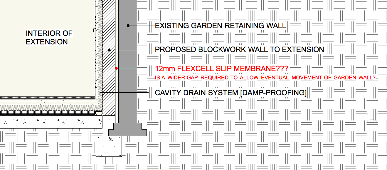

Hi I am planning on building a one storey extension to the rear of my garden flat which is on the ground floor of a victorian terrace house in london. There is an existing sunken patio to the rear of my flat and there is a 1.2m high retaining wall holding the raised garden. The extension I want to build will infill half of my sunken patio.
question 1: I do not know if I can build my new blockwork wall right up against the existing garden retaining wall or not, or should there be a gap left? Or should the retaining wall be taken down and rebuilt stronger to be integrated into the extension? Ideally I would like to have the new blockwork wall as close to the existing garden retaining wall as possible in order to be able to save space.
question 2: In terms of tanking I am foreseeing having a cavity-drain system on the inside of the new blockwork wall, but would I let all the damp and moisture from the garden and existing retaining wall through the outside of the new blockwork wall?
thanks in advance for your advice...

Hi,
What the the construction of the existing retaining wall? Masonry?
I don’t have answers to all your questions but I do have a few comments.
A drained cavity is an effective way of tanking a basement bit you’ll need a good good builder with experience of this kind of work. Quality needs to be good otherwise you’ll have problem.
For a grade 3 basement which is what you’d be wanting for a habitable space I’d suggest having two barriers to water, maybe a drained cavity and an external membrane.
For more info on waterproofing of basements this is a useful guide https://www.ice.org.uk/getattachmen...ing-the-risk-of-leaking-substructure.pdf.aspx
You're in the relams of specialist design for what is effectively a basement, and structural retaining wall.
You certainly would not be anticipating movement of a retaining wall.
