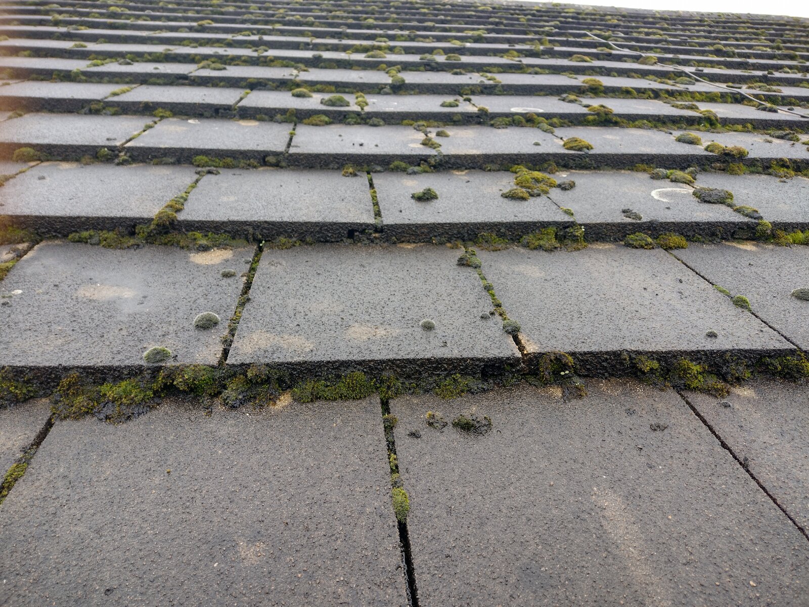

Interesting you should say that. Besides the felt, I assumed that the leak was being cause by some cracked/missing tiles.
However, none of the tiles were cracked/missing. Could it be the moss or something else?
Will I need to clean all the moss from the roof for a better job?
I got on the ladder and took a pic of the roof. Do any defects stand out?

The tiles are Marley Concrete interlocking tiles
They are flat looking and mimic slate. Do they have a particular name?
Marley Modern I'd expect
It's right. It is not the job of the felt to make a roof watertight, it's the job of the tiles. Fel is a backup, but does make it harder to trace where a leak is sourced. See if you can find the problem from inside when it's raining. Poke an inspection camera down the felt overlap or shine a torch and see what you can see
.However, none of the tiles were cracked/missing. Could it be the moss or something else?
Concrete tile have interlocking ridged tabs on either side and they rely on them to shed water that gets down the gap between tiles. These edges can break almost invisibly and start leaking, particularly when the tile is older and some 18st+ person starts bounding around on them. Moss can also cause or compound the problem by blocking the water exit at the bottom edge of the interlock which may lead to it flowing off the side of the tile and into the loft
Depend how bad it is when you look closely. If you feel it's blocking the water from flowing downwards then it'll need clearing.

Roofing isn't hard. Most things in building aren't intellectually hard; if they were then most of the trade would be out of a job. What you lack in experience you can, in most cases, overcome with patience, logic and attention to detail and as it's your own house you'll generally be interested in doing a better job than most "professionals" and more likely to follow manufacturer guidance to the letter because you don't think you know better.
One advantage for roofing is that Marley produce highly detailed how/to guides that tell you everything you could possibly want to know about installing their products, including dry ridges, eaves trays and comb fillers. Example: https://www.specifiedby.com/marley/...Tile_Operations_Fixing-Guide_Instructions.pdf
Concrete tiles are rarely nailed every row. To take your roof apart, having roughly located the problem, find a row of tile that can be slid upwards with some determined effort, revealing the nails that hold the lower row in, and work down to the spirce of the problem. If the problem is in an unnailed row and the row above is also unnailed then replacing a tile can be an easy few minutes job. That you're getting scaffold indicates to me you're planning a full reroof; it would be better to have a surefooted assistant With you to carry - some aspects of building are physically tiring and mentally impactful because they're bleak when you do everything solo
Particularly regards cleaning the moss up, think carefully before taking a jet wash to your roof, as it can cause further damage if set too aggressively and result in creating more problems than it solves
Don't pressure wash in an Upwards direction - it will force water and other rubbish underneath the tiles making the problem worse.

However after a downpour, I observed that the felt was torn/ perished in all the places water was leaking in. The ends (where the felt tracks into the gutter) was complete shot.
My logic is as follows - the felt is too severely damaged (in the lower portion of the roof), so the only option is to strip the roof (tiles, battens and old felt) in the lower portion where the leak is. Then just install new membrane, eaves carrier/dpc, battens and tiles.

Not quite. This is going to be a patch job.
The loft is bone dry. Only the bottom 20% of the roof area is affected by the leak. So, it seem wiser to lift this area up and patch it.
If the job goes well, consideration for a complete re-roof may take place later down the line.
