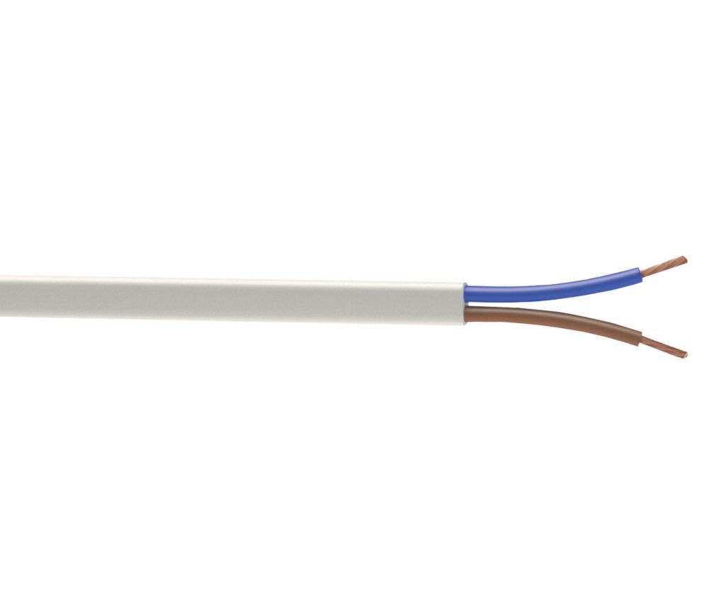

I've just bought a couple of Nest Protect wired smoke alarms, but mistakenly thought that they would be powered by an accompanying power adapter. It turns out they need to be hardwired to the mains.
Is there any reason that I couldn't connect a 3-pin plug and flex to it instead? (with a 3 amp fuse)
(and if so, what is the smallest flex size that would be acceptable - I want to avoid having a fat cable running along the wall to it).

I decided to mount the connections in a MF enclosure, with as short a length of non-DI cable exposed as possible.
I know this doesn't help with the..
I want to avoid having a fat cable running along the wall to it.
But for connecting with a flex, I would think about running the flex and making the cable joint in mini-trunking to maintain some double-insulation.
Alternatively, the nest could be mounted over a back box, and the connections made in there?
