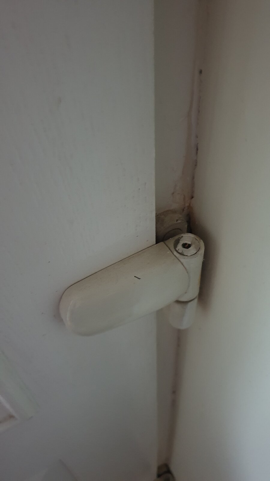

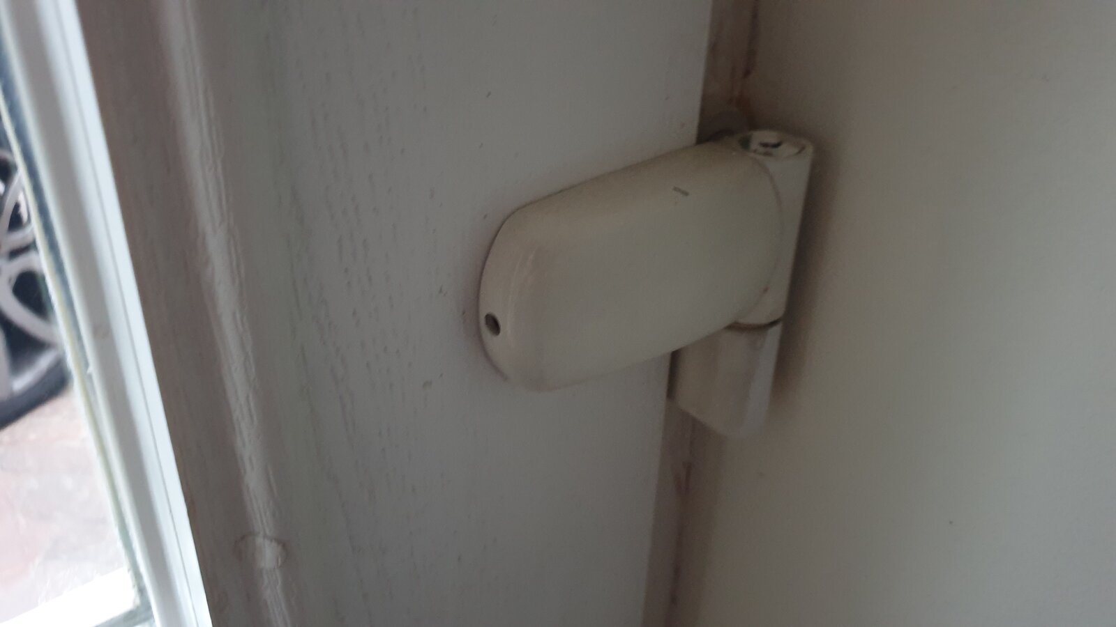

I’m fitting a new vinyl laminate floor in my hall. Can’t do much about the finished floor level but the door could do with being raised a bit. No more than 3 or 4 mm. I have three hinges like this - can they be adjusted?
Yes, the white dome cover is held by a screw which is visible with the door wide open.
Once off you'll see all adjustment screws.
Spend a bit of time working out what does what and move all hinges up by exactly same turns.
However, 3 or 4 mm could put the seals in the wrong position, so mind that.

Couldn’t see any screws on those holes so I tried screwing in those caps with the 5mm Allen key in them - there were three of them. That had the desired effect and it raised the door just a couple of mm until it was no longer brushing the flooring. Seals were not affected. Going to need to cut a mat well into the floor if I wast a mat just inside the door - even the thinnest of mats wouldn’t pass under that door!
To lift the door on its hinges look UNDER each hinge, you will see an allen bolt similar to the top one in both your pictures, turning the bolt just pushes the hinge pin upwards thus lifting the door, turning the plug in your pictures just throws the door in/out/left/right with a repeated 360° rotation, it doesn't do up/down
