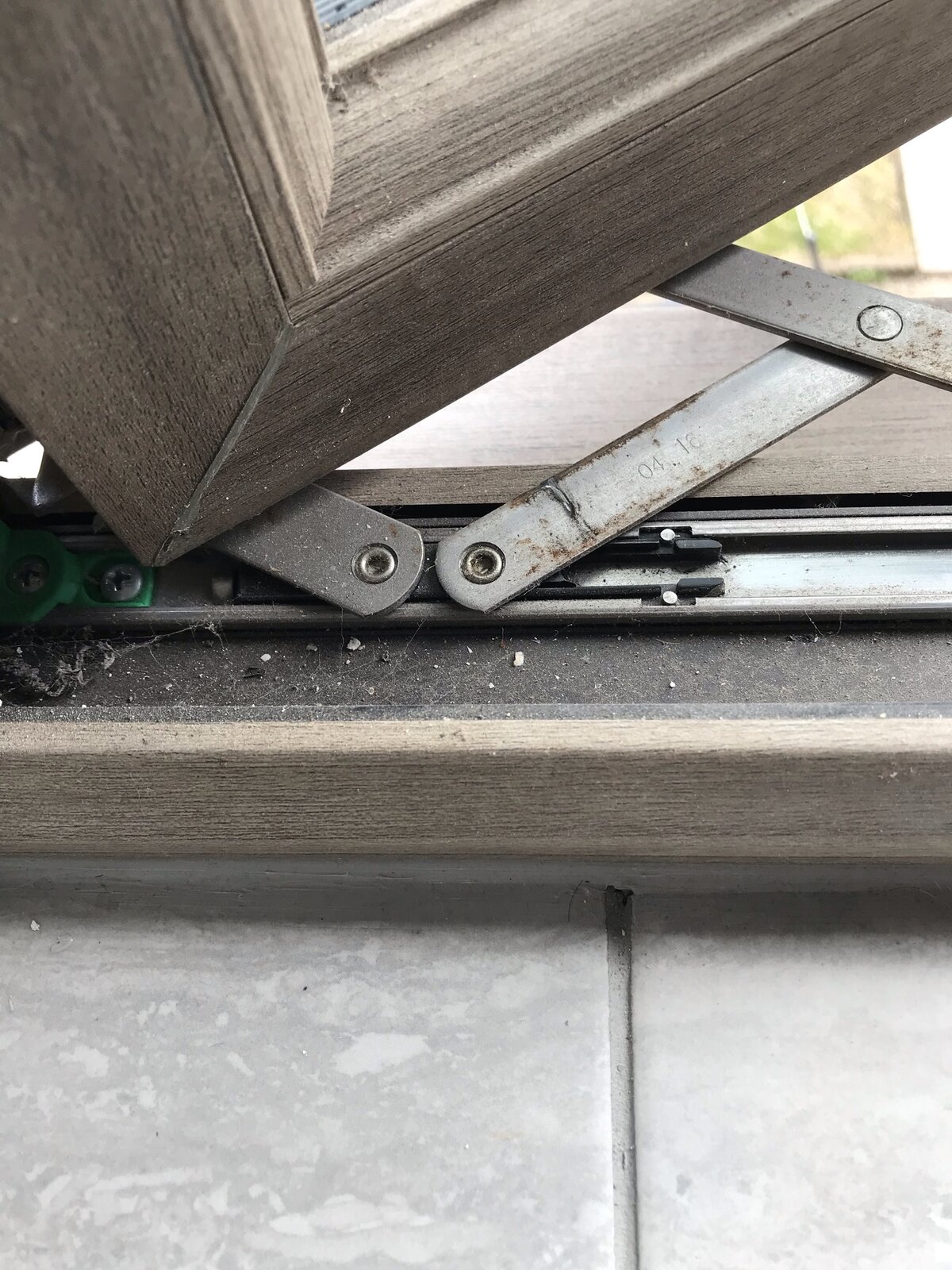

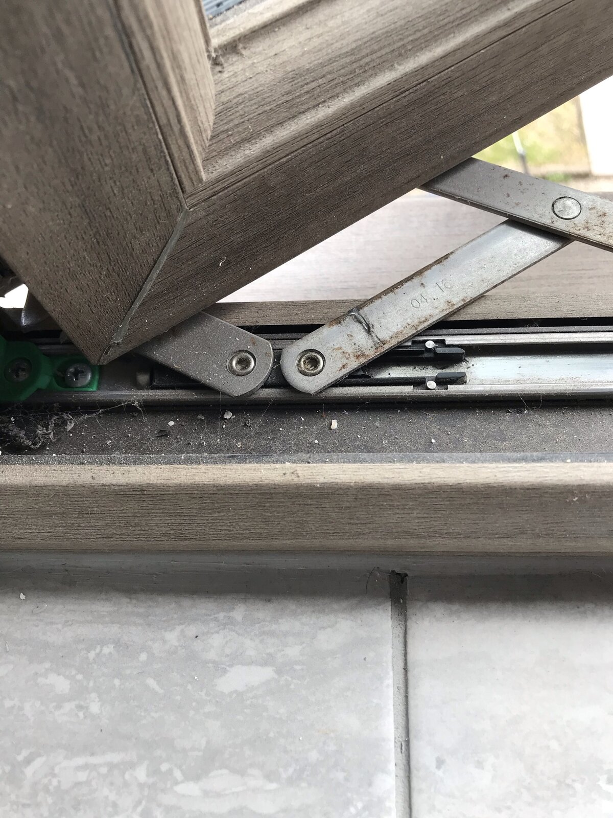

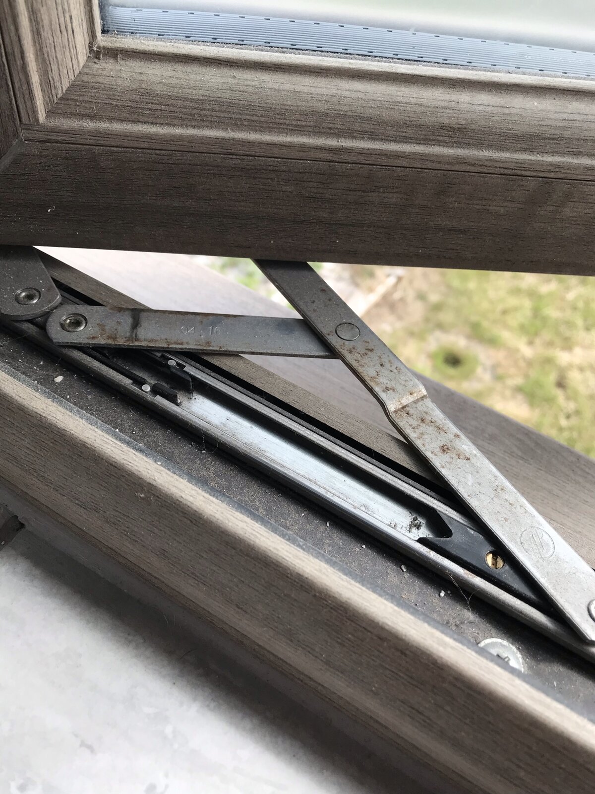

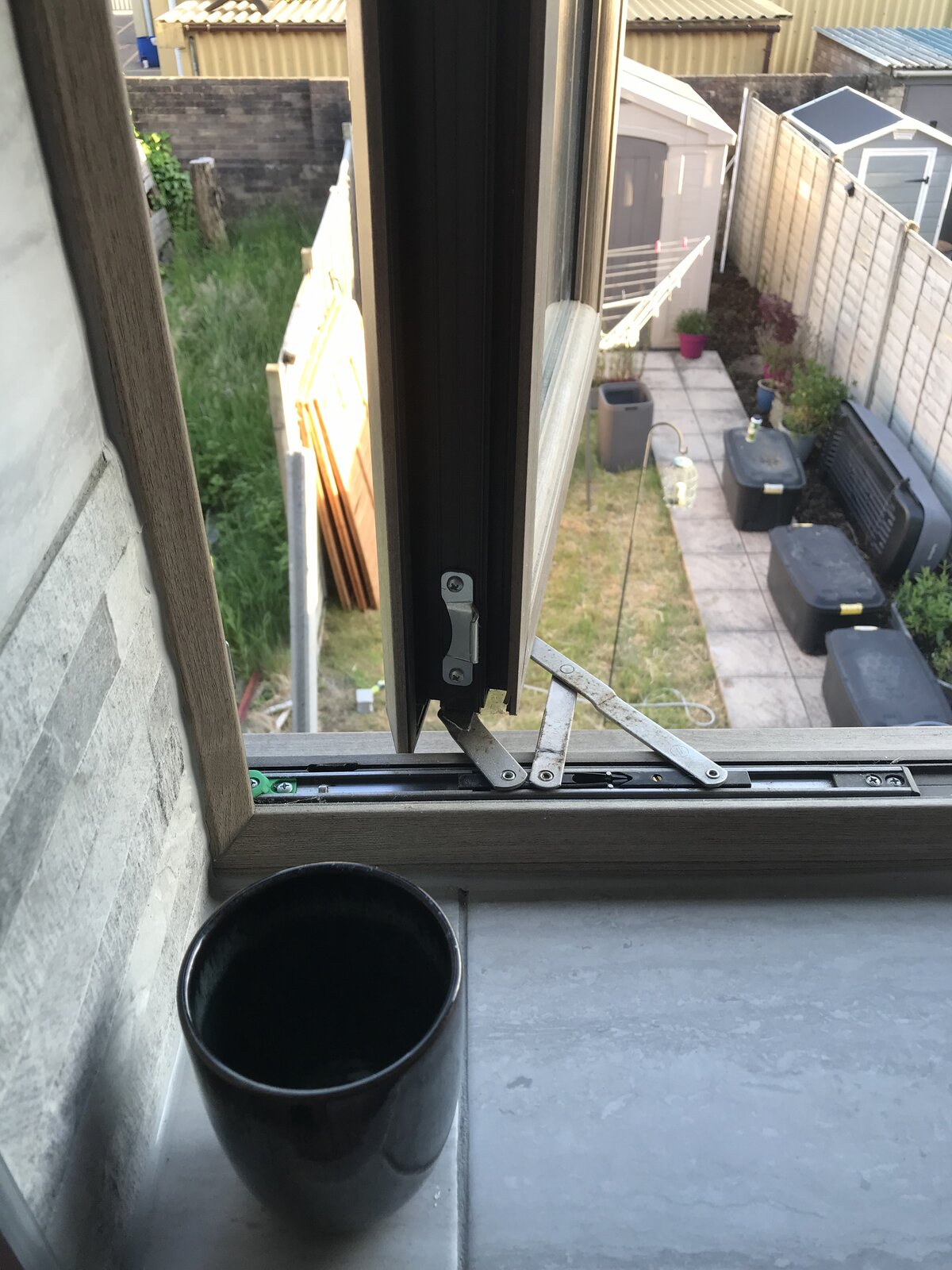

Can this open for cleaning?
11 Jul 2015
205
6AFDC129-72CC-43D3-BD41-6AAEC4CA8561.jpeg F7E3683B-F888-4577-B8BE-3540B88C56C8.jpeg

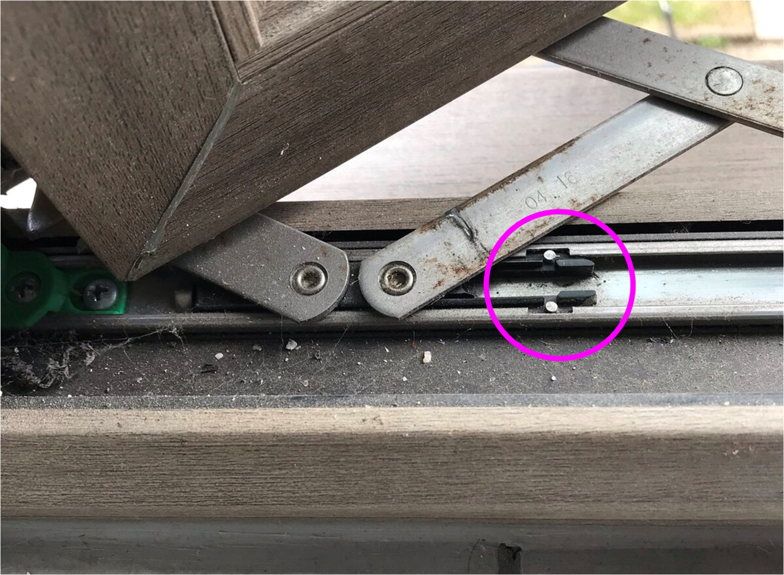

Have you tried pressing this down into the channel?
It may be that the little pegs will then ride under the lip of the channel allowing a greater opening angle and for the whole thing to slide along to gve access to the outside of the glass.
Watch your fingers.
A bit of WD40 the day before might be a good idea.

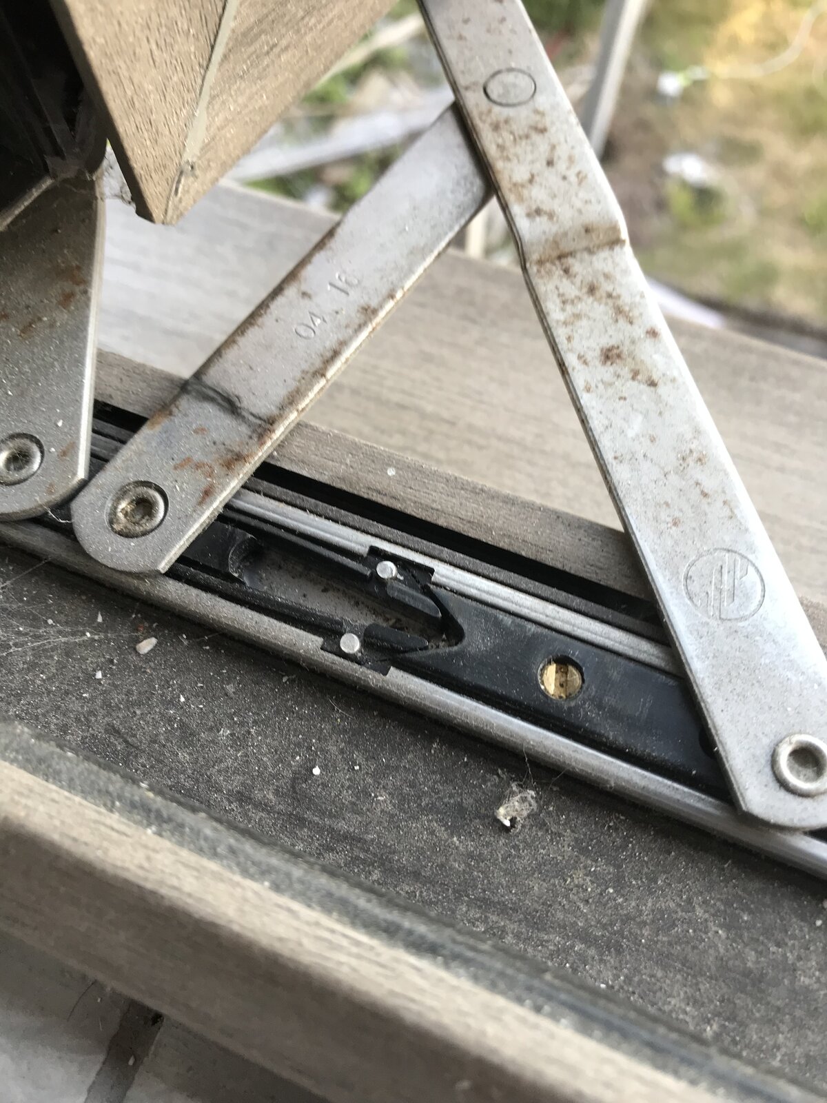

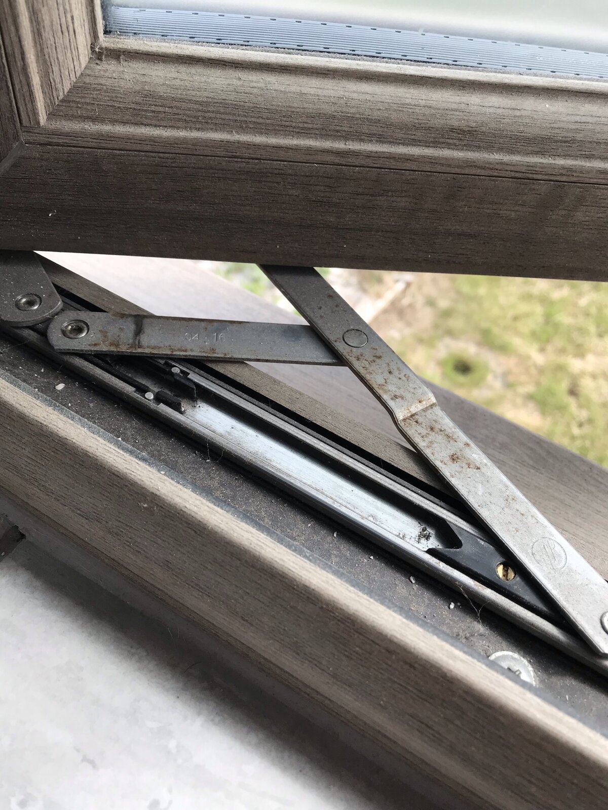

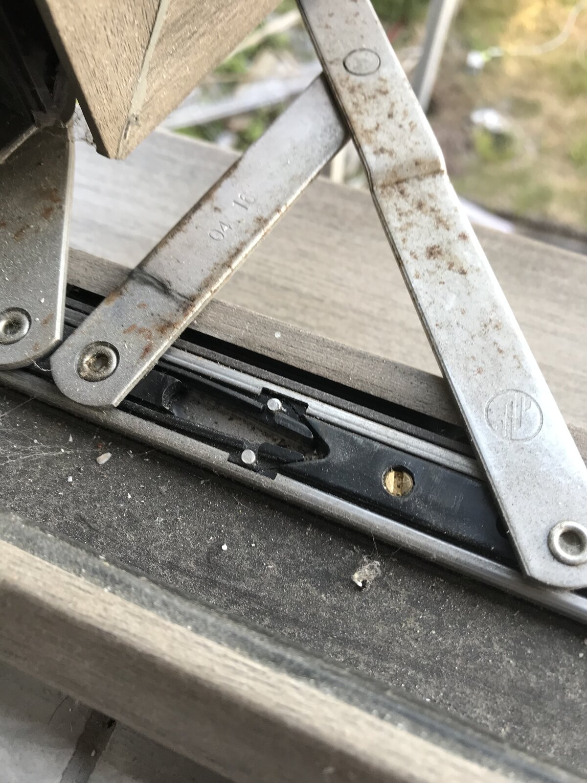

No movement that I could feel. Was thinking of squeezing the right hand ends together. Will take another look.

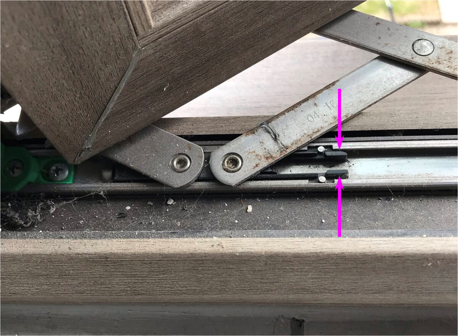

Ah - yes - squeezing here so that those little pegs run inside the lip could be it.
Open fully and when the black sliding guide with the V notch meets and compresses the 2 bits you've arrowed you can then slide the whole lot over

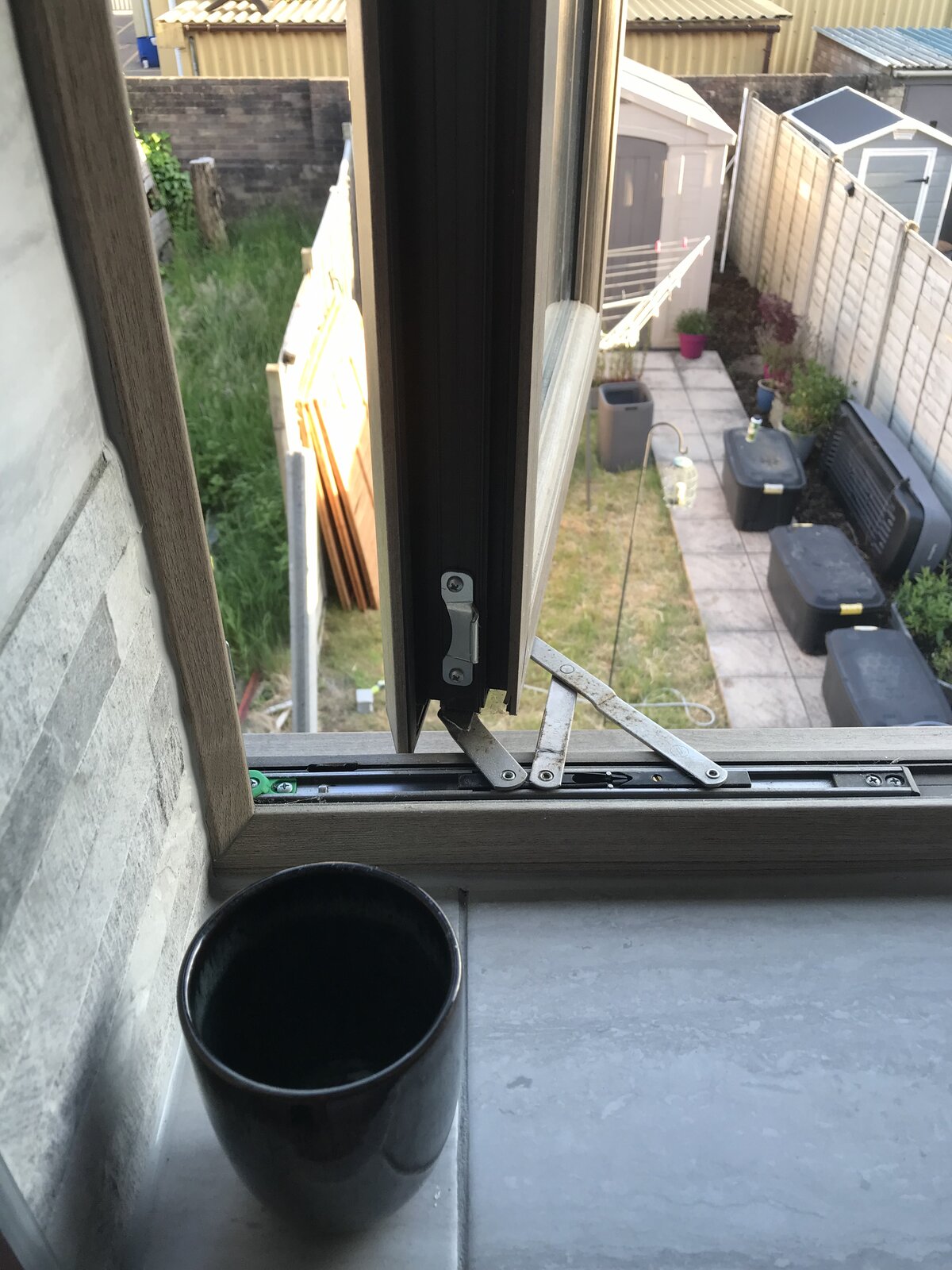

Opened it fully
This compressed the plastic
Solved
Thanks All
