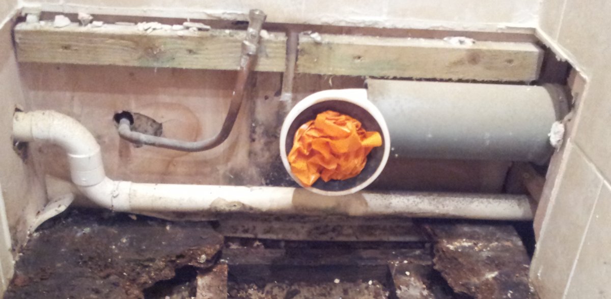

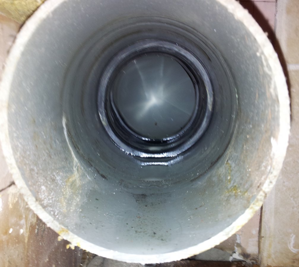

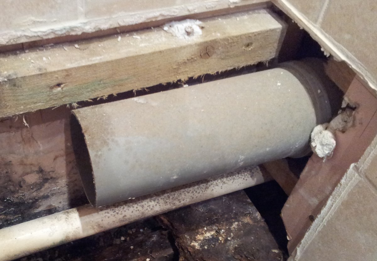

Hi I've basically ripped everything out now as the floor was sodden and rotting.
See below for pics.
I want to change the soil pipe. The white soil pipe fits in the grey one through a rubber seal - the leak appeared to be coming from here. I took the white soil pipe out but when I tried to put it back I appeared to have push the seal down the grey soil pipe. Any idea how I replace the seal in the grey soil pipe? Or use an alternative seal?

is it me or does that soil pipe look like its running up a bit ??????
