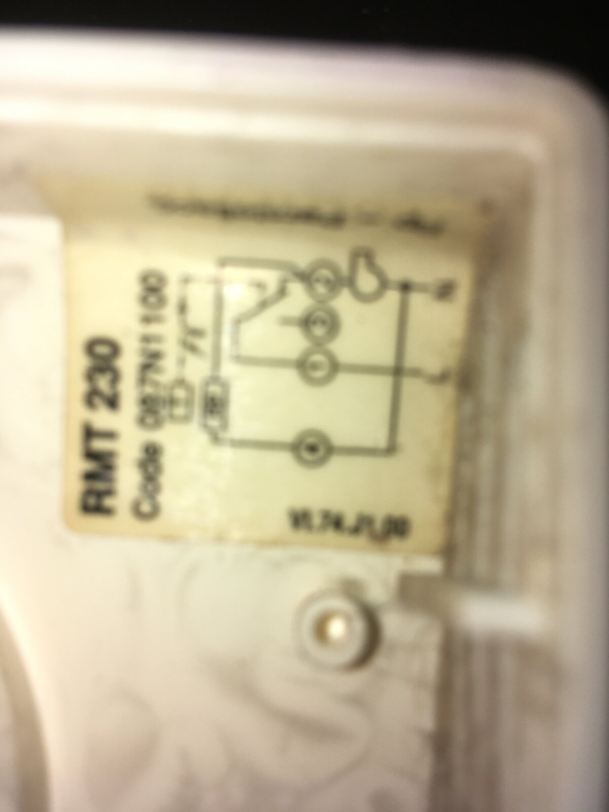

The room stat is a Danfoss RMT24 and it does click when you rotate the dial. I can't get the cover off, there are no screws to remove.
Is it likely the room thermostat is at fault?

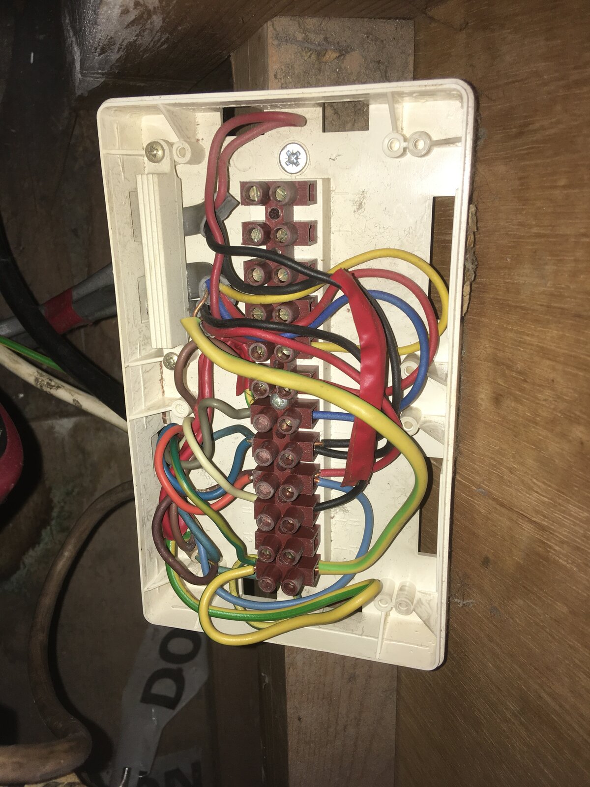

Could be a number of things ,testing voltages present at the wiring centre would establish which.

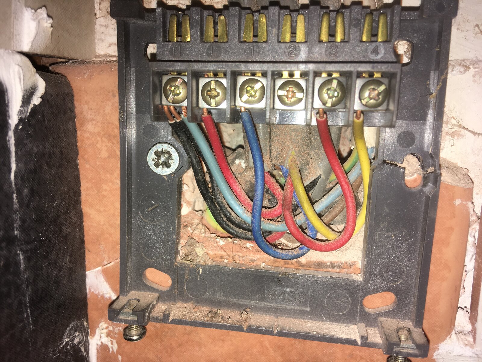

I have found out the programmer wall plate is Danfoss MK18. there is no wire connected to terminal 2 (CH Off)
The room thermostat might not be RMT 24, it just looks like it!
Doesn't require a wire to be connected to " central heating off" terminal, the programmer just kills voltage to c/heating " on "terminal ,when c/heating is not required.

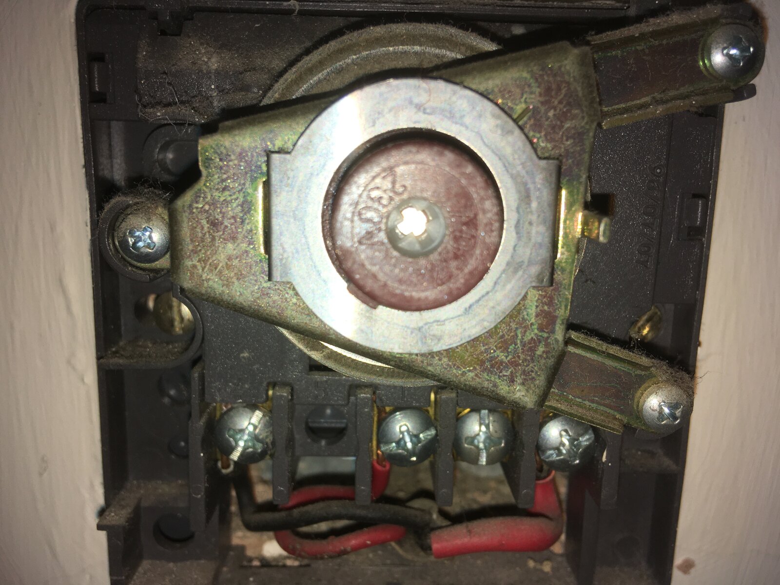

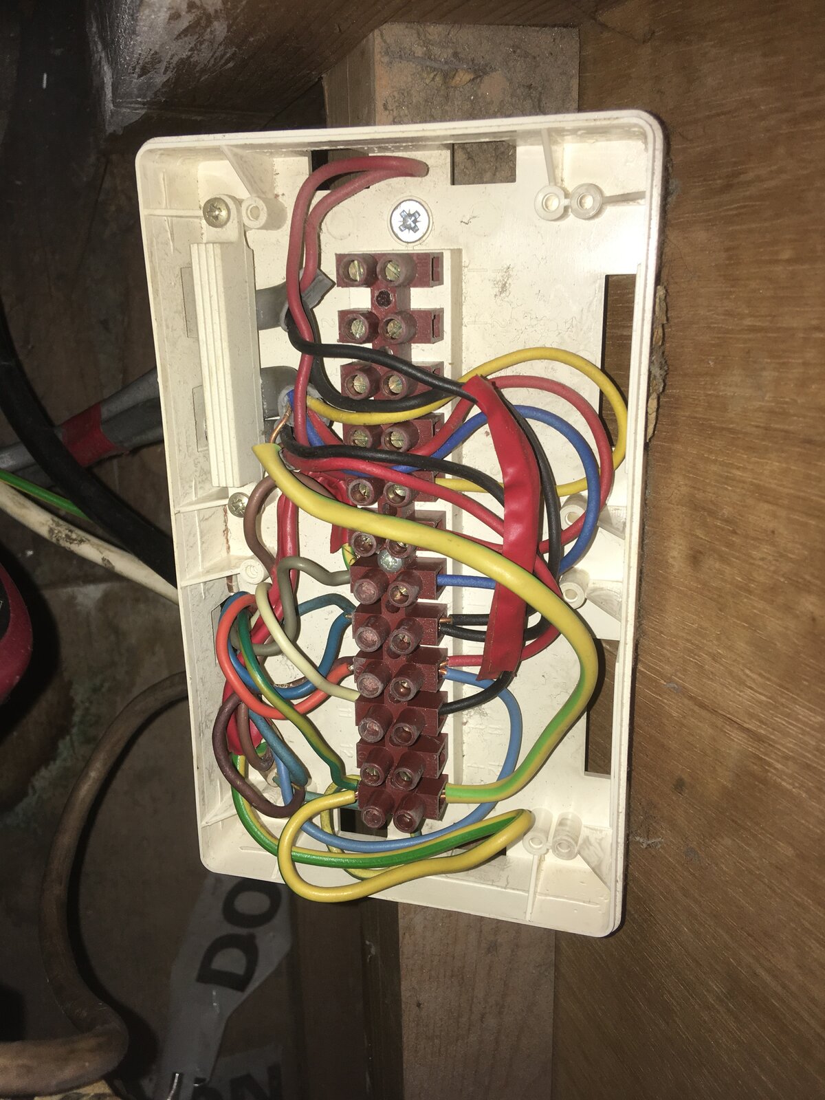

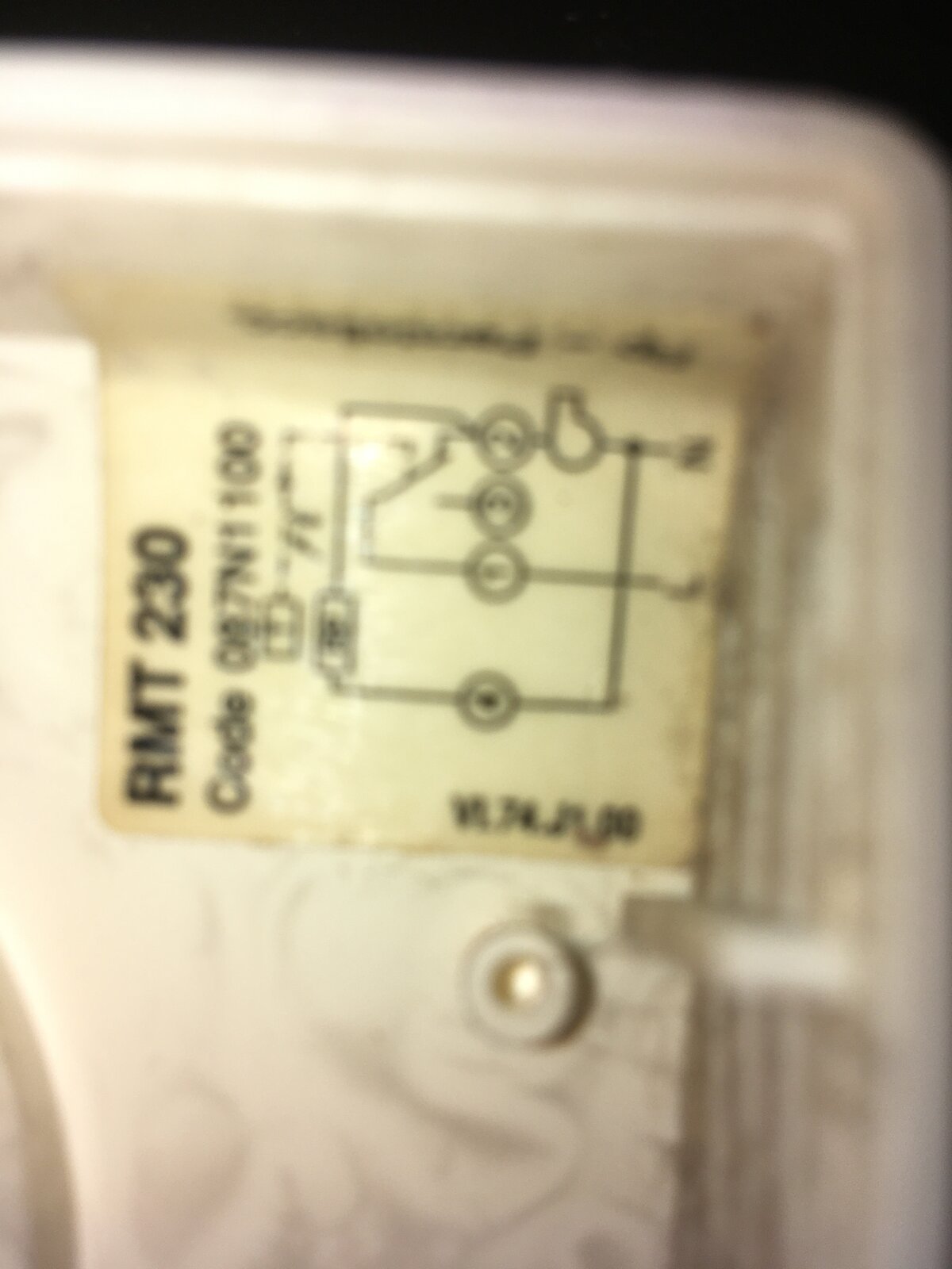

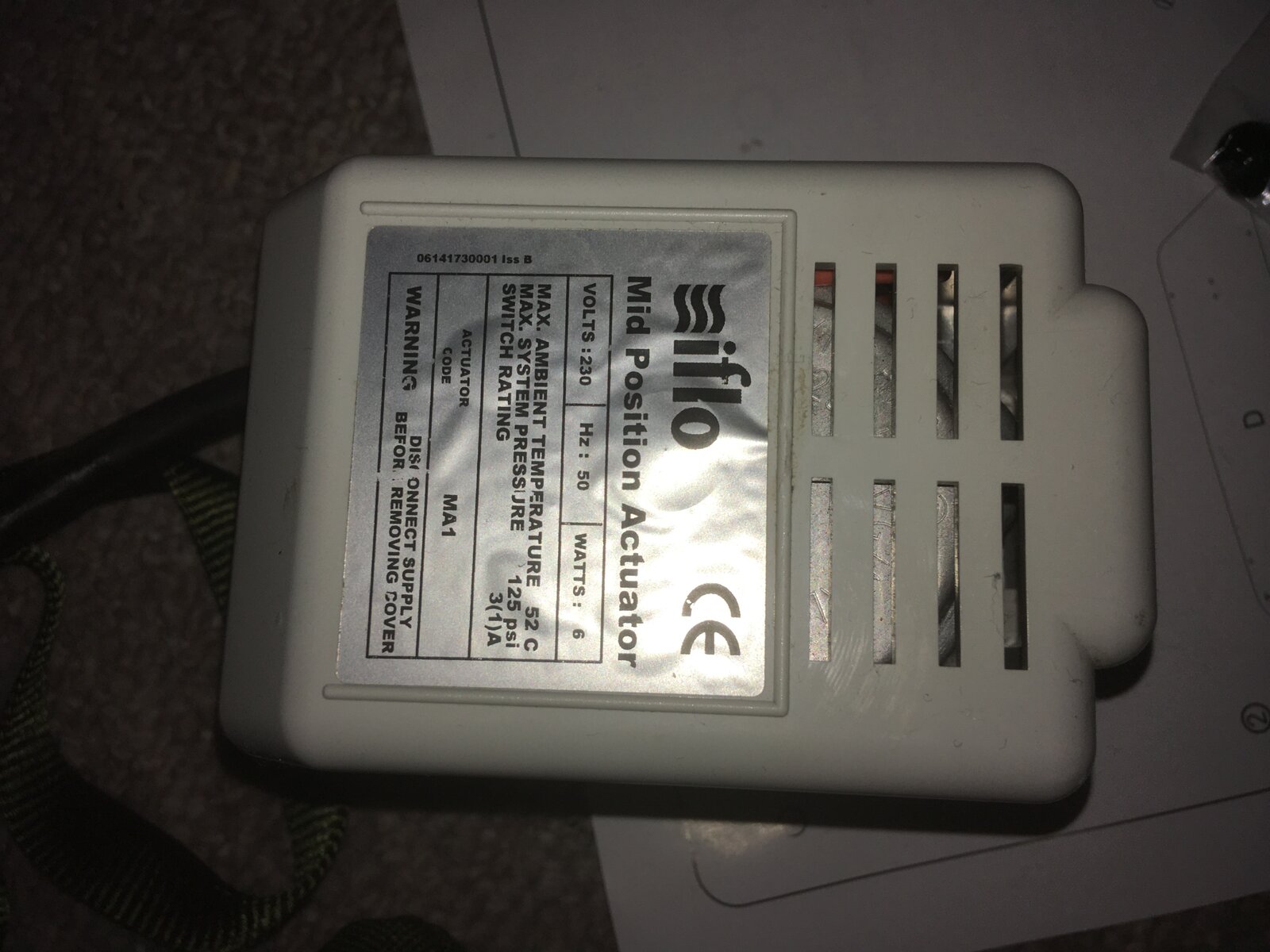

Hello,
Pictures as requested.
The broken wallplate for the programmer has been replaced but wiring is identical.

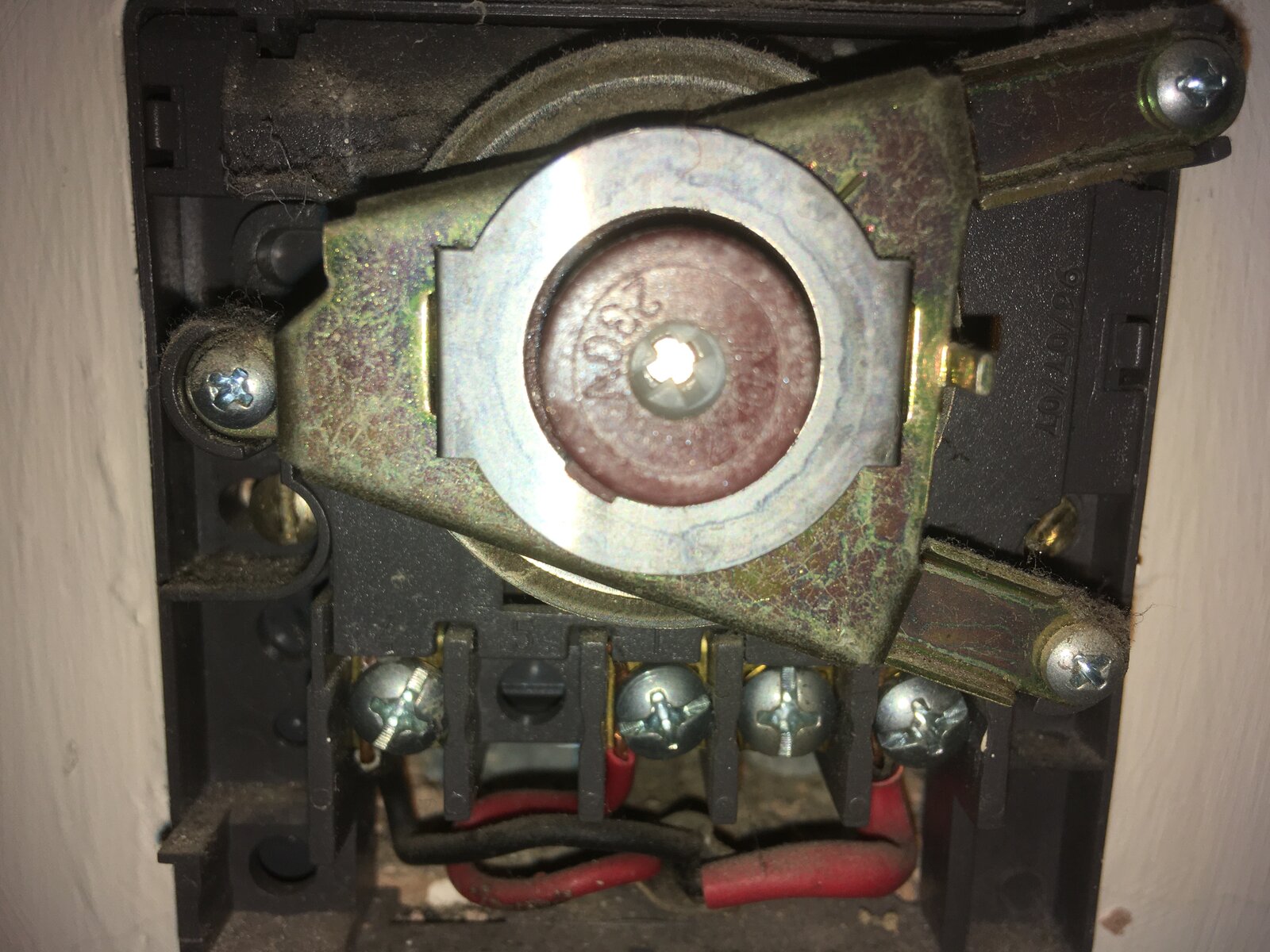

I have tested the stat with a multimeter and when it calls for heat there is 240v on the switched live.

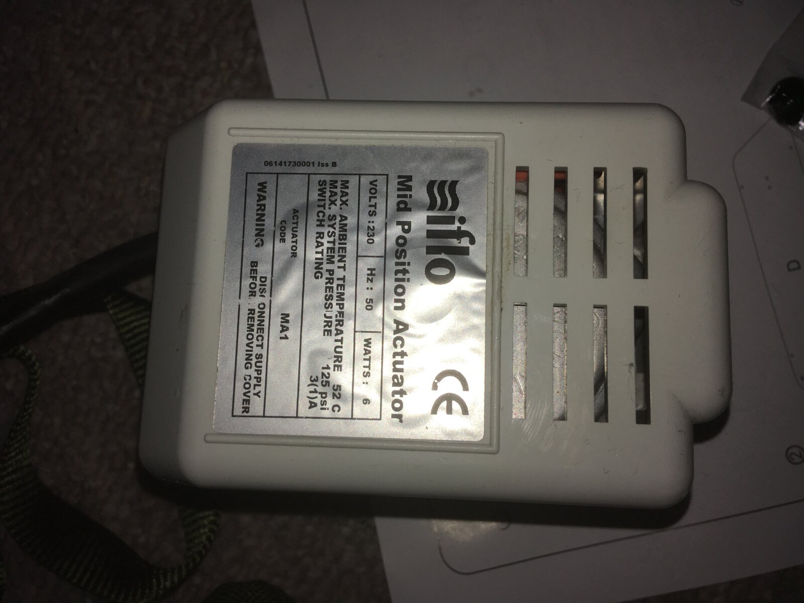

At the control centre, when the wall stat calls for heat there is no voltage on the 3way valve orange wire. The actuator doesn't do anything in any circumstance.
The 3 way valve only moves about 1/8th of a turn is it seized? or is this normal
The central heating pump starts and stops from the cylinder thermostat, when the programmer requests hot water.
Not much difference in price between just actuator and complete valve. Buy complete valve and you can't go wrong really.
