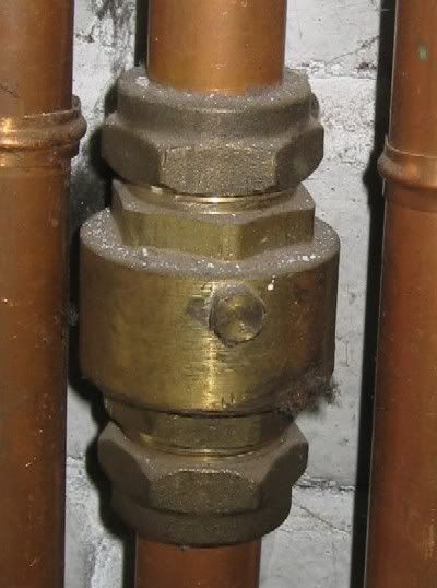

has the system got gravity check valve near the pump ?
will be stuck open.

How big is the check valve
approx 2" long
Sorry i have had a good look above and below the boiler as pipe from the pump is routed behind the boiler but no sign of the valve.

So there are only 2 pipes connected to the boiler ? . To have a gravity circuit for domestic hot water there would be 4 pipes- 2 for grav. circuit and 2 for pumped heating ;)

you could have a point.
as all the ones i've know to jam have been fitted horizontal.
