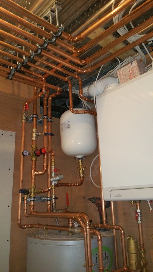

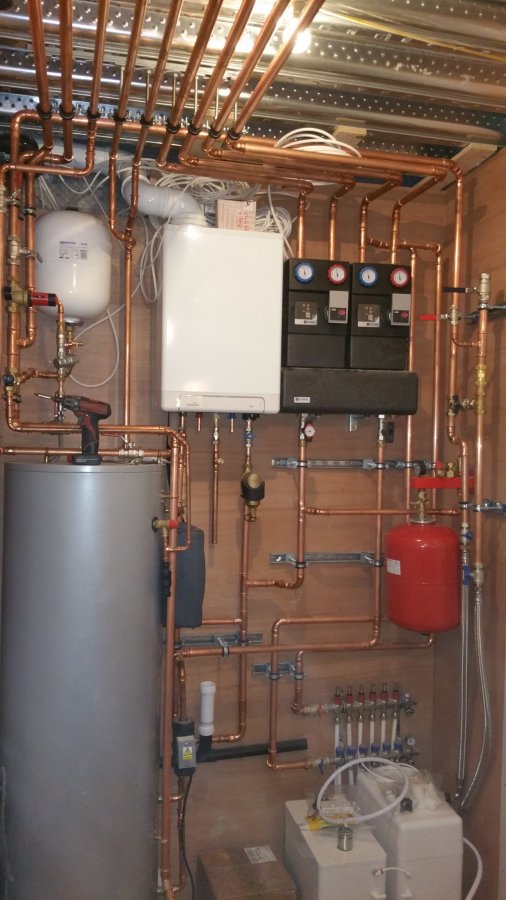

Been talking about it a lot recently on here as it is my pet project for the summer, but we're doing an installation at the moment where the builder was convinced he wanted 40kW in the house (his own place). When the calcs were done, 15kW was the heat load at design temps. So this lot is in the process of being installed (ignore the wires - they're the Spark's). A boiler that can only do 24kW (although a few tweaks will get me 28 if I want it ;) ). Even then, that is at his insistence - I wanted to put an 18kW unit in.
This is why I mentioned earlier, that you need to get the foundation information correct before tearing headlong in preconceived design ideas. This might well cost you a few hundred up front, but is likely to save you thousands in the future.
Remember also, that systems are sized for worst case scenario, which in the SOuth East only happens a couple of weeks a year. The rest of the time, the system is grossly over sized and therefore runs sub optimally.
Got to admit Dan, loving the crimp fittings, what brand do you use? How do you find getting to joints in tight spaces - against walls etc?
Nice clean pipes, no green shyte and saves the hot works permit bother!
Either mappress or xpress. You have to plan carefully as it's easy to plumb yourself into a corner, but using Unistrut gives you more options too.
Love the stuff.
Will the tool work for both brands?
Or do you need one for each?
Which tool do you use? Not cheap are they :eek:
I have a 2 series and 3 series Novopress. Works with a M profile brands of which there are a couple. Stainless steel too with is great for external gas runs where the p|keies will have copper off the wall as quick as you can hang it. :LOL:
