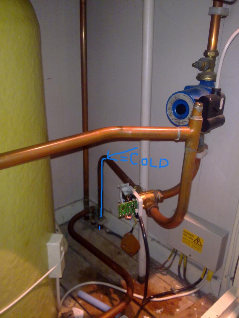

This is a picture of the piping around the pump:-
The pump is this one - a BG Multihead II
I can undo the big black screw in the middle, but it doesn't seem to come all the way out. Not sure what to do to try and free it up.

The black screw is to enable you to free the impeller by unscrewing it, pulling it out a little to engage with the impeller and then turning it either way. However, before you do this I would suggest, after looking at your photo, that you check that there is water in the small expansion vessel in the loft.
Ok, checked the expansion tank and there is water in there. I pulled the black screw out and then turned it each way a few times. It turned fairly easily.
I've just noticed though, that one of the pipes coming from the 3-way valve is cold after the 90 degree bend - the one going to the radiators. I've marked it on this picture:-
I'm wondering now if the valve is jammed up. I've taken the cover off the motor and tried to move it manually (with electrics off of course!), and the lever doesn't seem to lock into any position - it just hangs loosely.
Is it possible to remove the motor mechanism from the valve altogether or would this cause a leak?

I've managed to take apart most of the head, just leaving the valve sticking through. If I try and turn this with a pair of pliers - it barely moves, maybe an eighth of a turn in total.
It does seem then that the actual valve has seized, therefore I would suggest a complete new valve replacement.

Thanks for all the advice everyone. Fitted a new mid position valve this morning, and everything is now nice and warm!!
