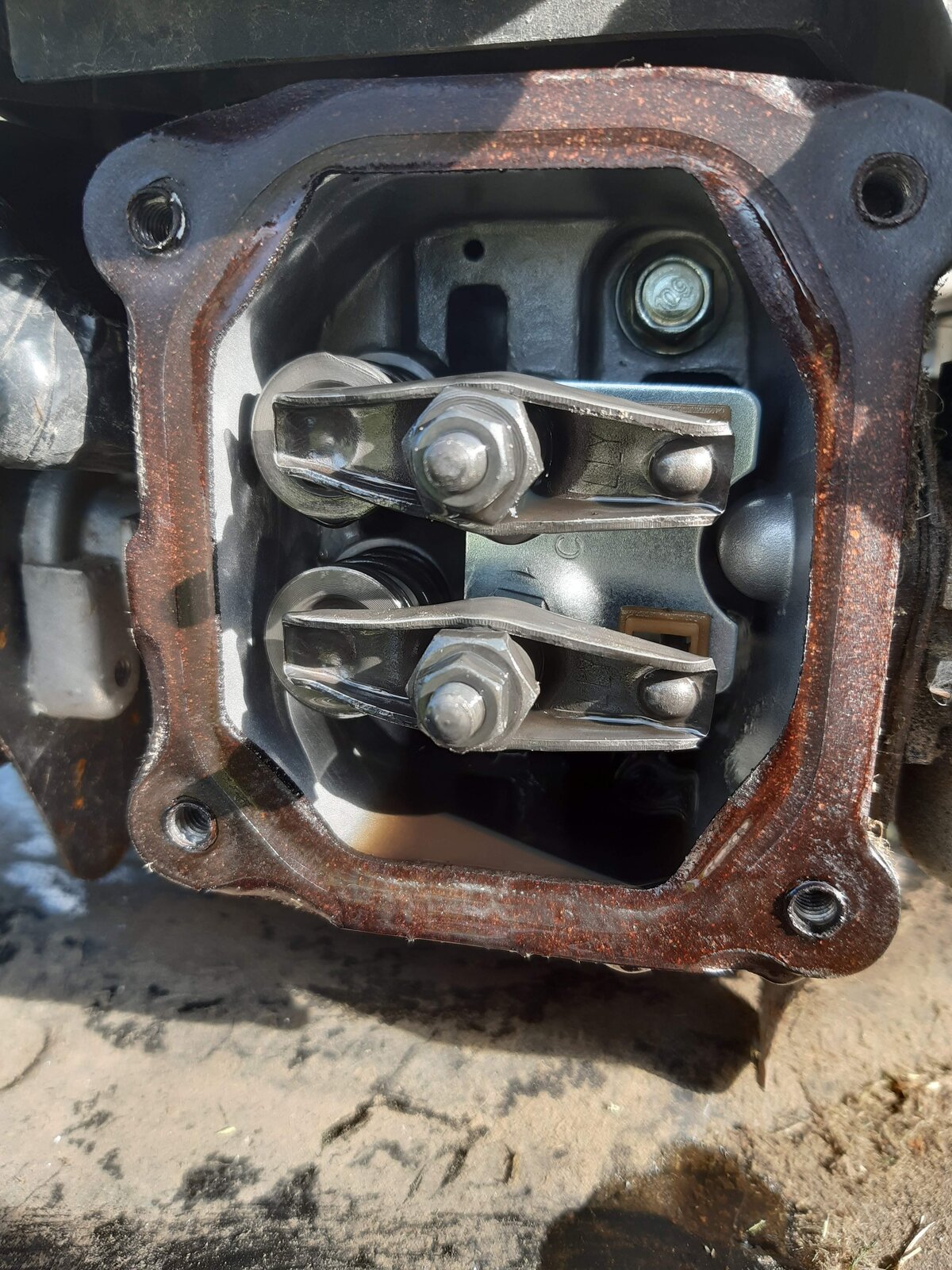

attached a photo of the valves. what I am supposed to look at. both plates going across have clearance. shall I tightened the blot of untightened
sorry for got yo attach the photo, here it is
Turn the engine slowly by hand, in the direction it's supposed to spin and you'll see the valves opening and closing.
When each valve closes, the rocker should come slack.....that's the arm between the push rod and the valve top.
Ideally use a 5 thou feeler gauge between the rocker and the valve when the valve is fully shut - the gauge should just slide in. If you don't possess a feeler then you should just be able to detect some clearance between the two.
If you're happy with this then pop the cover back on.
John :)

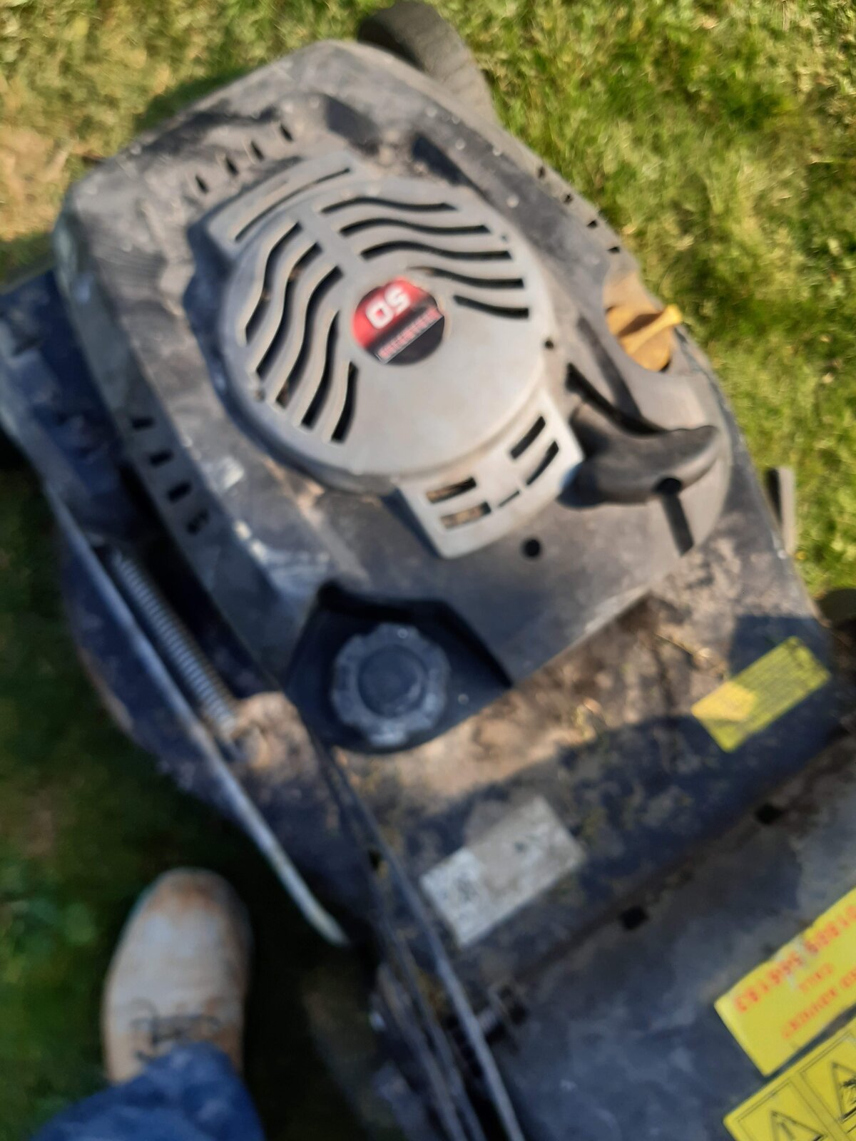

I really don't like the sound of this engine.....you don't have the choke on there, do you?
It sounds like it is chuffing air when it shouldn't....is anything slack on the motor?
