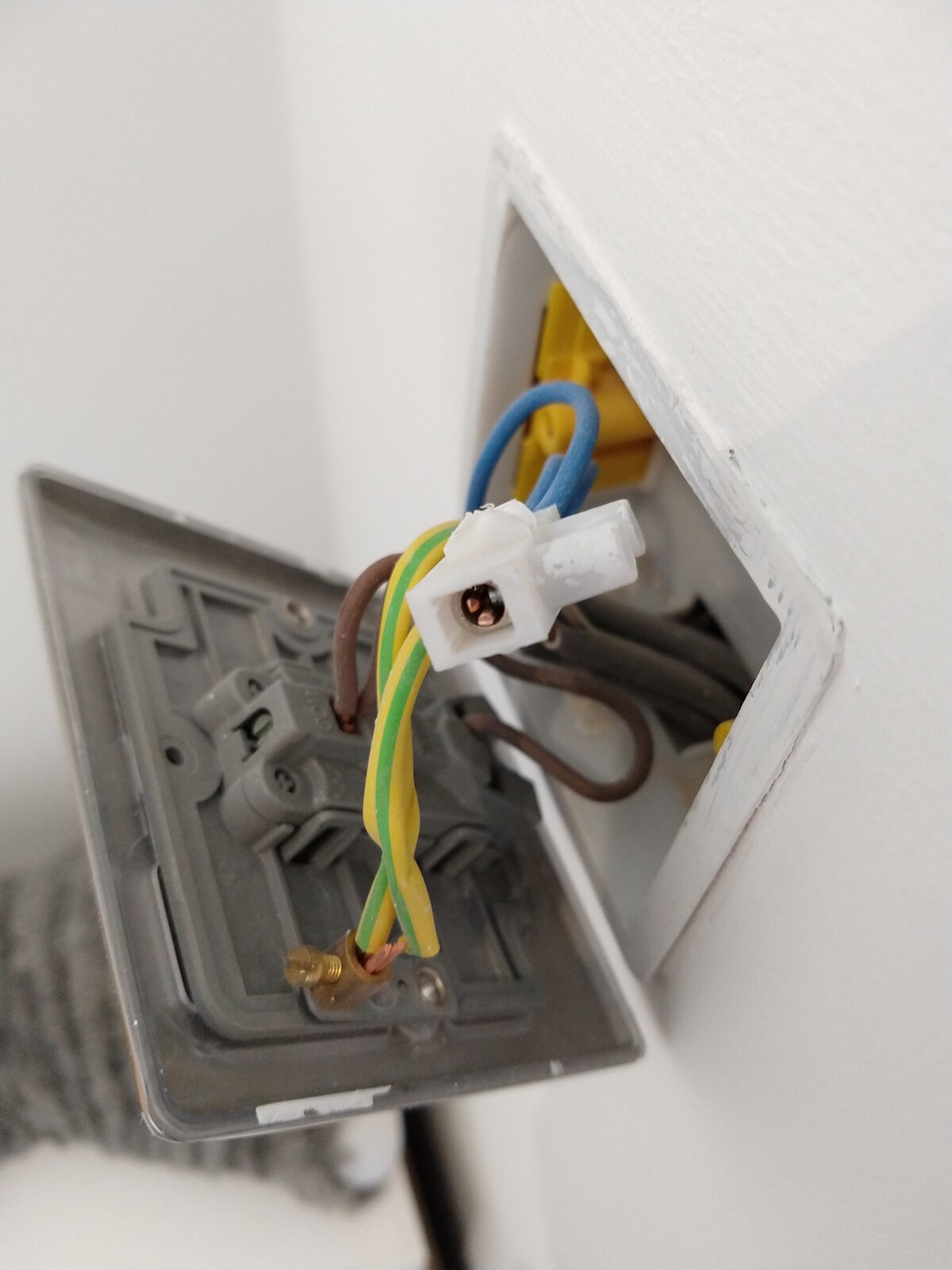

I am in a 7-year-old property. I want to convert a single light switch that currently controls a single outside wall light into a double, in order to switch an external 12v cctv camera.
The exterior wall is clad and the current light switch is on the internal wall directly behind the existing exterior light.
The camera will be positioned just above the exterior light so only a short run of cable will be required and providing there is not a snag, should be easy enough to do.
As the cctv camera's power supply is in the 3 prong plug, I will be enclosing a socket within an IP56 external junction box with the supply cable running from the internal double wall switch.
In the current single switch: 2 browns to com, 1 brown to L1, 2 blues to terminal block, 2 earths to metal switch.
I am thinking I have to loop the incoming live (brown) from (com) 1st switch to the 2nd switch then connect all blues (one from the cctv) together, then all earths together, then brown out from the 2nd switch to the (live) cctv.
I have 2 questions:
1. Am i correct in assuming that the above method is acceptable?
2. How do I wire the new double plug and cable?

Yes it is acceptable, but mark the socket as "6amp, camera only". To warn someone that they should not plug a kettle in to the plug.. Note, there will probably be a post from the local idiot who says this is not allowed, but that is on his head. It is specifically allowed by wiring regulations.
Not sure what you mean about number 2. You did not mention a double plug in your post and, Im not sure that I have ever come across such a thing?
I would say in your case blue is neutral and brown is line. I always worry about water outside, so would use a double pole switch, so water on neutral tripping a RCD can be isolated should that happen.

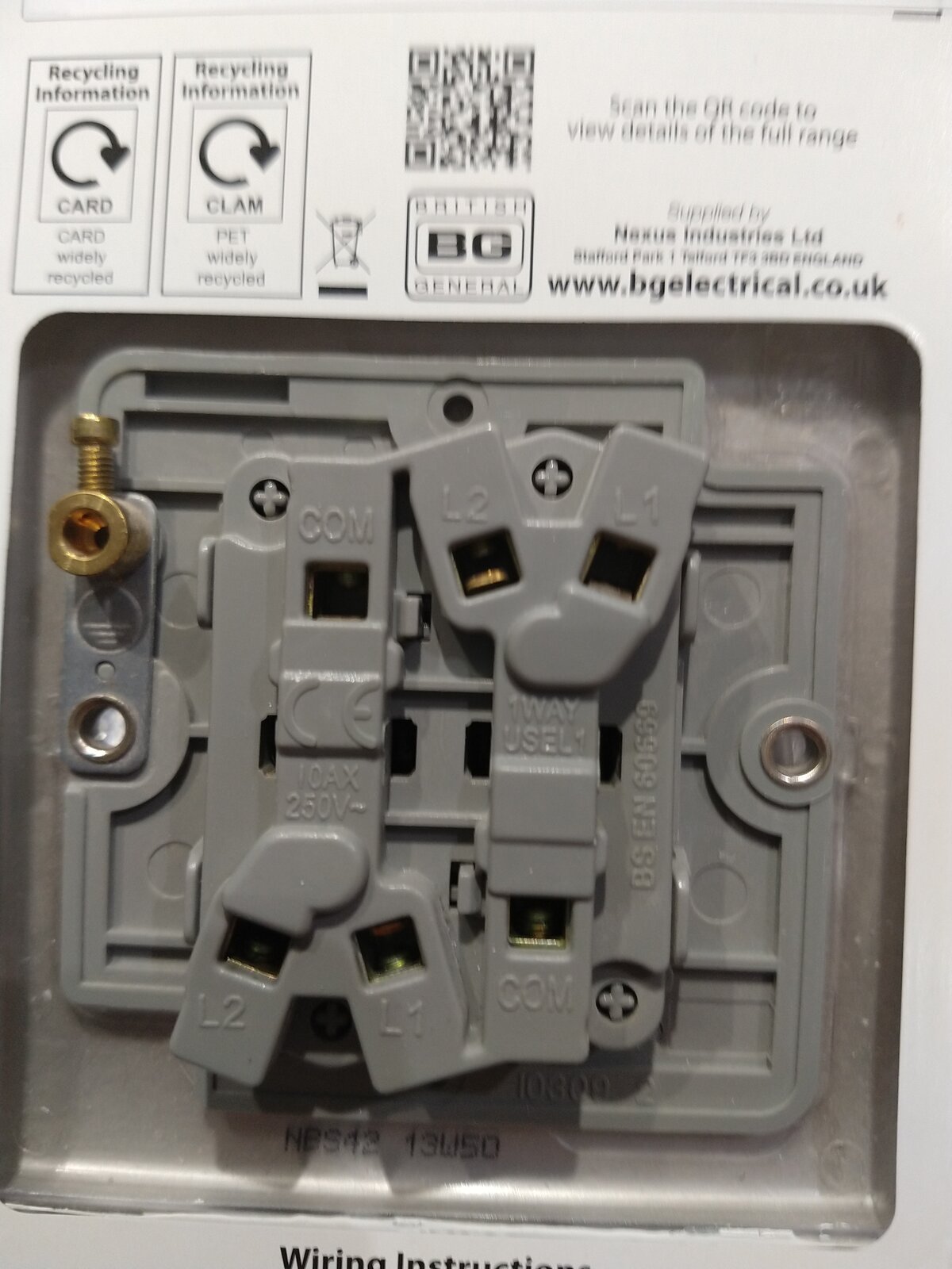

I have attached a photo of the double light switch I will be using. To ensure I don't wire incorrectly could you please advise which wires ie from the existing single (to be replaced) light switch and wires to the double socket for the camera should connect to which terminals in that double light switch? The photo of the wiring in the existing single light switch is shown in my first post.
I was going to use a double switchless 13 amp socket purely because of the 3 prong cctv camera plug. Switchless because I won't need to switch it off and on, as this will be controlled from the interior double light switch. I was intending to use a double socket just in case I will connect a 2nd camera in the future.
(That "double light switch" will be [actually] a pair of "Wall Switches", switching both Light and Power.)
Incoming Line (Brown) wire (which should be on the existing COM terminal) to one COM (common) terminal of the pair of Wall Switches - with
a Brown "jumper wire" from that terminal to the COM terminal on the other wall switch of the pair.
(Doing this will provide Line Voltage for both switches.)
Outgoing (Light) Switched Line (Brown) wire (which should be on the existing L1 terminal of the existing switch) to the L1 terminal of the "Light" Wall Switch - whichever one that you choose.
(However, the existing set-up would work if the existing Brown wires were reversed - so,
first check that the Brown wire in the existing COM terminal IS the Line wire - by using an appropriate Voltage scale on a multi-meter, with the existing switch OFF, before you disconnect power.)
New "Power" Switched Line (Brown) wire to L1 of the (other) "Power" Wall Switch.
New "Power" Neutral (Blue) wire joined to the two existing Blue wires in the existing connector.
New "Power" (bare) Earth wire - sleeved with Green/Yellow tubing and - joined to the two existing Earth wires at the Earth terminal on the new Face Plate.

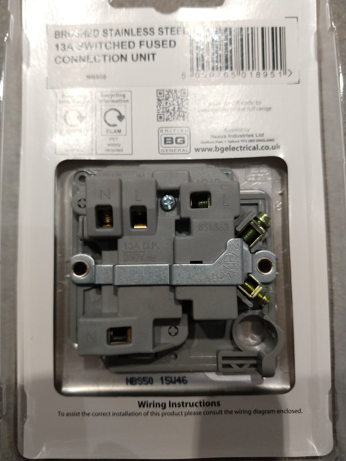

I have a spare FCU switch which I could put a 3amp or 5 amp fuse in. Would that be a better option than using a double light switch? If so I would appreciate hand holding again on which wires to which contacts. My current wired light switch can be seen in my first post.
