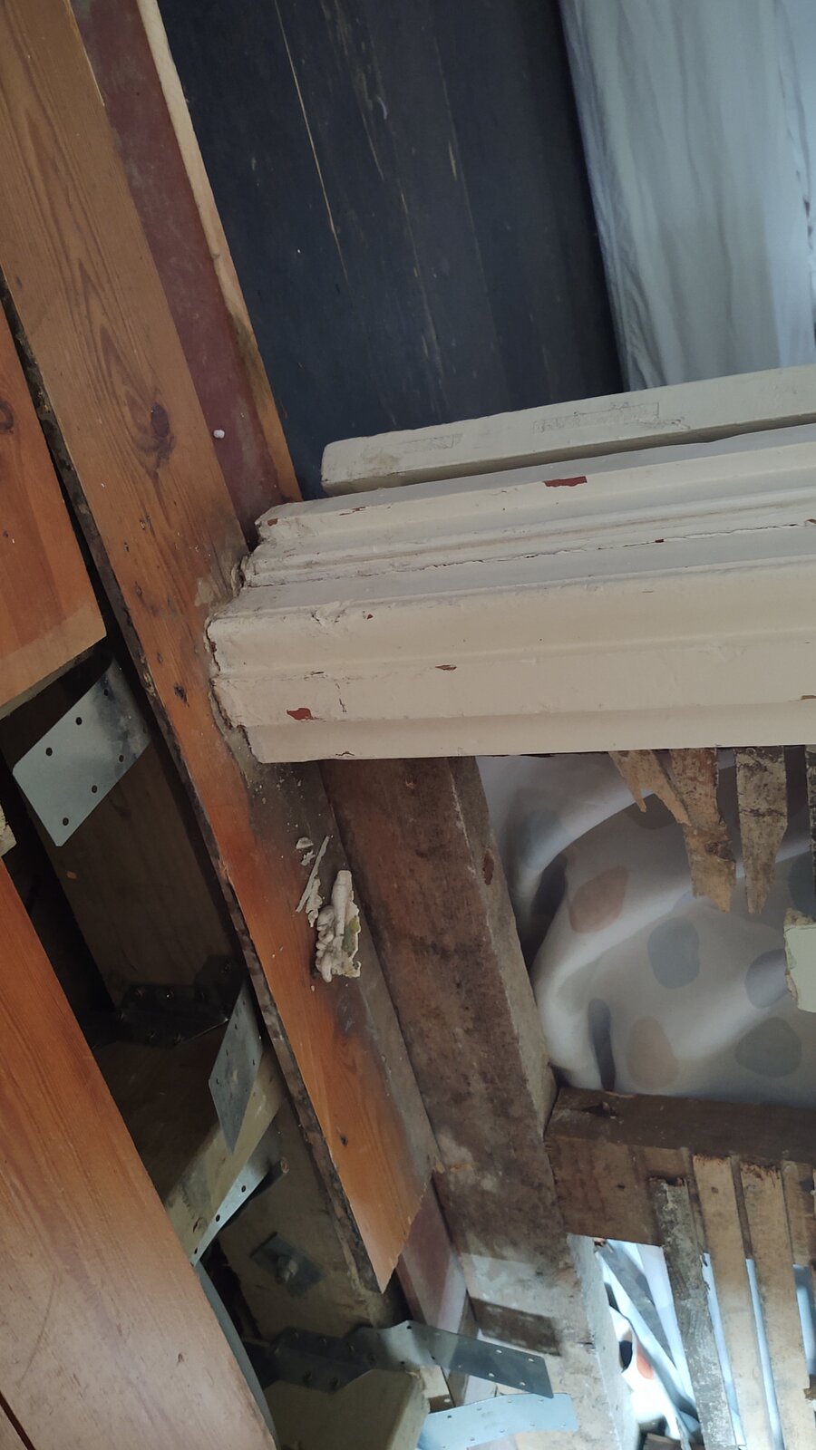

I replaced my floorboards in the bedroom and am about to start replacing the boards on the landing and second bedroom adjacent to it. The floorboard under the doorframe seems to be attached to it. When I try to slide it out sideways the doorframe moves with it. So I am unsure how to extract the floorboard to replace it. Any advice would be appreciated.

Maybe run a hand saw flat on the floorboard and cut across the bottom of the door frame
It's prob just pinching, but there could be a nail in it.
Or split the floorboard with a chisel so you have the width of the door frame left, then drill a few holes in the floor board under the door frame, until the floor board is in 2 bits and pull them out

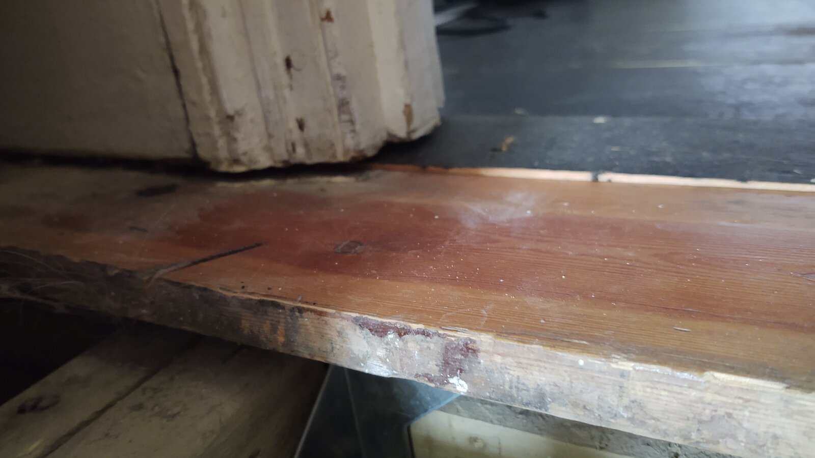

I think there might be a nail in it. The other side of the doorframe looks much less tight but still, the doorframe moves when I yank the floorboard. I'll try to split it
