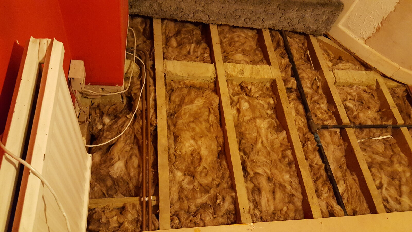

Are you using ply for the floor? I'd lean towards adding mineral wool in the floor void and the wall studs to muffle noise a bit. and two layers of plasterboard on the wall. Do all the wiring you can think of before closing up.

Yes, I plan to use mineral wool but ply wasn't in my plans. What would be the benefit of laying ply under the boards? the downside is restricted access to the heating pipes if I ever need to change something or repair a leak. It is just the two of us living here so noise isn't a problem for us
I meant, ply as flooring, rather than under boards. You will need struts ("noggins") under any unsupported joins
If you use screws, you will be able to lift it in sections non-destructively by lifting the stairwell side first and pulling it from under the wall skirtting.
here's an example of mineral wool as noise and heat insulation. It blocks draughts very well as it stuffs into irregular gaps without precise cutting. Cables can be on top or underneath, but not surrounded.
