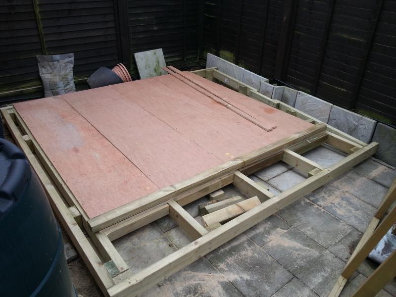

Firstly then - the bearers. These were build when I intended to deck. They are 4x2 treated timber held of the ground with some legs. I then used 18mm external ply over these to form the floor of the shed. I may well put in a DPM and another floor on top, but for now I'm sticking with this approach. I have to keep reminding myself that its 'just' a playhouse and not to go overboard on insulation etc!

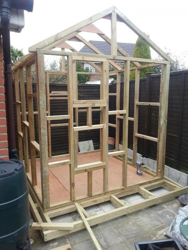

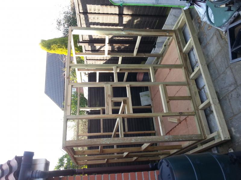

The next step was to start building the frame. I've done this using 3x2 treated timber, with 3x3 posts for the corners. There will be 4 windows - two in the front, one in the back and one in the side. The frame sits on the ply floor, but I've not screwed it down yet. The plan it to use 19x38mm timber around the bottom flush with the bearers and then deck up to the base to neatly finish the surround.
After lots of reading about bird mouth cuts, I bought a rafter square and went to work on more 3x2. The result looks pretty good I think. The windows will be cut from 5mm Makrolon that I got from a local sign maker! Apparently its used to make riot shields so should be strong enough - its also UV stabilised so should last.
Thats where I'm up to at the moment.... I'm taking delivery of 200m of loglap in the next few days. I'm using 12mm OSB for the roof (recommended by the local timber place that I got the ply from - I was going to buy more ply from him!), and have bought some IKO Super Shed Felt to go over that. I've put two rows of battens between the rafters to give something a little better than the OSB to nail into. I've got 6x1 to make the door - covering a frame with loglap put vertically so it blends in nicely.
