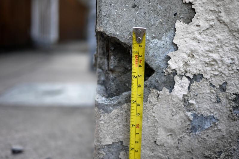

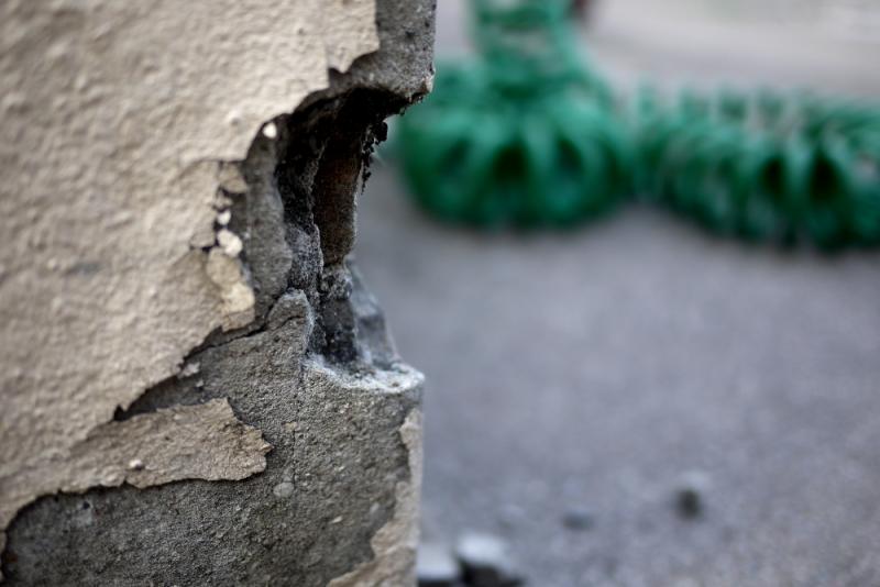

Chunk taken out of exterior wall - how to repair it?
The missing chunk has exposed rendering that appears to have lost its backing.
Whatever hit the corner has sent cracks shooting out.
The Tyrolean render application was applied amateurishly, and has not taken.
The paint is the wrong kind of paint.
To merely fill the missing chunk you could get a small bag of sand & cement from a plumbing or builders supplies.
Mix with a little water and dub out by applying in two coats.
Wait for the first coat to dry.
As a temporary measure you could fill the cracks with silicone or similar - research all the above on here.
dann09,
Thanks for the reply. We have found lots of evidence of "creative" DIY from the previous owner of the house, so it doesn't surprise me that the render & paint are not up to scratch. I will give the sand/cement a go, and plan on repainting ASAP.
Thanks,
M

As Dann. says, cheapest is a small bag of ready-mixed sand/cement.
Get some PVA glue (the white stuff) and mix it with some water 1:10, and brush on the repair area before applying the mix.
Also, use this solution as the mixing water for the sand/cement. It will last far longer, with less chance of coming away.

Thanks for putting me out of my misery! :D Sand/cement and PVA glue on the shopping list, cheers.
