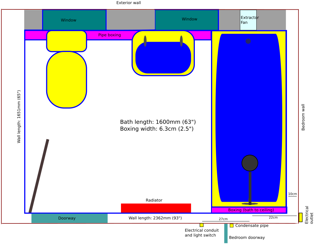

Some more stupid questions.
I'm thinking about different ideas for a bathroom remodel and I want to swap the taps to the other end of the bath and mount them and the shower on the wall. My idea is to box in the area from the top of the bath to the ceiling to put the plumbing in, because the existing wall isn't hollow. I'd also like to move the condensate drain from the boiler into this boxing, as it currently runs through a pipe on the wall behind the bedroom door.
Would 6cm or so be enough clearance to mount the taps etc. there in the first place? If not I would have to change to having a 1500mm bath instead of the 1600mm, unless I can find one in an in-between size. The current one is 1575mm but so far the only ones I've found in that length are the L-shaped shower baths, which I don't think will work unless we move the radiator.
My husband is worried that my boxing idea would put the plumbing too close to the electrical stuff on the other side of the walls. There is some surface mounted conduit and a light switch on the wall in the hallway, and a wall-mounted outlet near the floor in the bedroom on the other. I made a quick scaled drawing to show my idea. The distance between the approximate place where the plumbing would go and the conduit is 22cm, and to the outlet is 27cm. The existing wall between the bath and the outlet is approximately 10cm thick.
Is this whole idea totally stupid or pointlessly complicated? Does the location of the existing drain and electrical stuff make this a non-starter? Or can you have the drain and the taps at opposite ends?

Are you moving the drain end of the bath? That could be a showstopper if you can't get adequate fall on the waste pipe.
The rest of it will work, though the condensate pipe will be a nuisance (it has to run in a straight line so your 60mm will be a bit tight for 32mm condensate plus insulated 15mm water pipes where they cross,
If the room behind the toilet wall is a bedroom, build your boxing frame attached to side walls & ceiling only and fill the void with acoustic wool, it'll reduce noise transfer. And use tile backing board rather than plasterboard ,(denser so again less noise transfer)
If there is a physical barrier put in between the electrical and water services then you shouldn't fall foul of any regs.
You may be awful tight trying to get wall mounted taps and outlets jammed into a 60mm space. Some come with mounting kits that sit inside the void but they need to be mounted onto a solid surface (wood/brick, etc), and that's usually the wall at the back.
What I would say though is that the taps and shower would normally go at the drain end of the bath, being the end you would stand in. It has a straight end n it and is typically the stronger end. The other end of the bath usually has a greater slope to lie against making it a little less easy to stand in, unless you fit a double ended bath of course.

No, certainly not essential and it's not regulation but from a HSE point of view and occupational health etc then they frown upon it being at the more slippery end of a single ended bath for obvious reasons. Ultimately if you are happy with the increased risk of slipping then it's up to you and will allow the bath waste etc to stay where it is.
No reason not to drop the condensate into the space tool along with the other pipework as long as there is room but where is the boiler and where does the condensate drain into?

You can get non slip coating's on baths but not sure how comfortable it would be to sit on. As suggested though, you can get a double ended bath, most do tend to have a centered waste but it shouldn't really be an issue to move the current waste by 600 odd mill.
Right, I made a somewhat modified drawing that shows approximately where the drain from the boiler goes. I'm sure it could be moved slightly so that it goes through the ceiling and behind my imaginary boxing and still have plenty of room to run straight.
So, if it's fairly trivial to change the location of the waste to the side for a double-ended bath, what's to stop you moving it all the way to the other end for a more conventional bath? Could you still mount the taps and the shower on the end where the boxing would go if you had the waste in the centre?
Of course, no reason not to turn the bath around, you'd just need to have it at it's max height to ensure you get a suitable fall on the waste run, if the outflow is through the wall at floor level at what would then be the opposite end.
