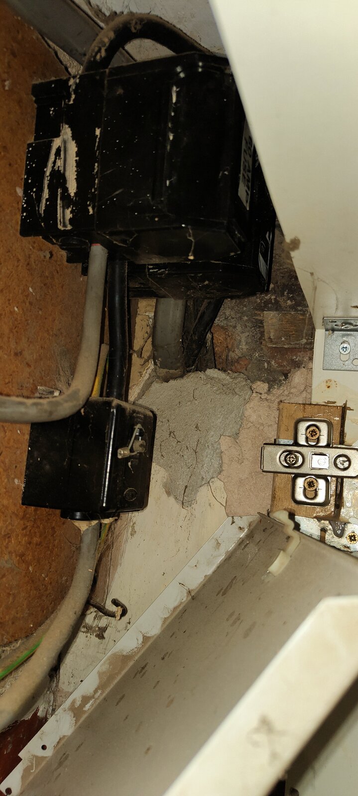

I'm wanting to get a smart meter. On first attempt, they couldn't fit it because some idiot built a cupboard frame in front of the service fuse holders, so they can't be removed.
Right now there's just over 3cm in front of the fuse. Does anyone know how much clearance I'm likely to need, as I'm debating the hassle of minor alterations to the cupboard framing Vs getting power distribution in to move it. I can take off 2cm pretty trivially without any visible effect outside the cupboard, giving 5cm clearance. Is that likely to be enough? For obvious reasons I've never seen the fuse out,.so I don't know how long it will be.
Picture attached - the framing at the top has 2cm before it meets external trim.

When the doors are open I have approx 4.5m of clearance in front of the meter board with the exception of the tiny corner bit of it where the fuses pop out, which annoyingly has this bit of framing in the way.
What I want to know is how far out does it need to go to physically pop out the fuse. If that was possible to do, the meter guy would have done the meter and we'd all be happy. Plus in the event of it needing taking out for other reasons, someone would be able to do it. Right now, in the event of an emergency requiring isolating the house, someone is going to have to pull the cupboards apart before they can pull it, which I am not happy with. If the fuse won't pop out without 25cm of clearance in front of it, then I have to do something visible externally. If it will pop out with 5 or 6cm in front of the fuse, then I can do internal modification only.
I could get the power distribution company in to move the fuse, but a) it will be more hassle, and b) there's a risk they'll want to mess everything up / decide the whole thing is no good and want it moving at great expense and little point, when it presumably met with whatever their regulations are before idiot kitchen man put the frame of the cupboard in the way.
The point is, that easy, safe access is needed to all of those items. Safe as in being able to stand, and reach out at arm's length and safely pull that fuse. Dodging around a cupboard, or timber framing, to work on any of that is neither safe, nor acceptable.
If the cupboard really must stay, then make it quickly and easily removable?
The distribution company will need to work live when moving the fuse, This means they will need clear access to the fuse. And you need to maintain that clear access for when the fuse has to be changed

What is in front of the service head? Could you post a photo?
