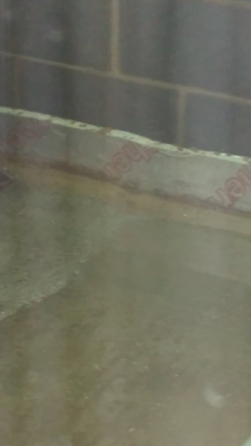

They stood on it and it cracked ,I suppose because the polystyrene insulation has hive in it ,it rained heavy the night they put it down.and new regs say you have to put selatex along the damp proof ,and I think water got down the sides of this to the underneath ,as concrete will not seal to the selatex insulation

The slab should not move once laid. The water will dry out but may leave a void. Small amounts of water will have no consequence to the slab. It won't matter a jot if the slab gets wet after it is laid. It will dry out once the roof is on.

The have put the damp proof membrane down and first layer of concrete then they have started breeze blocks half way up now .this is why it's getting filled with water
Can you reconfirm your first post that the water is pooling under the insulation. Has the DPM and insulation now been removed?
Hi yes the water was on top of the membrane when they broke the section of cracked concrete up ,we mopped the water up he then put new block of insulation down and re concreted that bit .but before he done that the water was seeping onto the membrane from the rest of the floor so I assumed water is still under their .he said it will get ducked in to the concrete and dry out .also the damp proof membrane is cut off at the height of the selatex round the edge ,should it be loose or fixed to the bricks .I've tried to show it in the pic .thankyou

OP it might take a while but the floor will dry out, Im just a bit confused as to why the slab cracked, you can normally walk on concrete the next day with no problems, is your builder a large gentleman lol
The foreman is ...so should it have been concrete as first fix.then when roof etc is on and windows they then put insulation down and concrete then the screed ...also does the screed need time to dry before wood or lamminate is put down .thanks for your help
