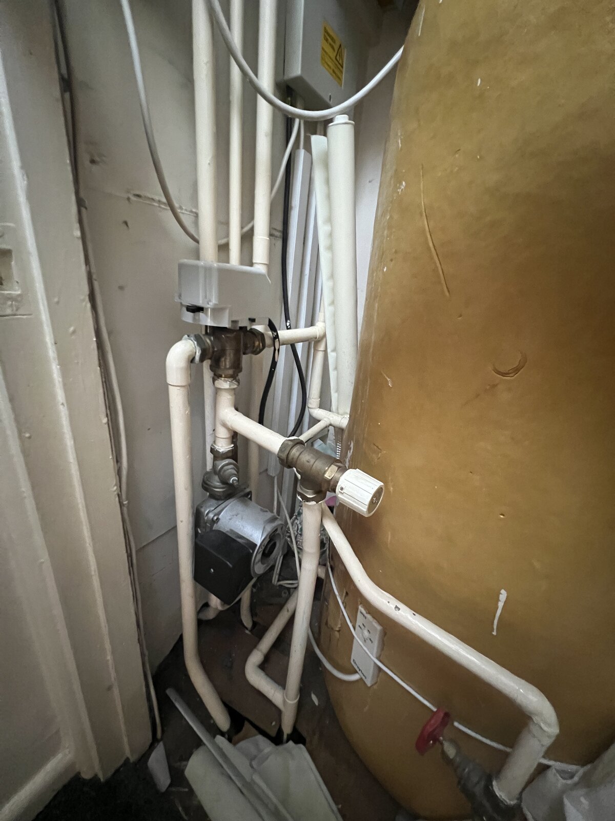

Is your boiler fed from a small tank in the loft ?
Show us some pics of hot water cylinder and pipework around it.
Is your pump running ?

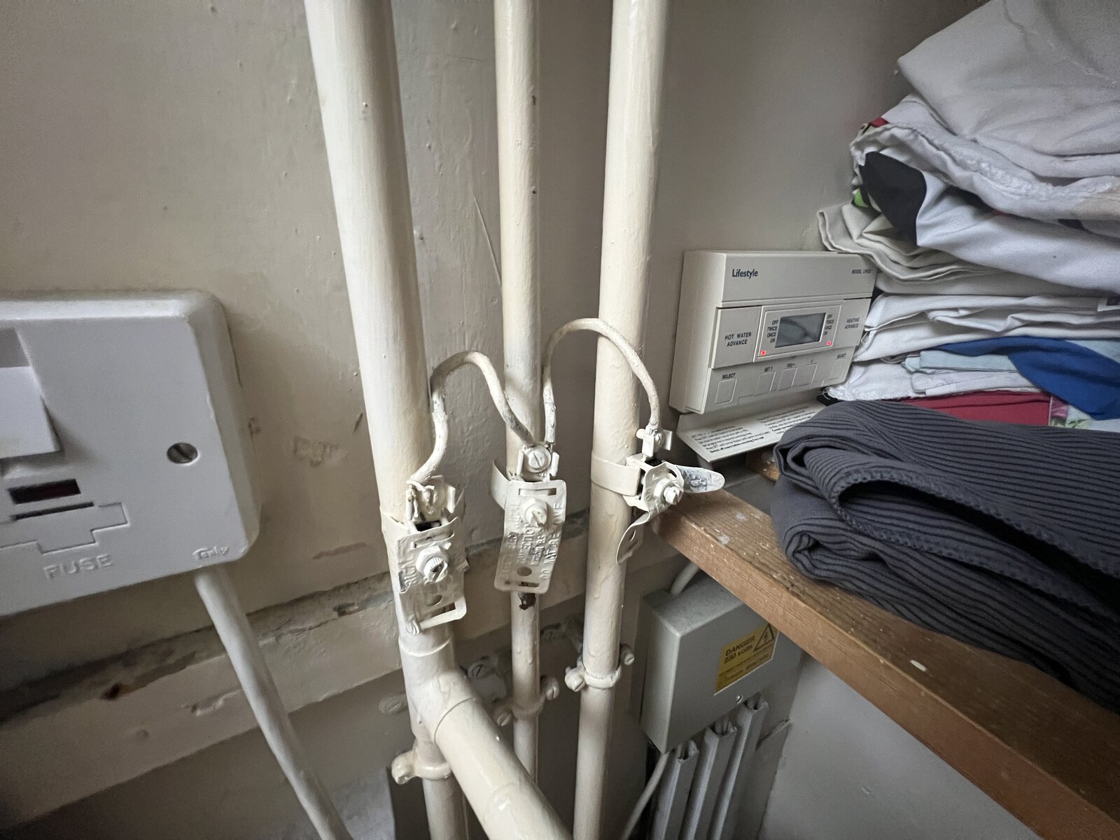

Thanks for the reply. I think it is fed from the loft yes.
Pump is running (hot to touch and i can feel the motion of it running when i place my hand on it)
Pictures below

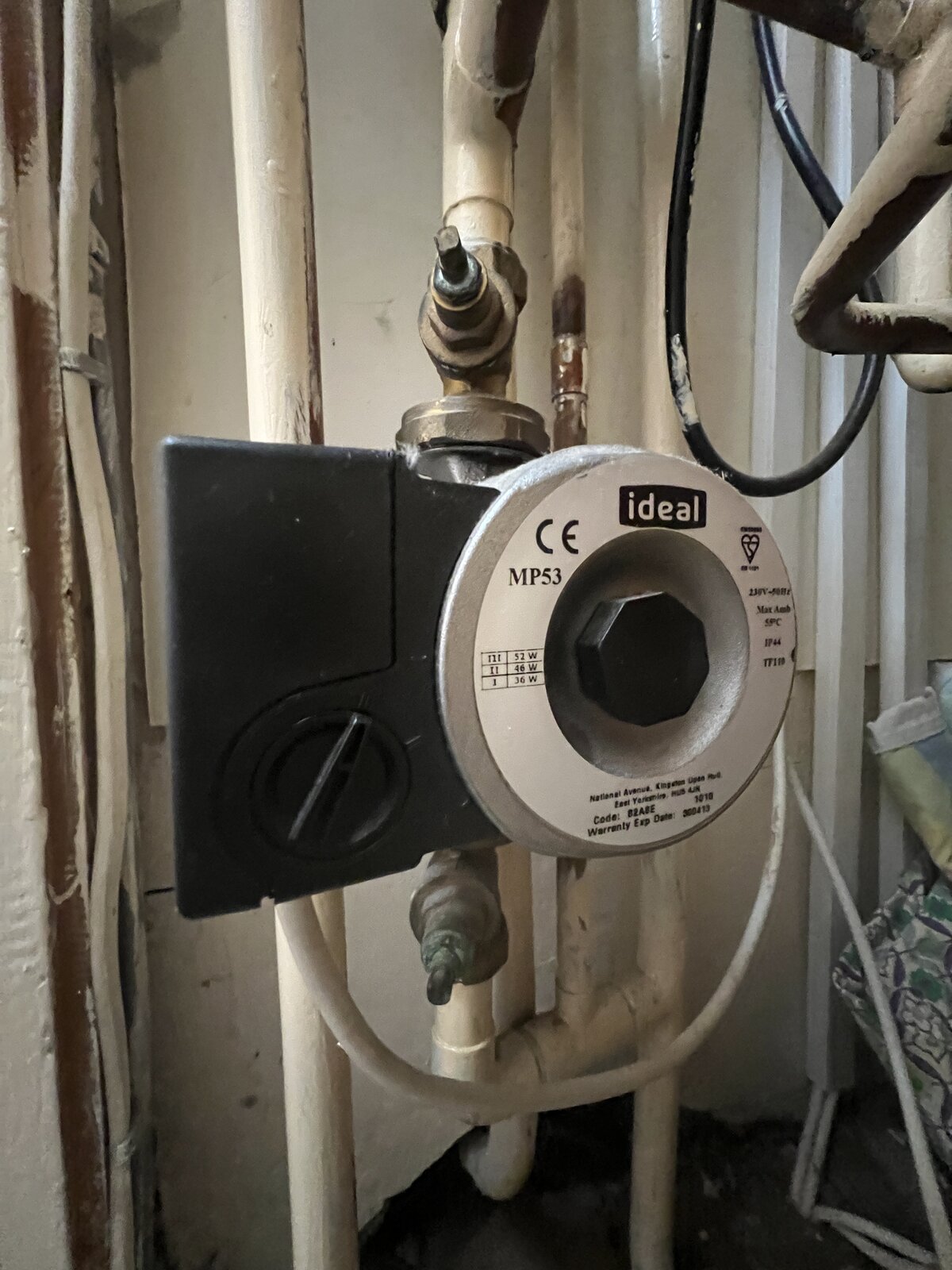

If the pump is excessively hot it may be full of air/ lack of water in it.
Try bleeding the pump.
If your system is fed from a small loft tank ,there should also be a large tank in the loft that feeds the hot water cylinder. Do you have two such loft tanks ?
If so ,check the water level in the smaller one.

The pump is burning hot, can't touch it for more than a split second. So i'll give the bleed a shot first as i'm reading online it should be a 'tad' warm...
So, whilst waiting for the heating to cool down, i'm looking at the pump and it looks different to what i'm seeing around online. Where do i bleed on this? Not wanting to mess around with something i havent touched before, this plastic cap on the front, do i just pull this off? ASsuming the screw i need to turn is under that?

Turns out i just need to turn the plastic screw, did so, nothing for a few seconds and then some water started to drip out. Sealed it again, turned the heating on and so far the boiler hasn't cut out... happy days, just waiting now for all the rads to warm up and see if that was the issue.
