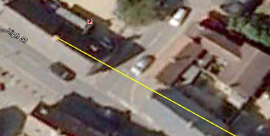

I have used Google Earth and its distance measuring tool which draws a line from aerial to transmitter site.
Then aim the aerial at a suitable landmark under the line, in this case the chimney stack of the house was good enough.
