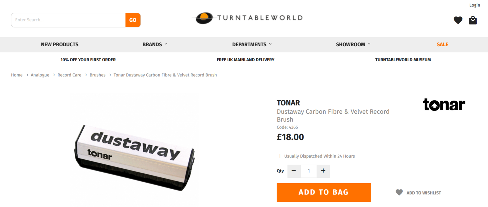

A record brush is a very good investment. This is something that actually pays off, so the use of the word investment is appropriate here. A small amount spent plus a little time developing the ritual saves pays you back in records that live longer and don't need to be replaced.
This is very good. The reason is that the velvet pad is about the size of a Mars Bar, so it's wide as well long. It is flanked on both sides by carbon fibre bristles, not just one.

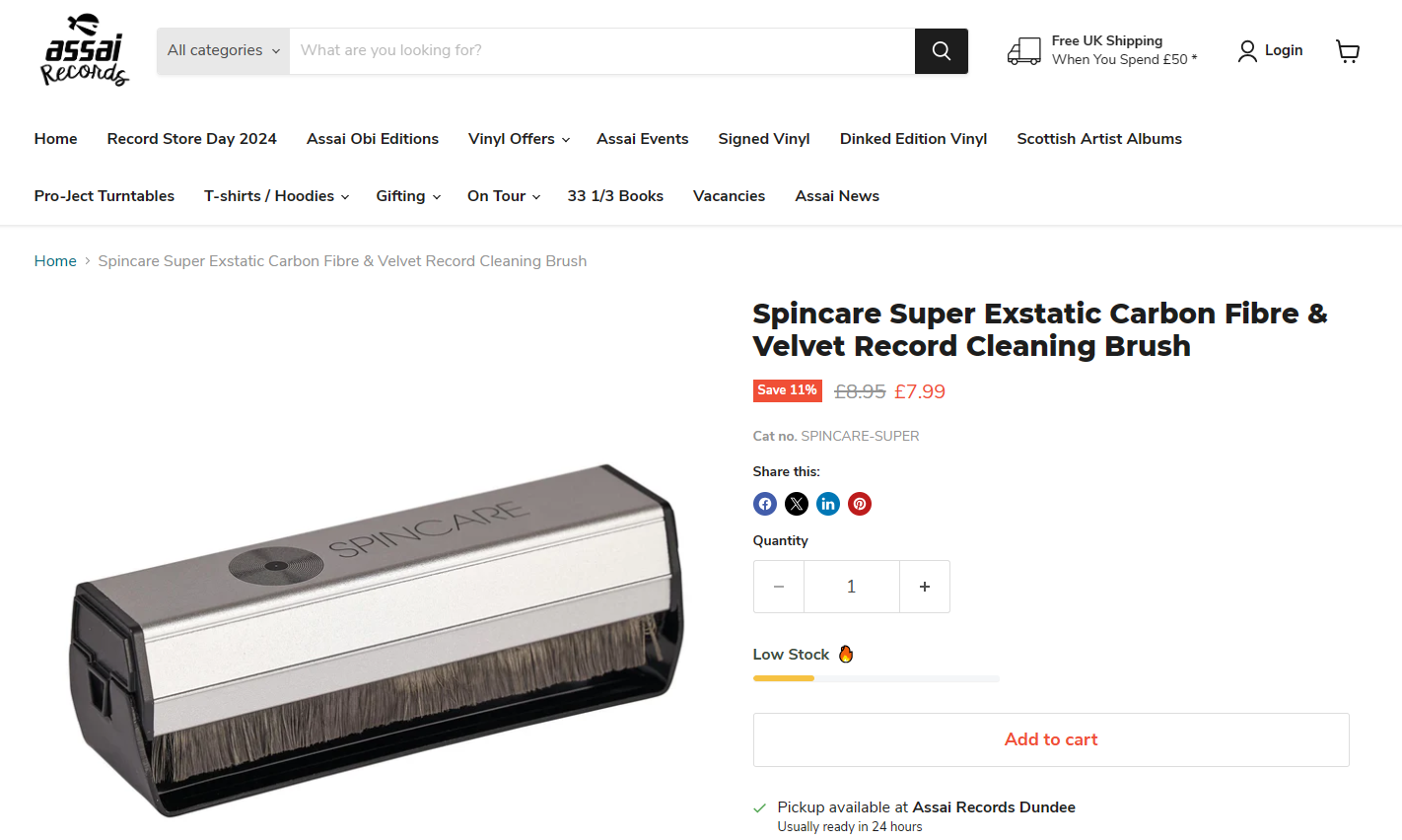

I think this below is the same product under a different badge. Google images suggests that it has the double bristle layout, and it's cheap. Worth contacting the seller in Dundee to check.
Everything else in record brushes is less: It's a smaller pad, or one row of carbon fibre, or two rows but no pad, yadda yadda yadda.
