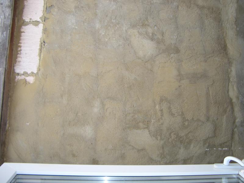

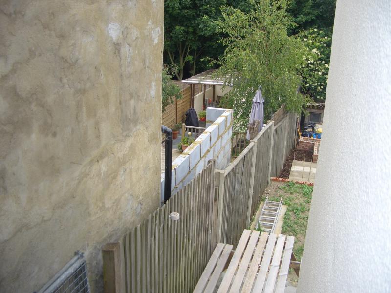

My next door neighbour started building last year, what I can only assume is going to be a conservatory. The fences are 6 foot high, and so far the blocks are 3 courses above that. He actually put another course up yesterday, which prompted me to ask the question. Would he have required planning permission for this?
I've been told that I would be informed by the council of their intentions since i'm the next door neighbour (if this is true),but I've heard nothing.
I don't talk to the neighbours, maybe the odd hello twice a year, but it not a bad relationship, we just keep ourselves to ourselves and that suits me.
The thing is, if you intend to build something that will encroach over your neighbours garden, and it does, is it not curtesy to inform them of your intentions, and it hasn't got a roof on yet! Look at the pictures and you can see the poor finish that I have to look at all the time, but because they can't see it, they don't care that it is an isaw to us!
We will be moving in the coming months so we're not too bothered now, but out of principle, why should they think they can build what they like without thinking how it will effect us!
He is actually a builder, but look at the pictures of the side of their house which is taken from my back door and is 5 feet away from us. We have to look at the crap rendering every day. I can do a better job. And now another side of a another building overlooking our garden for us to look at. I'm worried it will put potential buyers off buying our property!
Are they in the wrong, and if they did require planning permission, how do I find out if they did without asking them directly, which is awkard to do. Ring the council?
Advice and thoughts are welcome
What I can see from my back door
Very poor rendering which is the side of their house 5 feet in front of us

The rendering(if you can call it that) was already done when we moved in. I was just showing how bad it is and the fact that because they can't see it, they don't care that we have to see it, and what we can probably expect from the new build.
Access would have been ok when it was rendered, being able to work from my side. They were more friendly with the people who lived here previously.

It looks like it could be an 80% glass conservatory with a solid wall on the fence side (because glass would be pointless) - therefore PP probably not required assuming he's ticked some very-easy-to-tick boxes.
Gary
It's highly unlikely he would need planning permission unless you are in a conservation area or the building is listed. If his house is detached he can build 4m out from the rear elevation as long as the eaves are not more than 3m high and the roof ridge is not more than 4m high.
A potential issue though is the position of the boundary. The fence looks like it is some distance away from the boundary (on your side) but is that the correct position? I would have thought the correct position would be along the line of the corner of the neighbours house. If so then his new gutter will overhang your property and that can cause problems.
I'm not suggesting you get into a boundary dispute with him though. Especially if you want to sell up. But it would be worth having a word to see what his intention is.
If the fence is correct then it seems ok to me. He has enough room to not encroach.
