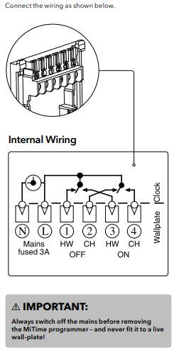

Your old programmer looks like a Honeywell ST6450. So, should be compatible. Honeywell programmers usually follow the same wiring format:
Terminal 1 HW off
Terminal 2 CH off
Terminal 3 HW on
Terminal 4 CH on
Terminal 2 will not be used, and terminal 1 may or may not be used, depending upon the type of system that you have.
However, as suggested, and to be sure, the wiring diagram shown on the existing programmer should confirm this for you.
If it is, then the MiTime programmer has the same connections as shown below:
As has been mentioned though, whilst it may be the programmer that is at fault, several other faults can also cause the same symptom. It is more often caused by the motorised valve (if your heating system has one) Especially after a period of inactivity. So, you may find that the fault is still present even after the programmer is replaced.
