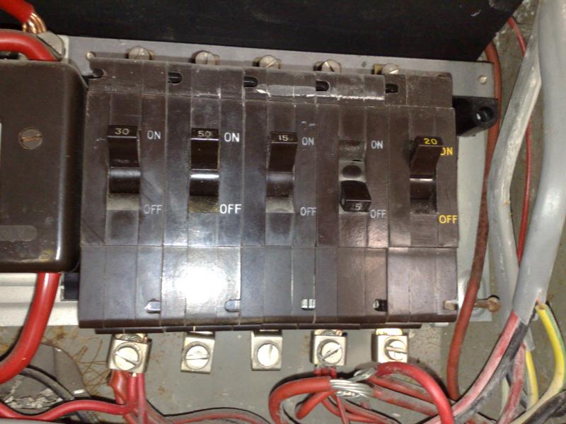

Was at a friends new house as he had a flickering light.
Took the cover of the board and was greeted with the following.
Is that a home made CU? I've never seen those Crabtree breakers in a domestic board.
Where does the main earthing conductor enter the CU?
Where does the uninsulated earth go?
I have come across these converted boards before. They are converted from old flush fuse boards. I replaced 10 of them in a nursing home last year, all fed with pyro submains from a section board. What a mess I made getting the flush boxes out of the walls.

I had some old aunts who had an architect-designed bungalow built, in the 1960's. At the time it was a very state-of-the-art build. It had two C50 boards, one of them for the underfloor heating.
