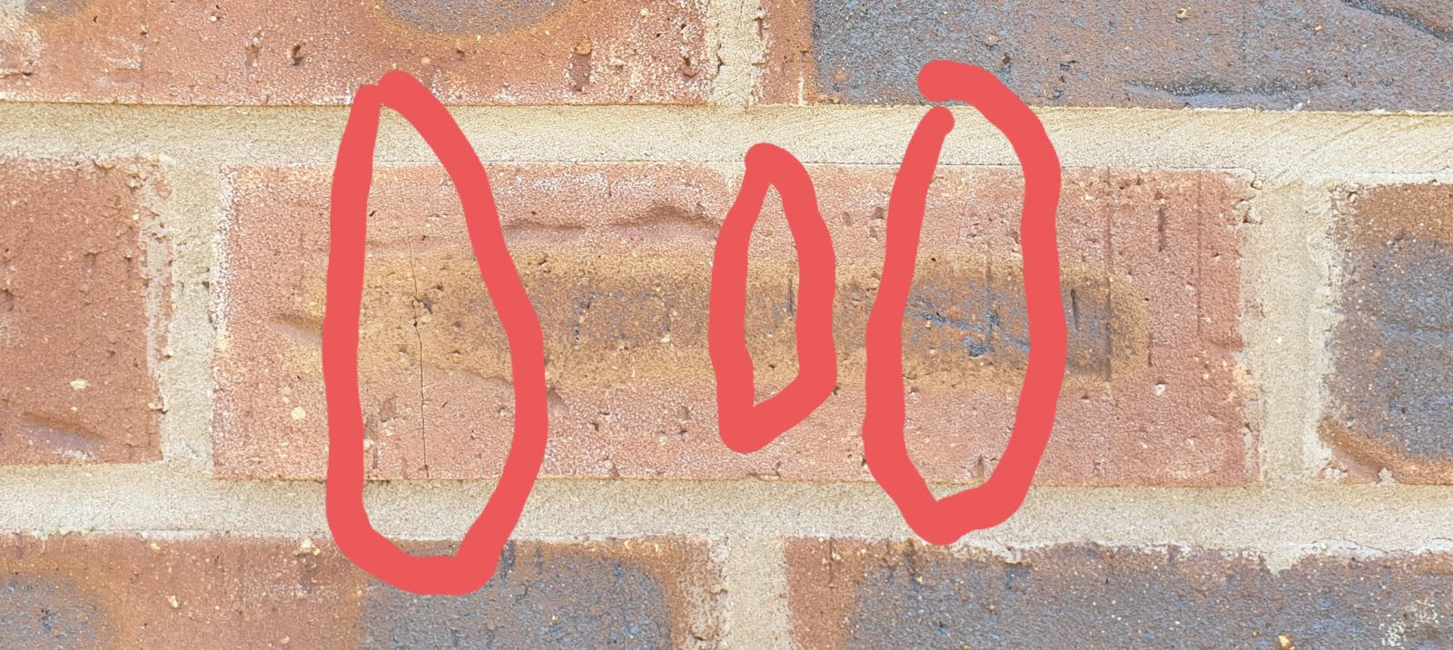

I just noticed that there's a vertical crack straight through a single brick on the front elevation of our house.
It's about six foot off ground level and I can't see any damage to other bricks or mortar in the surrounding areas.
Any ideas what caused this or of it is a problem?

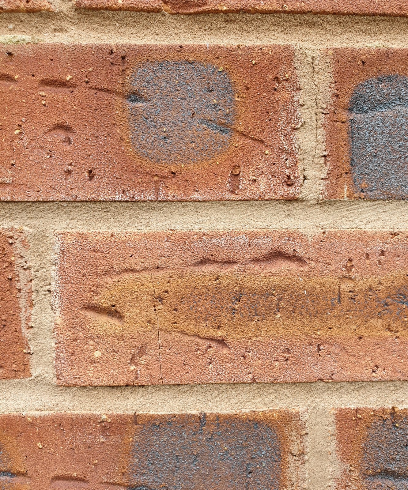

That crack could of been there from when your house was built
Appears nothing to worry about but of course now you've noticed it you can't unsee it!
That joint ( perp ) is so tight it's little more than a crack.
The brickies. That and the brush marks in the pointing - either overzealous brushing or brushing too soon because they wanted to leave site early or the site brick cleaners having a field day with the acid.
Either way, they have aged your pointing by about 10 years.

Checked closely on this today and the brickies must have really hit it hard - there's actually three cracks in the brick, though granted they are hard to see.
Given these extra cracks, does it need replacing, or is it ok ti leave?
First off, you either have excellent eye sight or you must have been so bored to spot them.
Second, I have lived in houses nearly 100 years old with bigger cracks and they are still standing. Brickies, and other trades, can sometimes be a little heavy handed but from the small section you have shown us the wall looks quite substantially in good order. I think you are worrying over nothing.
