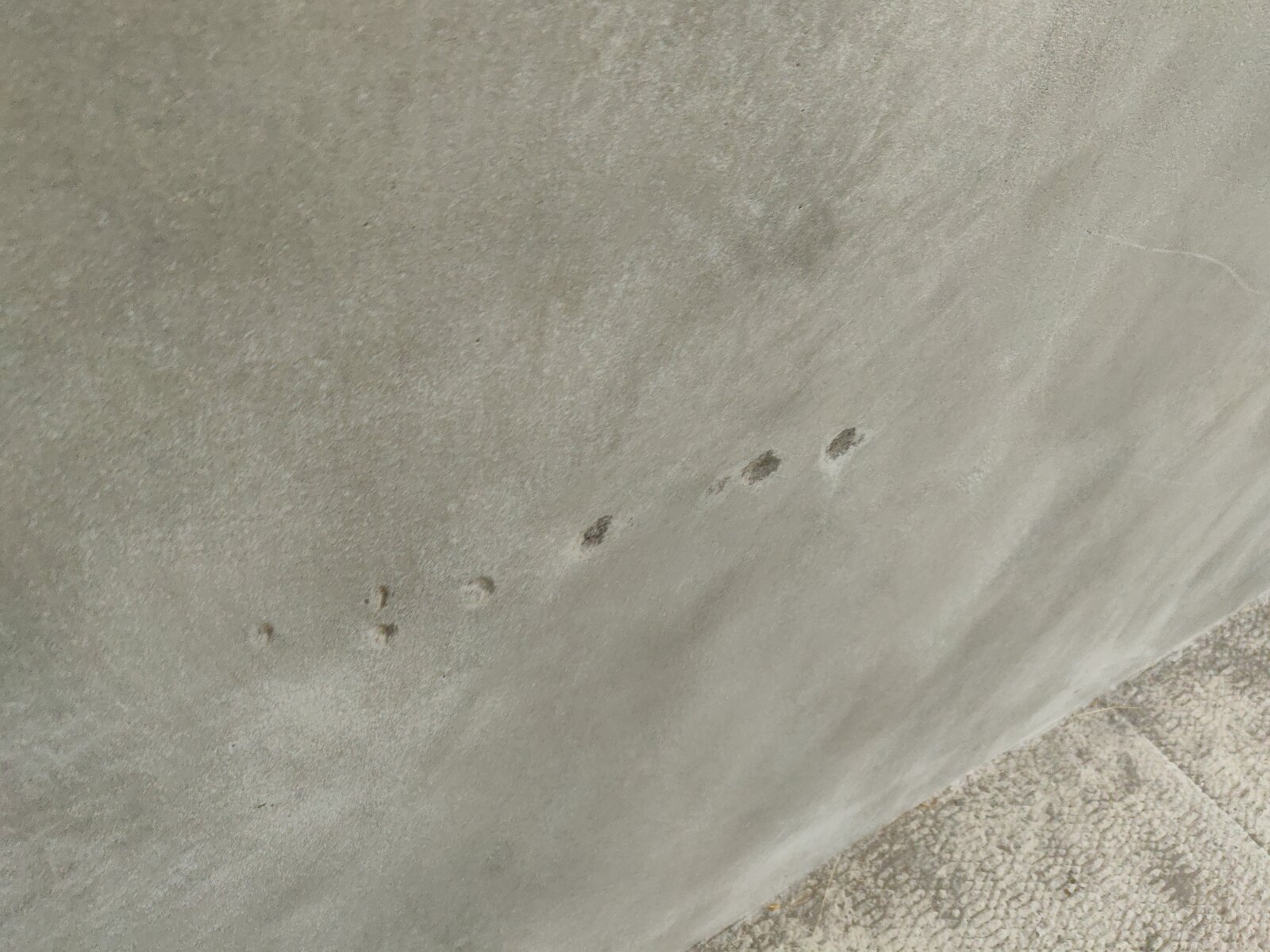

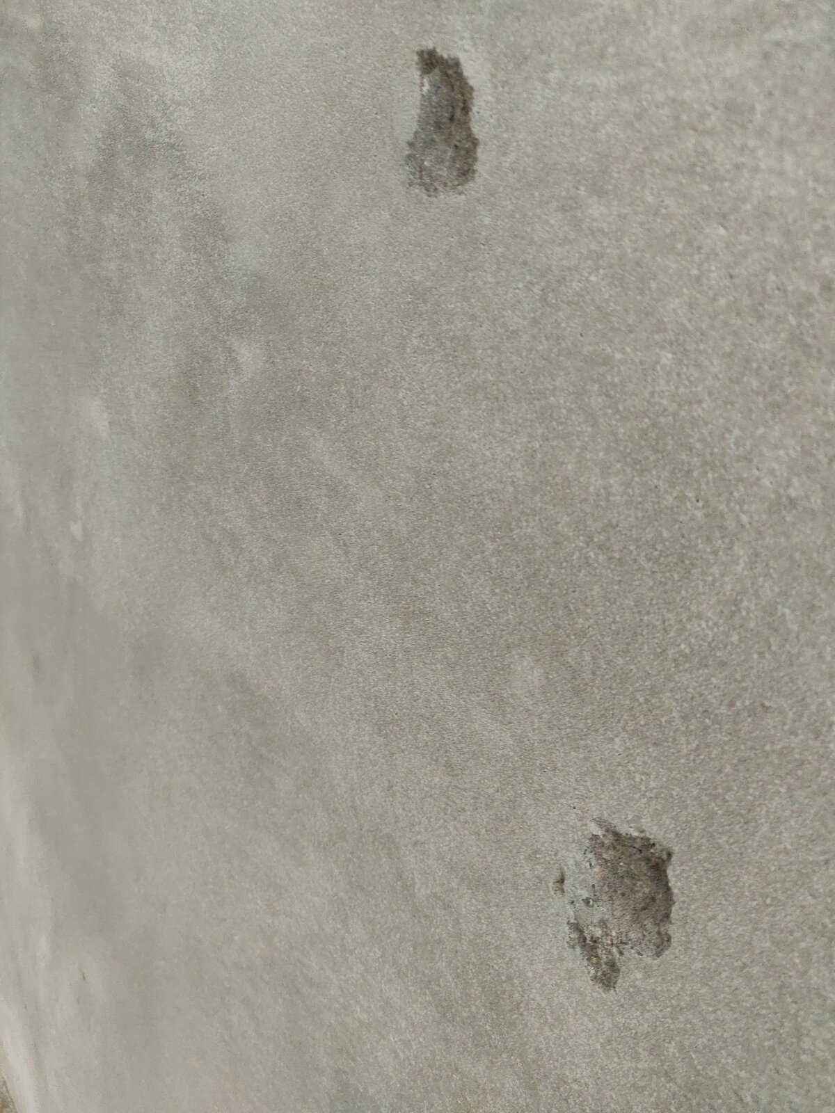

Hello,
I am currently building a shed and the inside plaster has been slightly damaged by my kids when it had not fully hardened - by bicycle handlebars. The best way I can describe it is like a graze in the plaster. I've a photo attached.
I'm wondering if there's anything I can use to fill it up - it's not very deep though.
Many thanks
Toupret Toupreleth F will be suitable but it is dark grey.
Do you plan to paint it?
If not, you could add (waterbased) paint to the filler and try to colour match. It won't be perfect though.
Alternatively, try to match it with a small batch of the original cement plaster. You could fill it and sponge off the excess.
