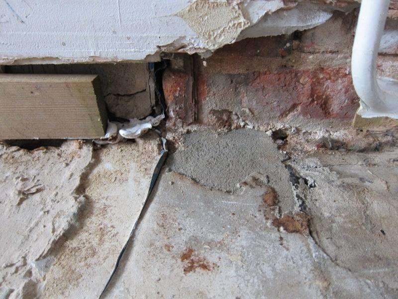

My hallway has laminate flooring laid over fibreboard on top of what looks like some sort of old-looking bitumen/asphalt stuff.
Removing the skirting and a piece of the laminate next to an internal brick wall (c1920s), I found that the underlay has become damp in the couple of inches nearest the wall, and has started to break down. The brick of the wall is old-looking, with a fair amount of salty-looking efflorescence where it's exposed, but the plaster on it is sound and doesn't show any signs of damp. So to my untrained eye, it doesn't look like rising damp.
I noticed that the bitumen-like layer doesn't actually meet the wall. It gets a bit bumpy-looking, then stops a few mm from the brick. I suspect that the dampness affecting the underlay is coming from there.

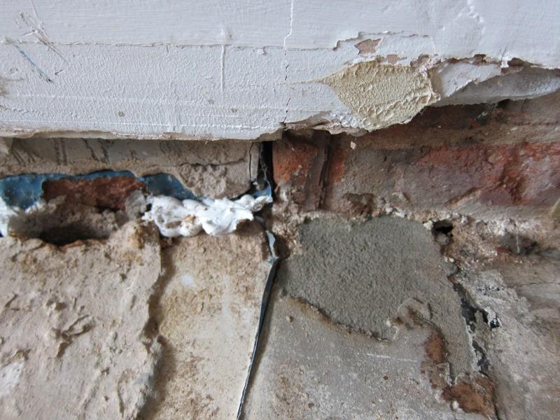

Removing the next piece of laminate and underlay exposed the line where our extension meets the old house. Here you can see where the blue plastic membrane under the newer screed floor ends, then a bit more cement, then the start of the bitumen-stuff layer (on the right). Between these two areas the damp has crept much further into the underlay. In the photo, the start of the red brick is the old front of the house, and everything on the left is the extension.
The piece of wood on the left covers a hole. A rodent of some sort had been heard scratching at the back of the skirting last week, which is why I removed the skirting/laminate in the first place. The hole looks to go down a few inches, where I'd guess it leads somehow to the outdoors, despite this being an internal wall. We've never seen any sign of mouse activity inside the house, so we think the incursion was fairly recent, and that the animal never actually made it inside the house. We also had a small ants' nest behind the skirting, and the ants seem to be the same ones found throughout our front garden, so that also leads me to believe there's a route to the outside. You can see the hole at the far left of the next image.

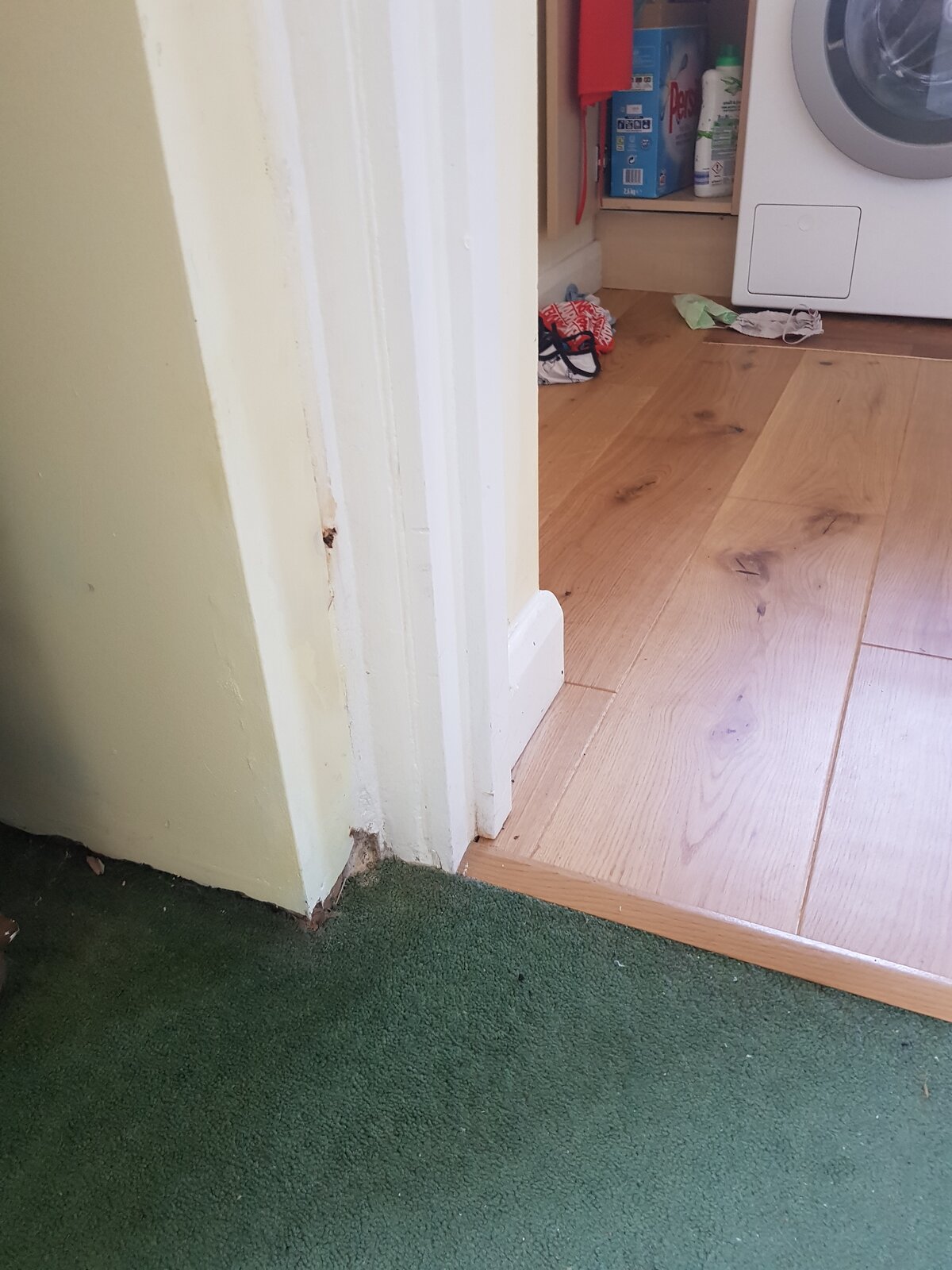

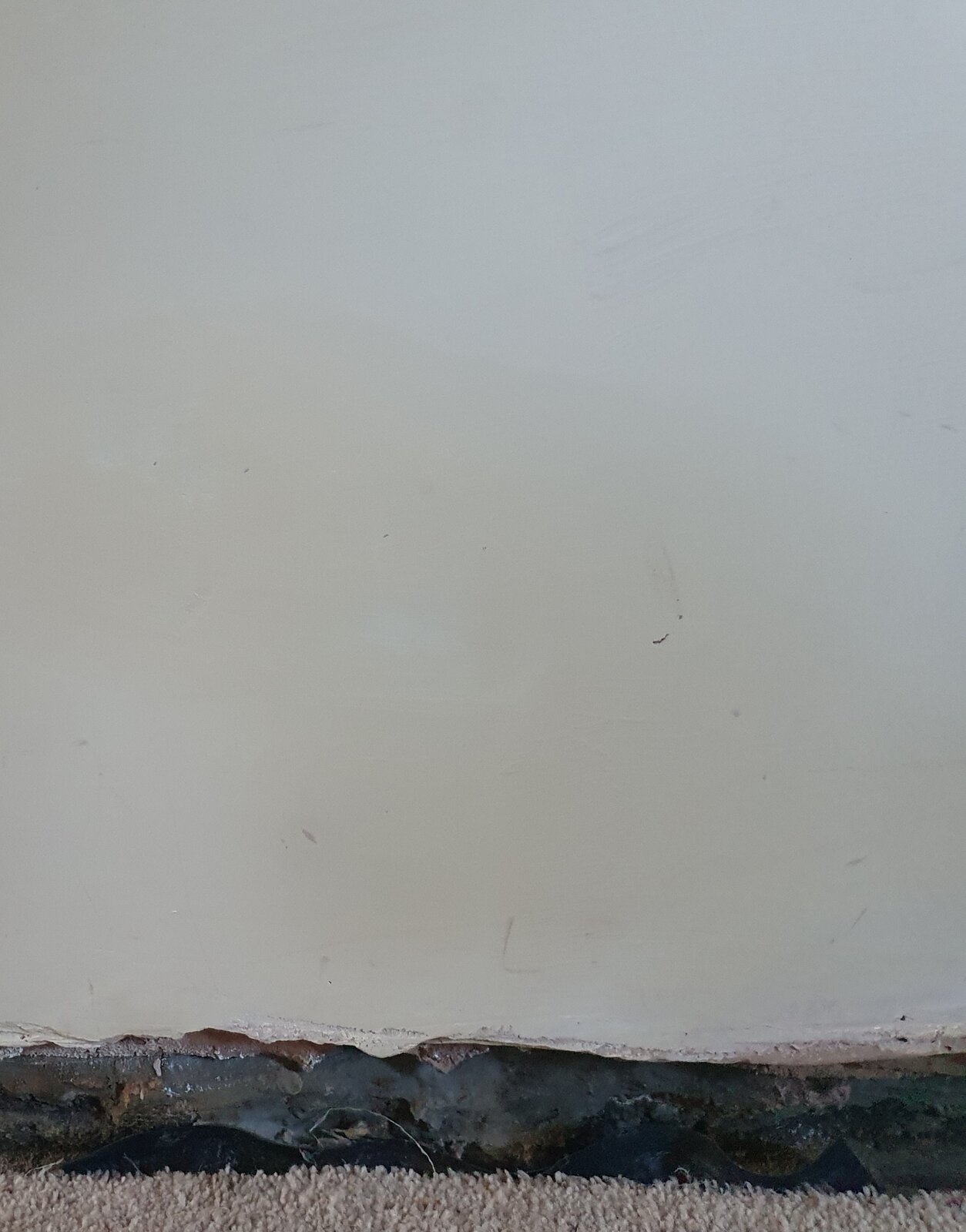

thanks for replying. The extension is full height and the roof tiles were replaced at the same time we believe. Been here 20 years and never found solutions to our damp issues, one internal wall can't take a skirting board but that room has marley tiles on the floor and the damp appears where a fireplace used to be, (chimney now completely removed), several wall have been replastered with whatever is needed to cater for damp. I fear I might have to go for the nuclear option and dig up the old floors. 1930 ex council house, guessing the concrete was done in the 60s. We stopped using the pipes serving the radiators 8 years ago as others in the road have had leaks due to concrete eating the copper pipes. First picture internal wall - note the darker colour lower down, more pronounced after rain. Second picture is the door from the old to the new, note the rusty nail, and lack of skirting board.
