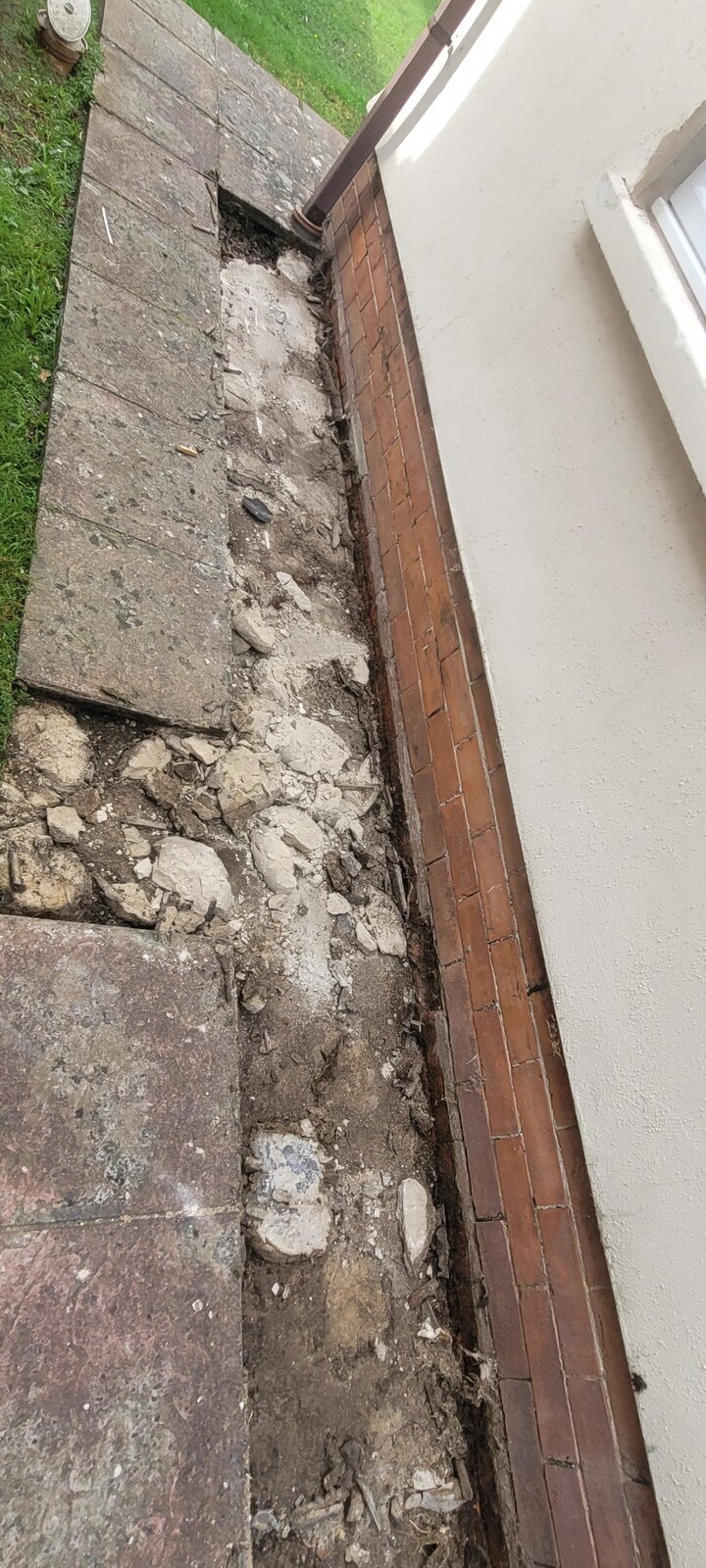

I showed them that previous to me buying the property someone had installed a path around the property and it was on the dpc level and not 150mm below and the pointing was damaged but he still was adamant that the dpc had failed.

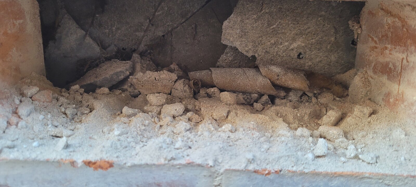

I was not convinced and removed the path so now the ground is 150mm below dpc and i removed brick to inspect cavity to find bridging in many places i removed all rubbish from cavity so hope all now good.
Photo shows path now removed and i have since dug down re pointed and now have 150mm below dpc
Cavity pic shows rubble etc found in cavity i have scoped cavity and now pretty clear was full to one brick above dpc in places scope pic shows clear to bottom of cavity now

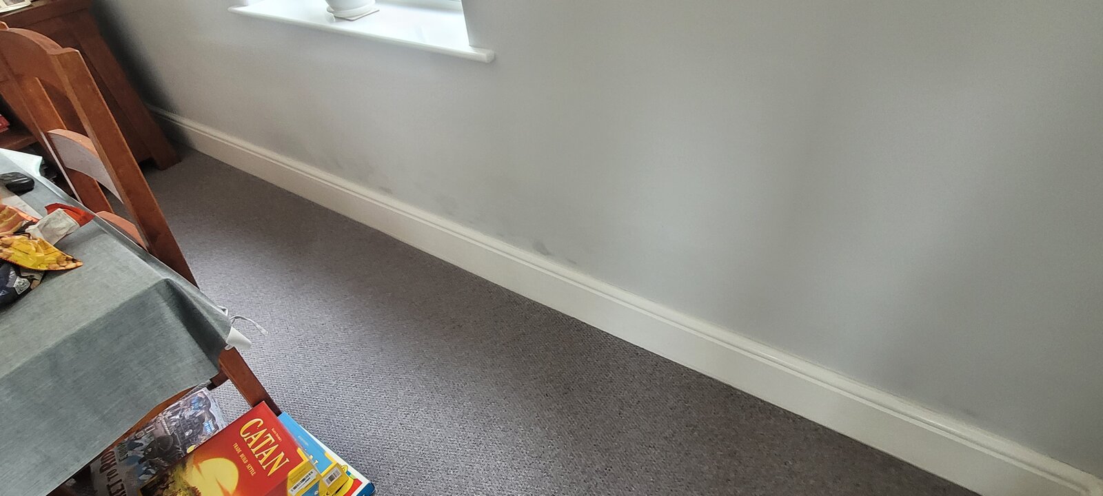

pic shows damp on wall

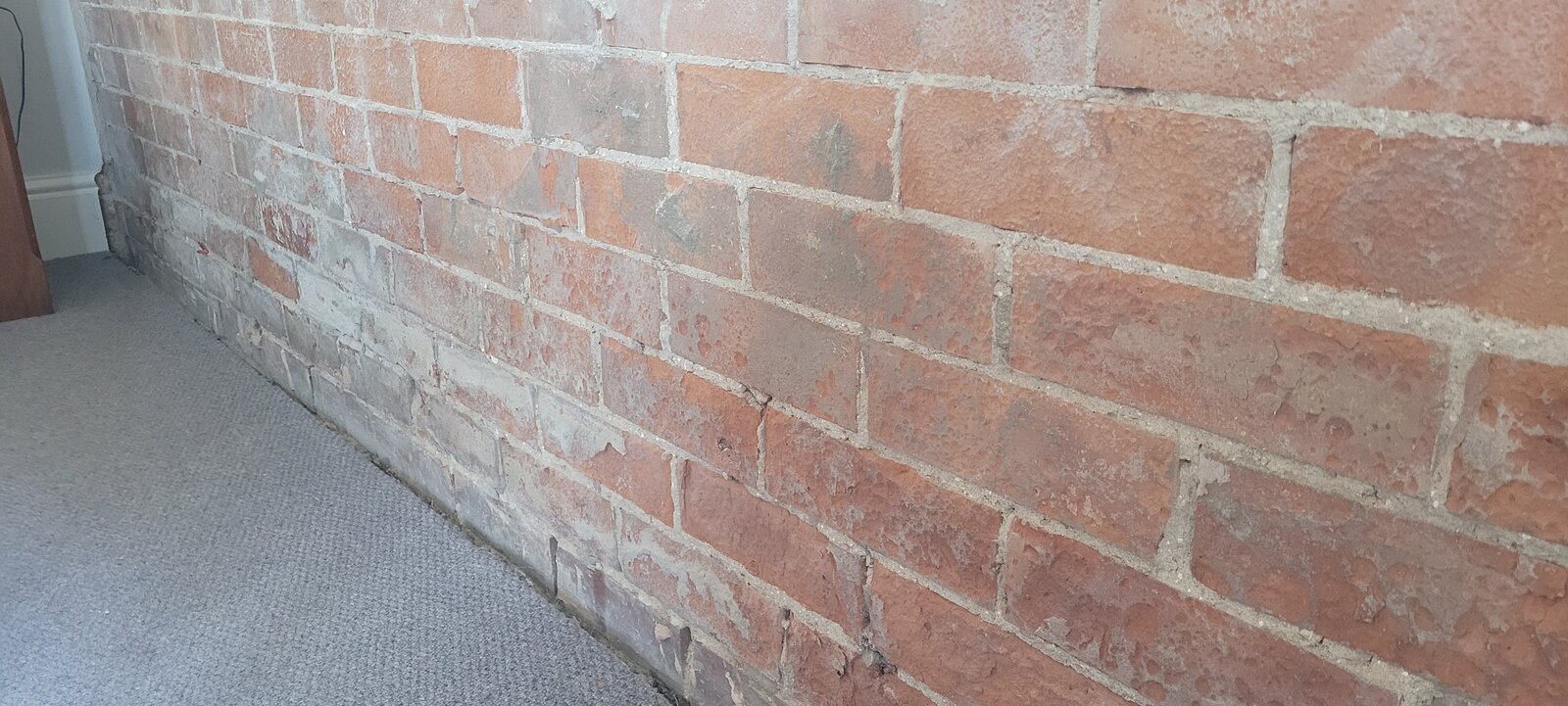

pic shows plaster removed
My question is i have removed the damaged plaster and plan on fixing membrane onto wall salt neutralizing brickwork and re plastering with limlite renovating plaster to allow wall to breathe. Does this sound like a good plan? probably a bit OTT but only want to do it once.

Your problem appears to relate to a bridged cavity, not rising damp. So the remedy is to remove the bridge ie clear out the cavity. Your proposed work is not required
