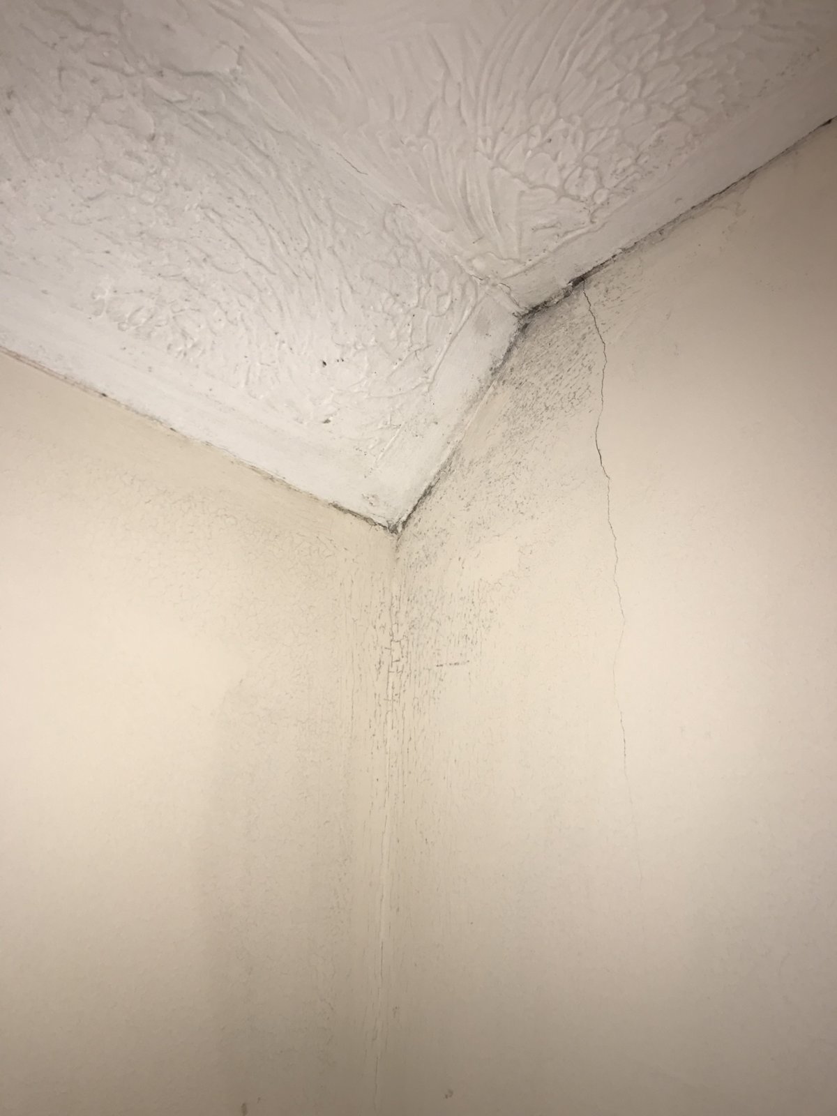

In our bedroom at a top corner we have damp. The wall is a mix of outside wall one side and adjoining property the other. The ceiling seems dry.
There was dark mould appearing which we thought was ventilation problem as the pvc window doesnt have a vent sash. We get dark mould around the window in the bedroom and living room too, we put this down to the windows, we’ve cleaned this up and seems ok. The rear of the house is ok as the windows have vents.
We cleaned up the wall on Saturday, but this morning we could see a patch on the corner looking wet and it was when you touch it. It hasnt rained last night, but was -3 outside.
Would this be an outside issue like guttering, tiles or condensation? We had a quick look in the attic and couldnt see any leaks..
Many thanks :)

Heres a pic of the offending corner:
Oddly enough, that could be water penetration as well as condensation. But it's on the slope of the roof, and you won't have any insulation under there, so cold and condensation is more than likely. Clean it off with a mild bleach solution, and pick a cheap damp meter off of eBay.

Yellow or brown stains with a defined edge and no mould is penetrating damp
No yellow or brown stains on the outer wall, but there does appear to be a defined edge towards the left. If the damp meter doesn't find a defined edge, then that proves condensation, which is what I suspect it is as well.
Thanks both. That defined edge on the outer wall could be staining from the black mould. It was going that far down, and ive wiped it all off.
The patch on the wall at the top near the slope which has black/dark areas which was wet this morning. Its darker as the paint has crackled and the mould is in the paint cracks.
The wall is dry this evening, so will leave window slightly adjar and see in the morning. The outside temp is exactly like last night, so same conditions...
