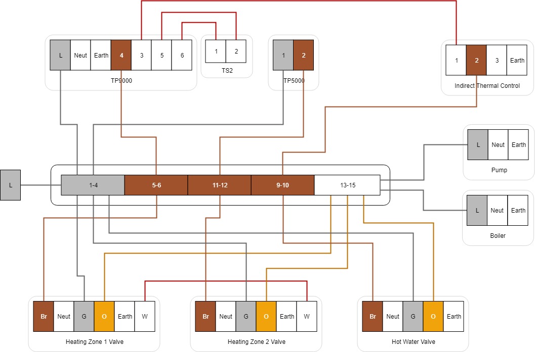

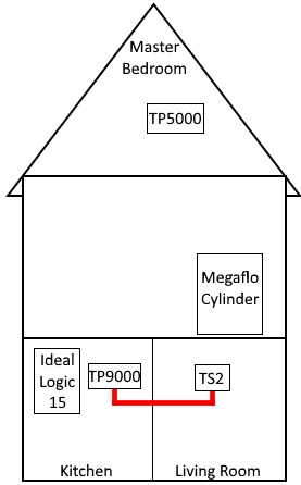

Hello all,
I'm thinking of buying either Tado, Hive or Nest for my house. I live in a relatively new build 3 story townhouse in the UK with the Danfoss TP9000 thermostat / hot water programmer on the ground floor next to my Ideal Logic 15 boiler, a Danfoss TS2 sensor in the living room. Then I have a Megaflo cylinder on the first floor and a Danfoss TP5000 thermostat on the second / top floor - I've uploaded a photo to this post to illustrate (quite badly).
I now know that the TS2 sensor is connected to the TP9000, and that the TP9000 should be relatively straight forward to replace by any of the products. However I'm a little confused by the TP5000 and what I would need.
I have two independent heating zones, one controlled by each thermostat and so I expect I may need two of something. The products I've mentioned above appear to support multiple heating zones but I would imagine I need sensors of some form in the regions where both thermostats are currently located. But I need to understand more about what I need and how it would all link together.

So looking at the wiring diagram (attached), I think I can see why I might need an additional Heat Link (Nest) / receiver (Hive). The TP5000 appears to connect directly to the cylinder and so I need some way of closing that circuit.
With only two wires going to the TP5000 (Live & Br into Heating Valve 2) I'm wondering if that can actually be directly replaced by any of the smart products or whether I'm going to need to put the receiver / Heat Link / Tado next to my cylinder.

The easiest DIY route is usually to disconnect the existing wires from the programmer (downstairs) and thermostat (upstairs) and reconnect them to the new receivers (or new thermostat upstairs in the case of Tado). This avoids having to making changes at the wiring centre, which can be very risky for someone, unless they know exactly where each wire goes, and what it actually does.
As you suspect, the Tado would probably be the easiest to install, especially if the upstairs TP5000 is powered by 230V. As the thermostat would be a straight swap. (Unless it's the battery powered version then a new 230V supply will be required)
Regarding the hot water control, with any of the three, there is no need to touch the wiring to the hot water cylinder, that remains as it is. The only change to the hot water control is replacing the existing programmer with a new receiver.
