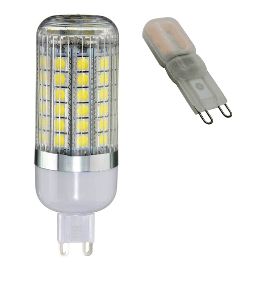

I wish I could say what causes the shimmer one sees on some LED's, my electronic switches click, so one assumes they had a relay inside, they do not dim, most bulbs work OK, however the G9 bulbs caused me a problem, the small bulb G9-comp.jpgI had a problem with staying on cured with one of these load-capacitor.jpgand a shimmer which would go if a quartz bulb was fitted, only one of 5 needed to be quartz or one of the larger bulbs were fitted.
One of the larger bulbs failed, and I opened it to see what was inside, the smoothing capacitor after the full wave rectifier was nearly as big as the smaller bulb, actually found a dry joint and repaired the bulb, still working a year latter.

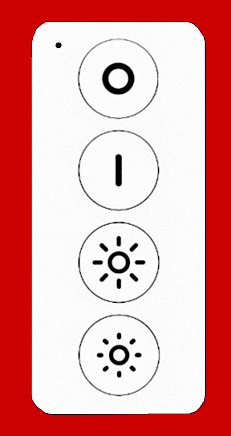

However the Lidi bulbs could also work with a remote, Lidi-remote.jpg and these can dim as well as On/Off, and you can also adjust the colour temperature with the app, and were cheaper, unfortunately can't find more of the Lidi remotes, the came with the three lamp GU10 light bar, and work with zigbee.

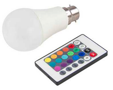

In the guest bedroom I use a bulb with dedicated remote Lampandremote.jpgwhich does not connect to internet, it means no need to program it into guests phone, default is on, so turn off light at wall switch and back on, and it works even without the remote. From B&M bargains.

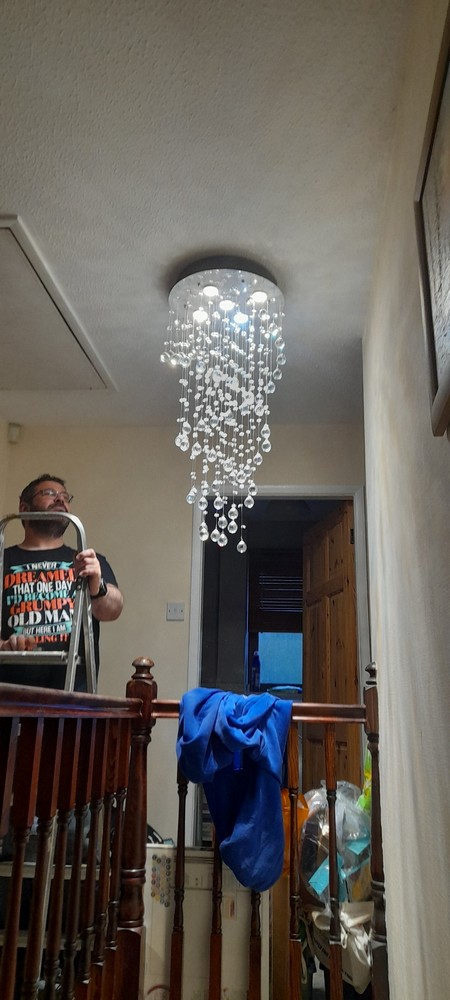

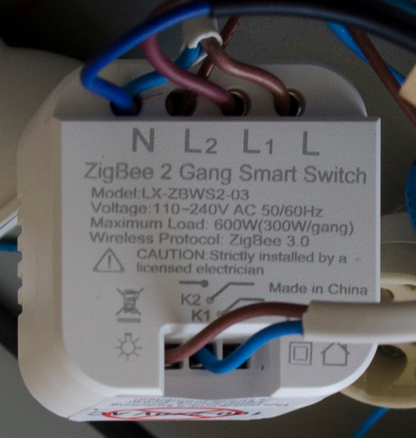

The landing light odd one out, and uses a relay DSC_6061r.jpg this means original switch still works like a two way switch with phone or google nest mini control. Although I can dim and colour change the centre bulb, in the main centre bulb used so it does not wake anyone, and outers for good light DSC_6799.jpg Centre_bulb_colours.jpg 20220529_211956.jpg it is not really there because of functionality, but to look good. I think we have to decide if we want lights to look good, or light the room, I can dim many of my lights, but not really to do with functionality, and most are zigbee controlled with SmartLife. Or voice control with Nest Mini's, but most rooms amount of light is adjusted number of lights switched on, not a dimmer switch, we did start fitting them in the 80's but it was a passing fad.
