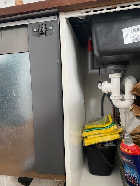

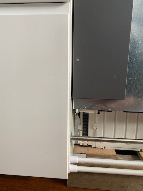

I have an Ikea Kitchen unite, the one with the dishwasher in it. The folding door does not fit anymore inside the kitchen cabinet; and this is breaking the parts of the door.
Basically, I am not sure why and how, the kitchen cabinet had shrink at the bottom; on the top it's fine but at the bottom is shorter of 5/6 mm; this is the reason why now the door when is opening is touching and damaging the dishwasher door/ and the cabinet itself.
There is a way to make wider the cabinet without having to cut the door?

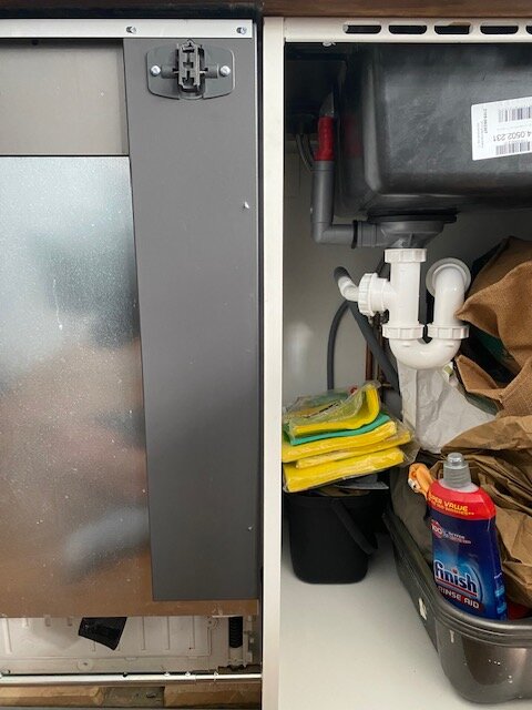

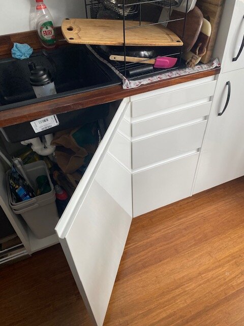

Hi Etaf, thanks for helping me out. I have attached pictures and I have marked in red where is the issue.
Do you have side cabinets each side of the dishwasher ? Both side: On the right side there a hole with the sink on it. On the left a hole cabinet with 2 drawer.
Do you have shelves in the side cabinets See above

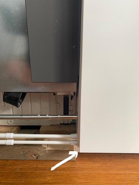

can we see a photo of that door closed and the gap by the drawers and by the side panel - is it catching on the DOOR or the side of the carcus?
the door is catching the bottom of the carcus..

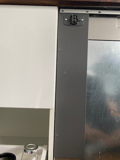

whats the gap like at the other side of the dishwasher door , is that still even and small all the way from top to bottom.

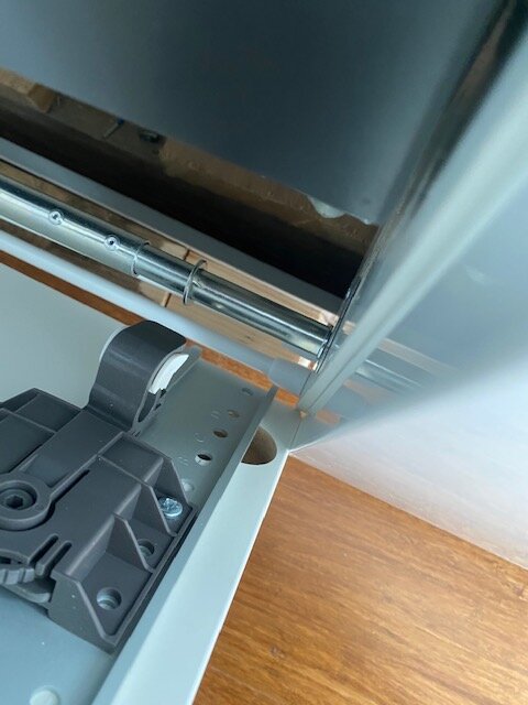

Difficult to see what is touching , from the photo , look like its touching the door on the other unit , rather than the carcass - the door on the other unit to the right , may be adjusted from the hinge to move it to the right slightly.
I know these hinge can move over time, as i have often had to reset the hinges (NOTE only as a DIYer helping friends and family)
and then as the dishwasher door pivots , it seems to be catching the bottom of the carcass.
what adjustment is on the dishwasher door itself. Is it still Square on the actual Dishwasher door ?
Sorry Its difficult to see, whats changed , something has moved slightly, not really shrunk , so moved out of square
Looks like dishwasher has not been secured to worktop? Constantly opening the door has caused the dishwasher to tip slightly resulting in the contact with unit.
Level the dishwasher again and secure.
