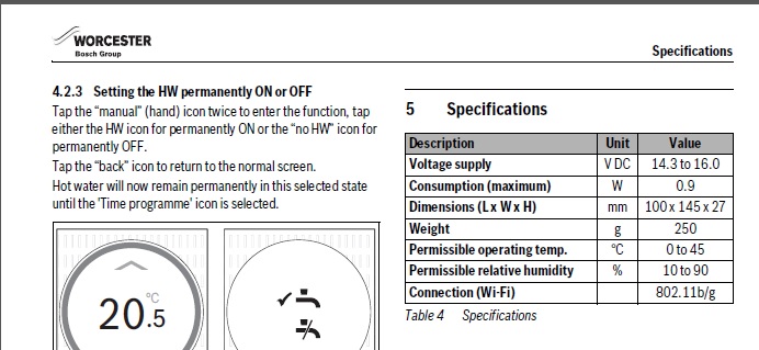

I have a feeling the voltage is not high enough because I've seen a picture from the Wave manual that says the supply voltage is 14.3 to 16 Volts DC. Picture below.

it should be 15vdc connected to the ems bus connection in the boiler.
I assume it should be AC as it's not a polarised voltage
It is a DC voltage that is always greater than 9 volts. This is regulated down to provide a 5 volts supply ( or maybe 3.3 volt ) to the thermostat.
Data is sent from the boiler by varying the voltage between 10 volts ( logic 0 ) and 14 volts ( logic 1 )
Data is sent from the thermostat by the thermostat varying the current it takes from the supply by connecting a 200 ohm ( typical ) resistor across the supply.
A bridge rectifier is fitted to allow the system to be polarity independent. Original design of the system was polarised but adding the bridge allowed for the system to tolerate errors in wiring that reversed the polarity without causing damage.

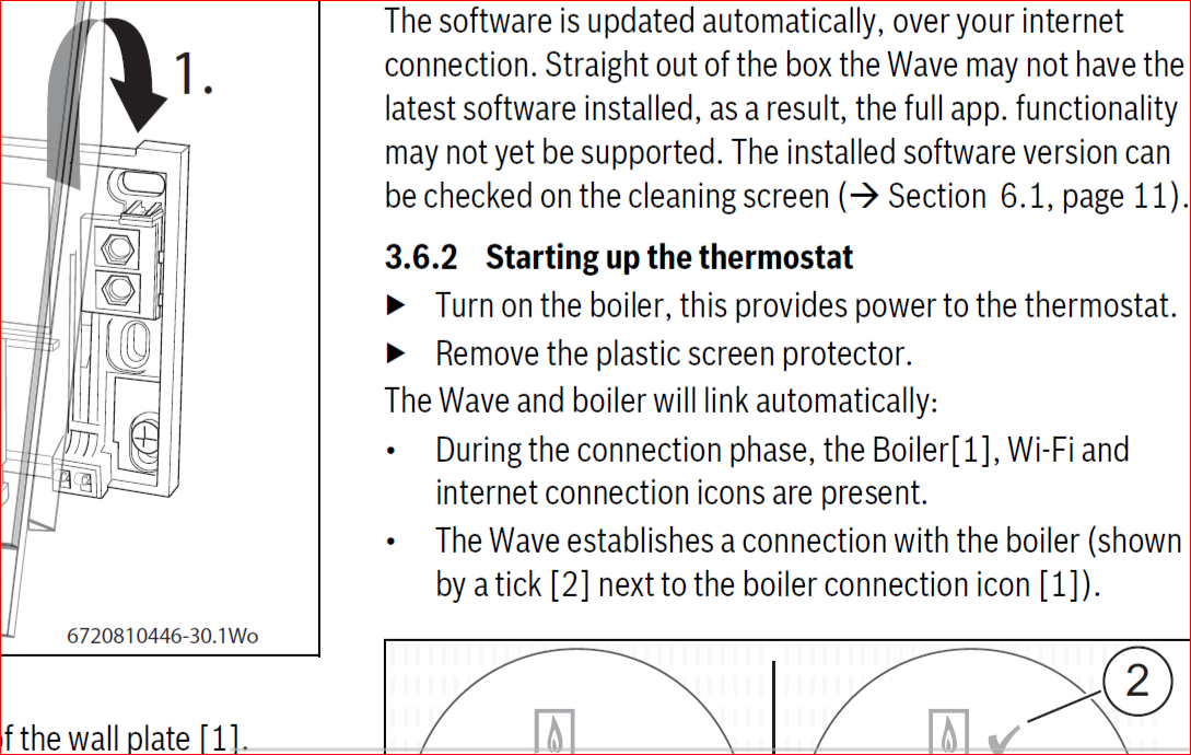

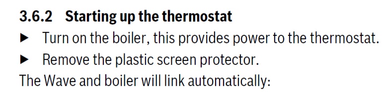

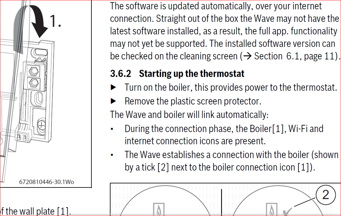

After a bit more digging I was wrong and jedi was right to pull me up on it, the wave uses the 2 wire to communicate with the boiler, I (wrongly) assumed it was the same idea as the nest :oops: should have put a bit more thought into it.
Amazing. the thermostat knows that it must connect to the boiler but not until after the plastic screen protector has been removed.
