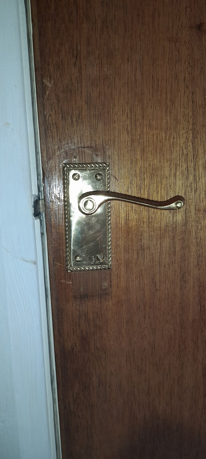

Door handle moves but door not opening
21 Feb 2021
379
Don't know how I'm going to open this unless I saw around the handle.
Could you not get a couple of screwdrivers and work the bolt? back, looks like a nice big gap.
Or take the plate and handle off and pop a screwdriver in the hole which should be square.
