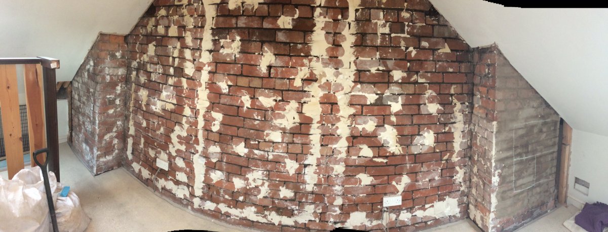

Hi All,
This could be an easy one for the experts out there to close out. My house is a late 1800s mid terrace. My attic wall (loft built to regs) has damp patches that have penetrated through the dabs. The other side is my neighbours non insulated , non converted attic room (no cavity between us, I don't think). See pics. I've hacked off all the plaster. There was no insulation between the wall and plaster. There are loads of gaps in the mortar between My neighbour and me. There are no vents in the wall. The plasterboard over both chimneys is brown feels a little damp. One is operational the other is capped.
Are these damp patches caused from cold spots? My builder says just re-board with insulated board using dot and dab. However, I think re point all gaps, salt neutralise chimneys, batten and re board with insulated board. Maybe insert vents? Is that sensible?
We have spent a lot and time and money ensuring the roof is ok and no water can be getting through... please help experts!
Thank you
Guy
Cant See any pics but if enough moisture is present to some through what you say then its unlikely to be cold spots and more likely wet brick work. If your chimney and roof is good then maybe nextdoor has an issue and the motor is being wet on their side and tracking through to yours.

Get the carp of the wall, batten it with 25x40 tantalised battens with a dpm behind them, then put up a VCL, then use insulated plasterboard. If you put in ventilation, then that'll allow any moisture to come through to you. You could paint the wall with a liquid dpm first if you wanted to make sure nothing comes through.

If it is very humid in your loft and very cold in your neighbours loft then you will get cold bridging and condensation occurring where the dabs are in contact with the cold wall.
There is evidence of black spot mould on the back of the plasterboard which would corroborate what I've said above.
A robust method (as said) of insulating, joint sealing, VCL and loft ventilation will enure this does not happen again.

Keep the trickles open on the Velux. It's probably more a case of insulation and a robust method of achieving a VCL.
There's definitely (as above) black spot condensation on the back of the p/b.
There are also very damp looking areas on the party wall brickwork - centre high being the most obvious one to me.
The RH c/breast brickwork appears to be damp.

The mention of party wall parapets brings a possible whole new ball game into sight esp. given that you have a 9" loft party wall. Close-up or good zoom pics of the parapets on your house side, and the neighbour's side would help.
Is the operational flue being used for solid fuel or gas?
Best practice is to open up fireplace openings if closed, & sweep all flues from all possible fireplace openings.
All flues must be vented top and bottom.
Capping typically means slamming a flag stone over the terminal opening, and disregarding any idea of venting the flue.
Do you know the condition of your stacks and flaunchings?
Your house is most likely a late 19thC build.
Operational chimney is gas. The other is a vented cap, and open below. It's the damp in the middle of the wall which has thrown me. It must be coming from my nieighbours side right? Stacks and flaunchings all good. Roof new 8/9 years ago, lead work good, tiles good. Had 3 roofers up there, none can find any issues / potential for ingress. Thanks for taking the time to respond.

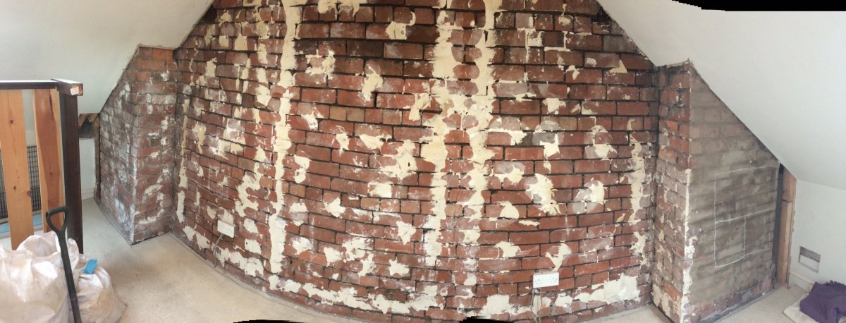

Removed dab from left chimney. Plan is to clean it all up, point, dpm, batten, board etc...
