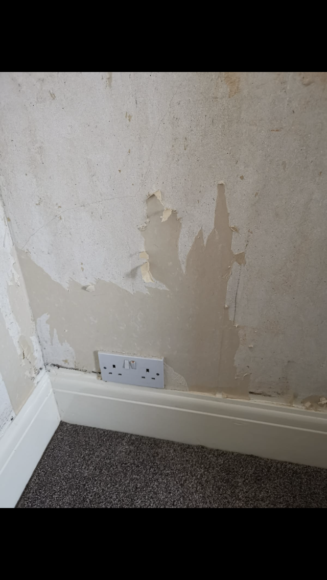

Hello there, I’m wanting to add a spur to a socket that’s on a ring circuit, the socket I’m spurring off is in the skirting board and in the alcove on the right of the chimney breast. It’s on a 32a RCD.
I’m after some help and ideas in the best plan of attack to route the wire as I can’t come up through the floor as there is concrete with a layer of brick on the floor of the fireplace. Or is there a good way round this?
I can chase walls in the alcove as everywhere is getting plastered but only the chimney breast is getting boarded, also where the fire WAS is gonna be boarded up so can run wires behind there then cover with capping when on brickwork in cente of wall. Please ignore the red arrow Thanks in advance!

I think I would put a switch or FCU vertically above the existing socket, at the same height as your intended socket, or perhaps on the side of the chimneybreast, with the cable running horizontally to the socket. I would probably have a double unswitched socket where it will be behind your TV. Run any conduit for the speakers or accessories you will decide on later, horizontally as well, to outlets on the side of the chimneybreast where the connections will be unobtrusive.
Where do you think the cables for your existing sockets run?
Thanks very much for that reply. The cables come in from a hole in the bottom of the back box so I’m presuming at the moment until I check in the morning that they’re coming from underneath the floorboards. If the brick wasn’t in the bottom of the fireplace I would of come up through there I think.
Once I’ve ran the cable up vertically am I allowed to run a cable horizontally where 2 walls meet? Then carry on to the middle of the chimney breast? Cheers
If you can get at the cables under the floor you can interrupt and remake the ring without needing a spur.
Cables can be run vertically and horizontally in line with the sockets.
Cables can also be run 150mm from corners on walls. See 'cable zones'.
If you fit a switched fused spur unit on the 'side' of the chimney breast, you should be able to meet this criteria.
The switched fused spur unit will be useful to isolate the tv without having to pull the tv away from the wall.
