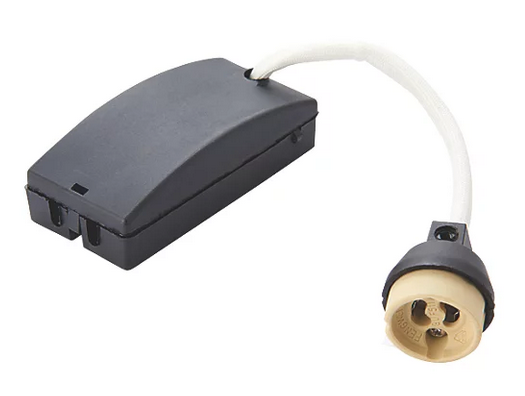

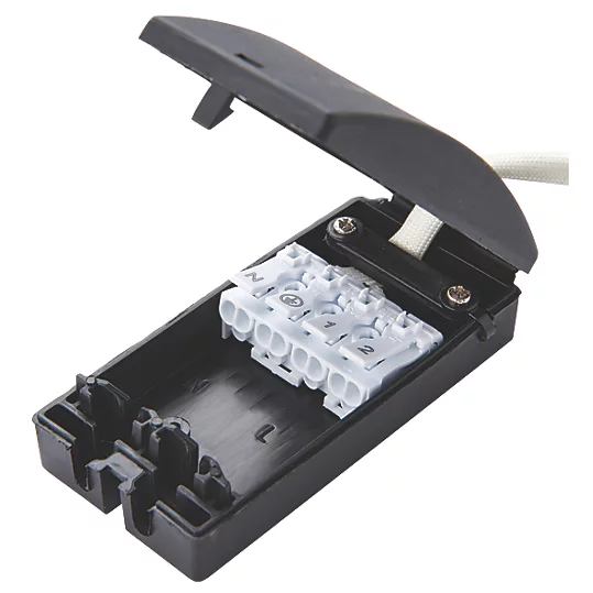

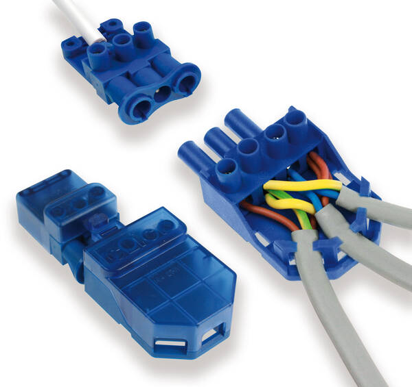

These seem to be what you have, and the pictures do not show the connections, it does say UKCA but a very poor lumen per watt output at 70 for a non smart, non dimmable unit. But they are cheap at £20, if fitted in an enclosure they would be permitted, I think rather poor not to have an enclosure, even the connector to convert g5.3 to gu10 comes with a connector like this 1698968221142.pngbut the adaptor cost more than your lights, 1698968389210.pngso being so cheap what do you expect? As @flameport says these 1698968665787.png are likely the best option at £2.39 each, it means in the future are wiring done at ground level.

Thanks all. I'm going to put this one down to experience and buy some decent ones for bathrooms. I'll use a couple of these (with enclosures) in walk in wardrobes where I've got long term access to the unit from above.
