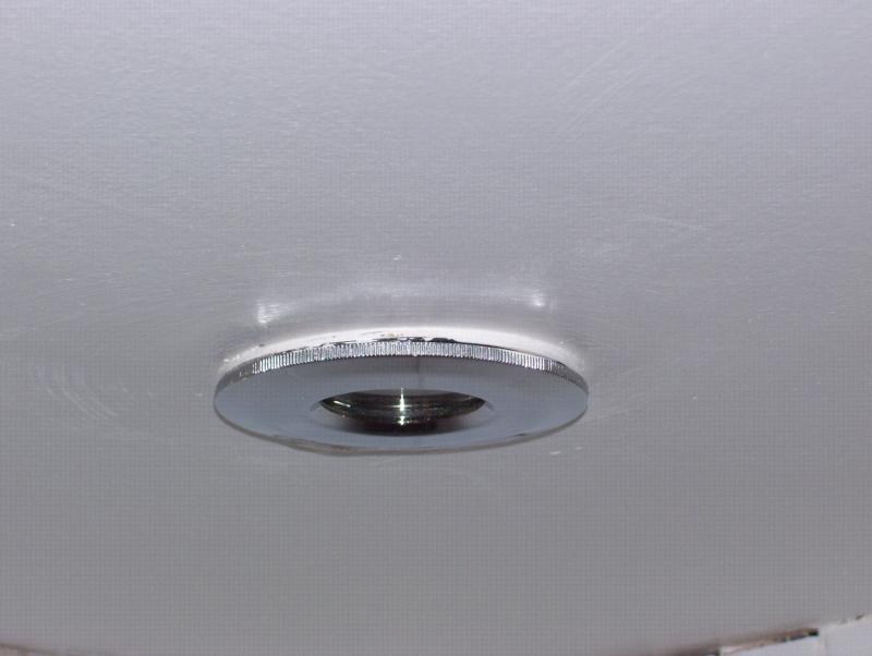

Hi. :!: I was wondering if someone could help me with a slight problem I have with my downlights that I have had fitted. They dont sit flush to the wall and consequently in daylight I can see underneath the fitting slightly and when the lights are on, light filters through from the gaps. Is there something I can buy/use to act as a trim round the lights (kind of like a large washer)? Thanks :confused:

Will these 'trims' have to withstand the heat from the lamps ?
Can you get hold of a picture of the lights, it may be more help to us.
Ed
Hi Ed. Hope I have done this right and you can see a pic. Not 100% sure as to whether the original hole they made wasnt quite big enough but either way, I would like to find something that will work to make it tidier.
thanks :)
Run a bit of decorators caulk round the fitting.
Although it makes em hard to get out of the ceiling if you need to later.
It is difficult to tell from the picture, but these type of lights are usually held in place by two clips and removing the light is by simply pulling the fitting out of the hole. I have had the problem you describe and it was caused by the hole not being big enough (about 2mm undersized). This stopped the fitting from being full inserted.
You have already suggested this as being the problem and in my limited experience that is exactly what it was.
To fix it, isolate the supply to the lights at the consumer unit, pull the light fitting out of the ceiling and open out the hole using a rasp or rough file.
The operation will cause a lot of dust if the ceiling is constructed of plaster board. Also be very careful of damaging ANY of the wiring.
The Light will then fit flush as designed.
