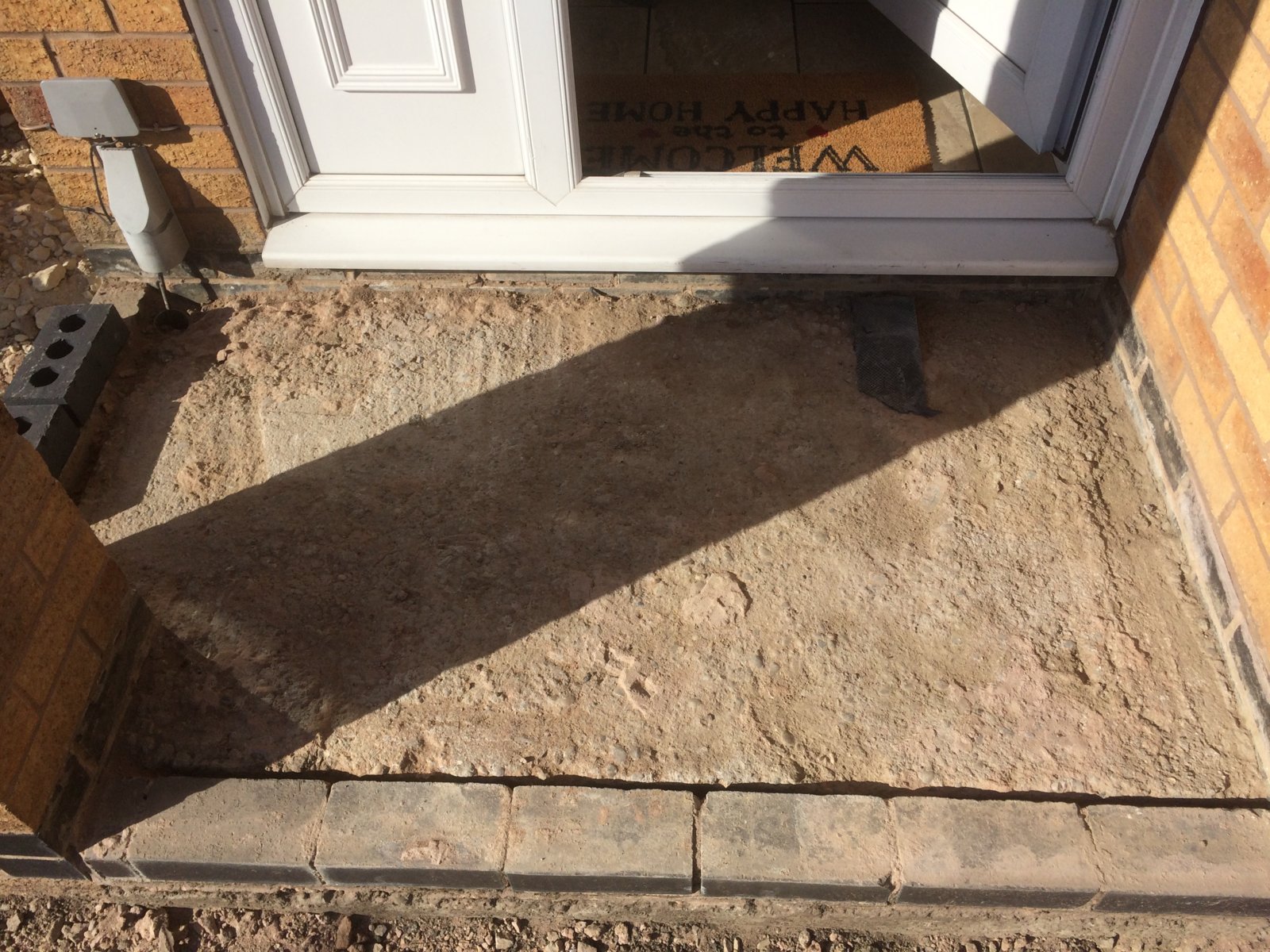

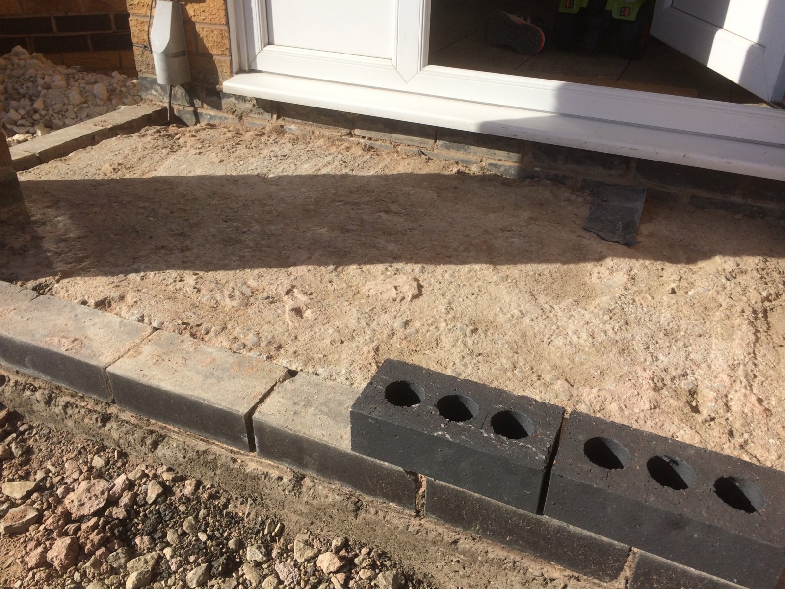

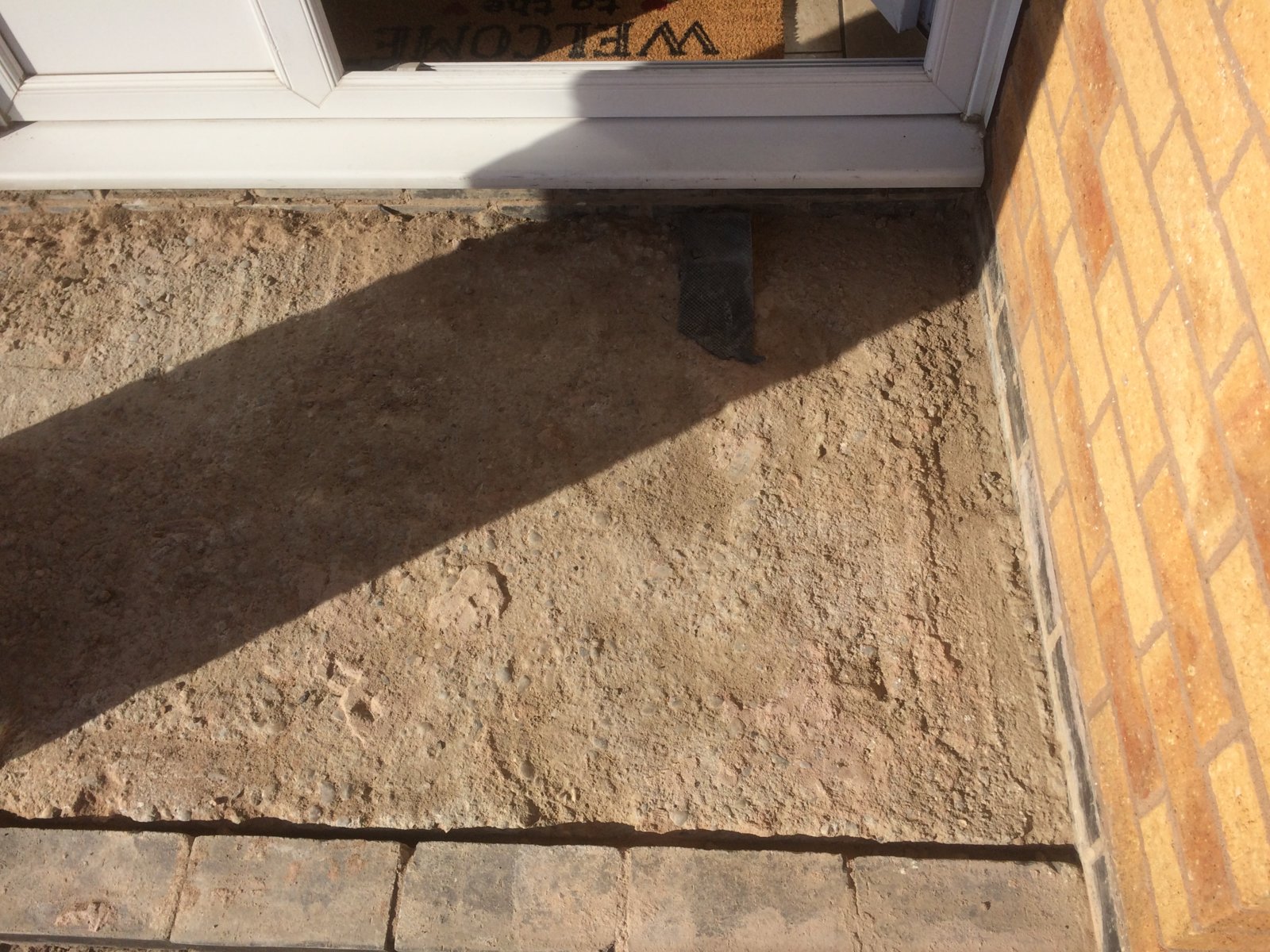

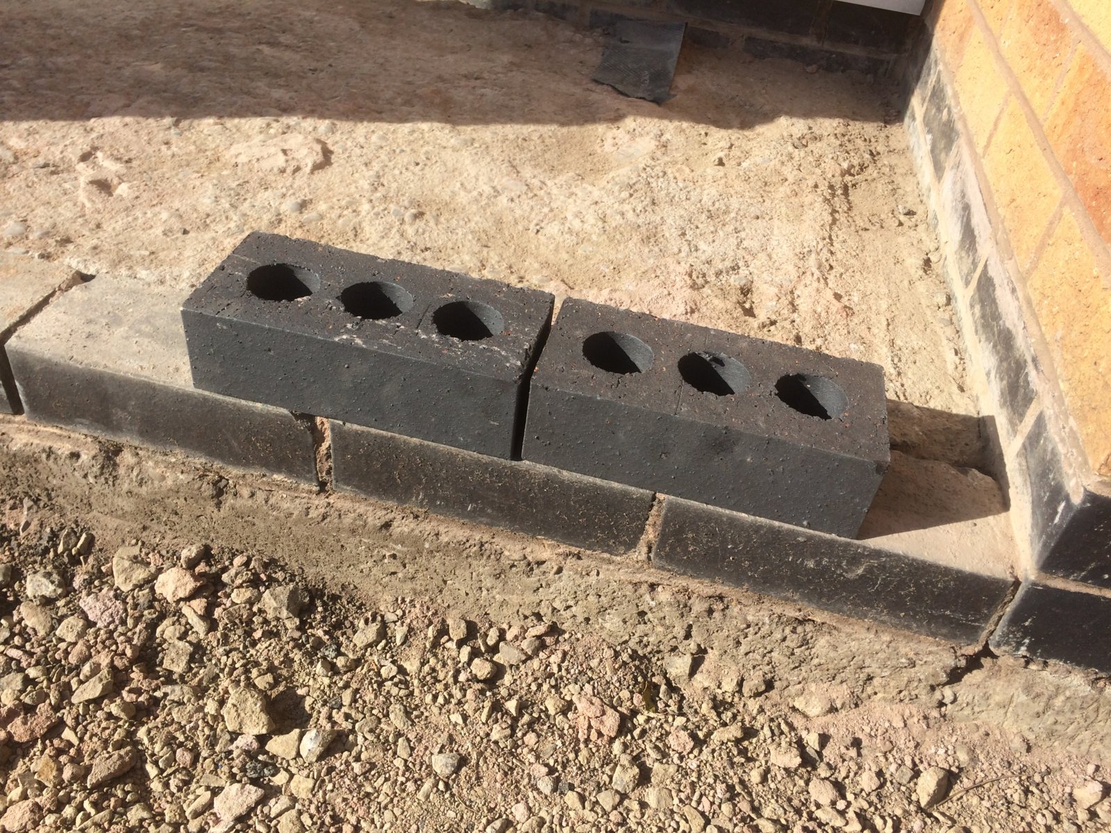

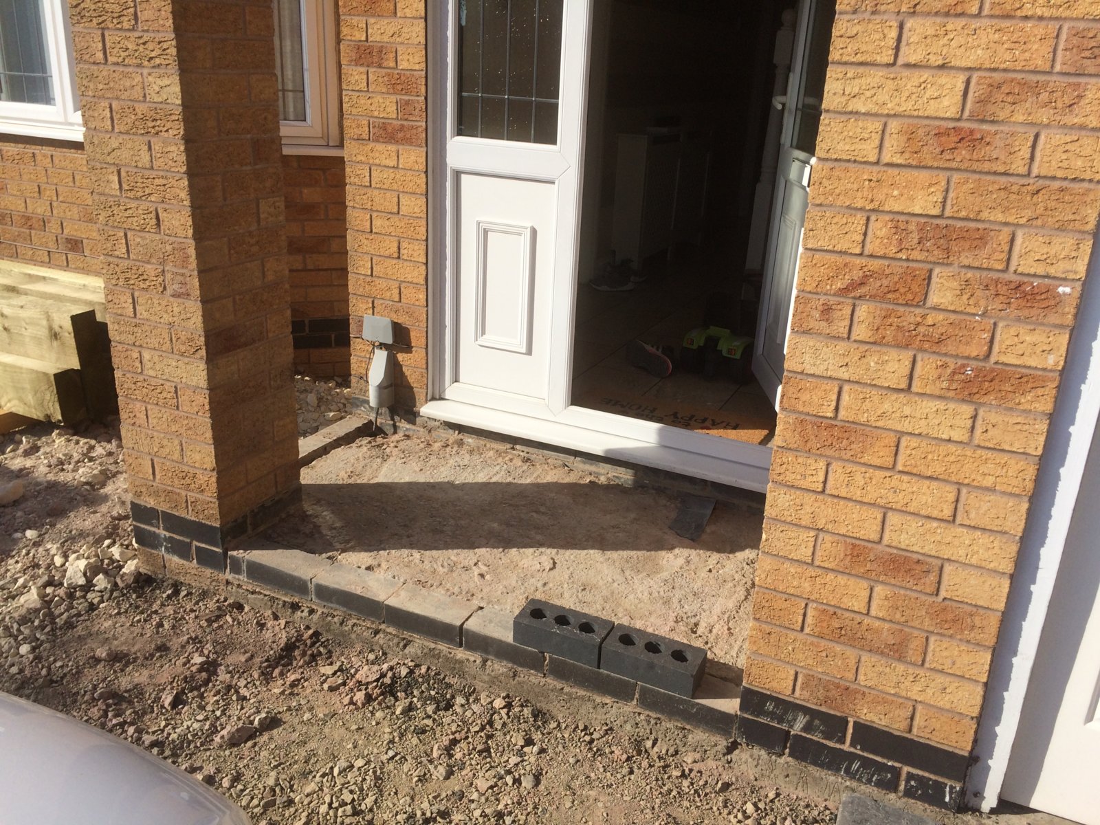

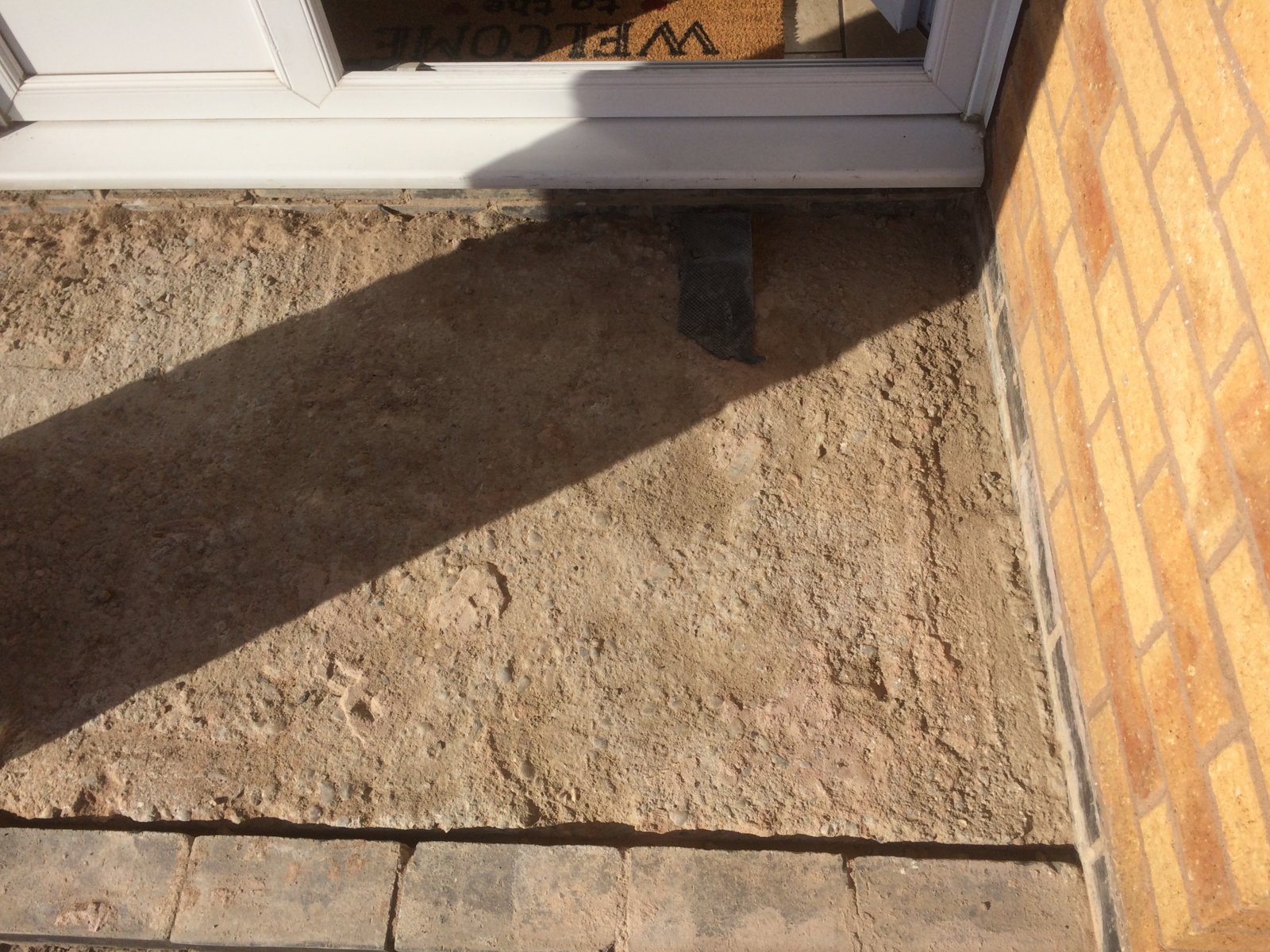

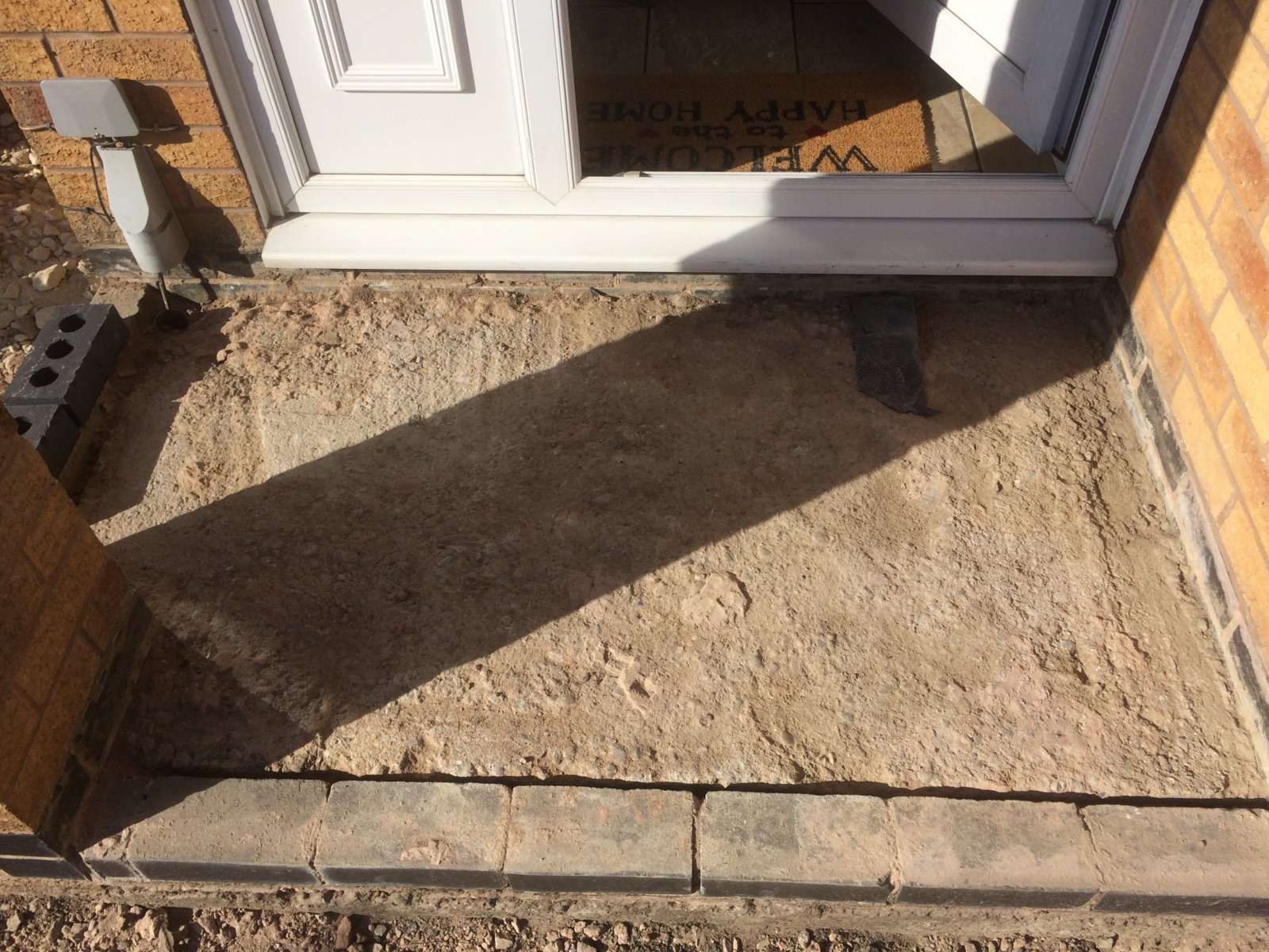

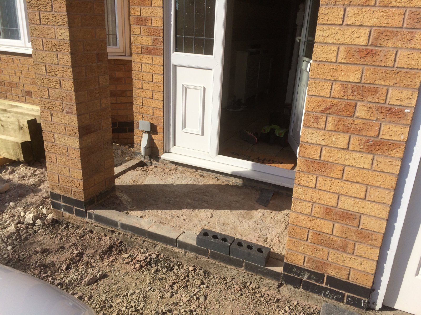

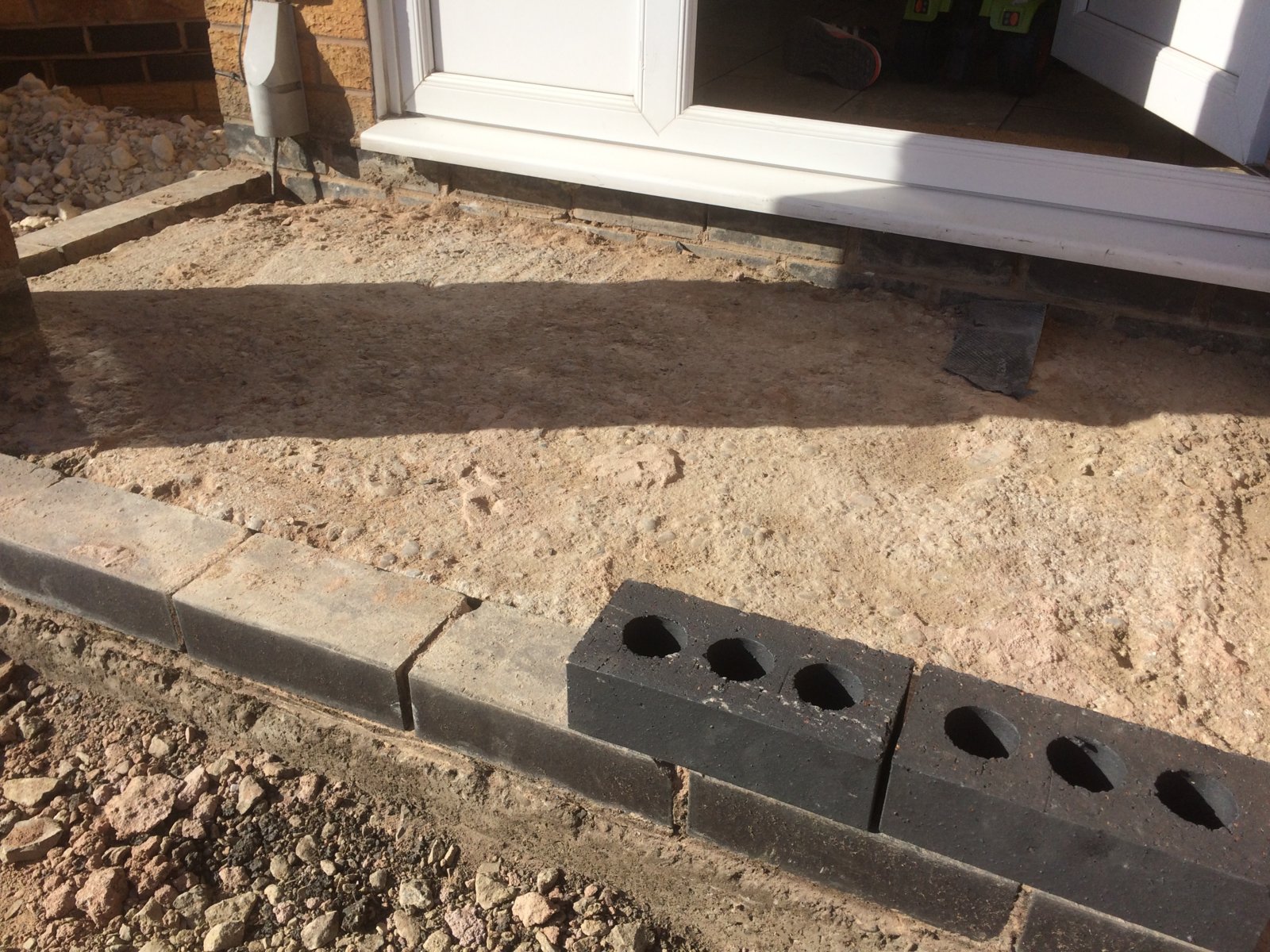

guys I’m looking for some advise, I’m looking to put new concrete floor in my porch before I put up a new upvc door, do I need to put dpc down first then concrete on that

Deano,
first glance says no concrete, maybe poured membrane, SLC then tile or somethin.
but what is it your tryin to do with your porch area?
is it
build up knee walls for w/frames and then set in a door?
have a finished tiled floorr ?
DPC's go in walls and membranes or DPM's go in floors.
are the dark bricks engieerin bricks?
your existin concrete seems to be to high an its bridgin the house DPC.
is this a new build house?
House was built 1996, yes I’m thinking of putting another blue brick in place and then putting dpm then concrete up to the dark brick, I’ll wrap the dpm over brick when concreting Then putting upvc door and frame?
