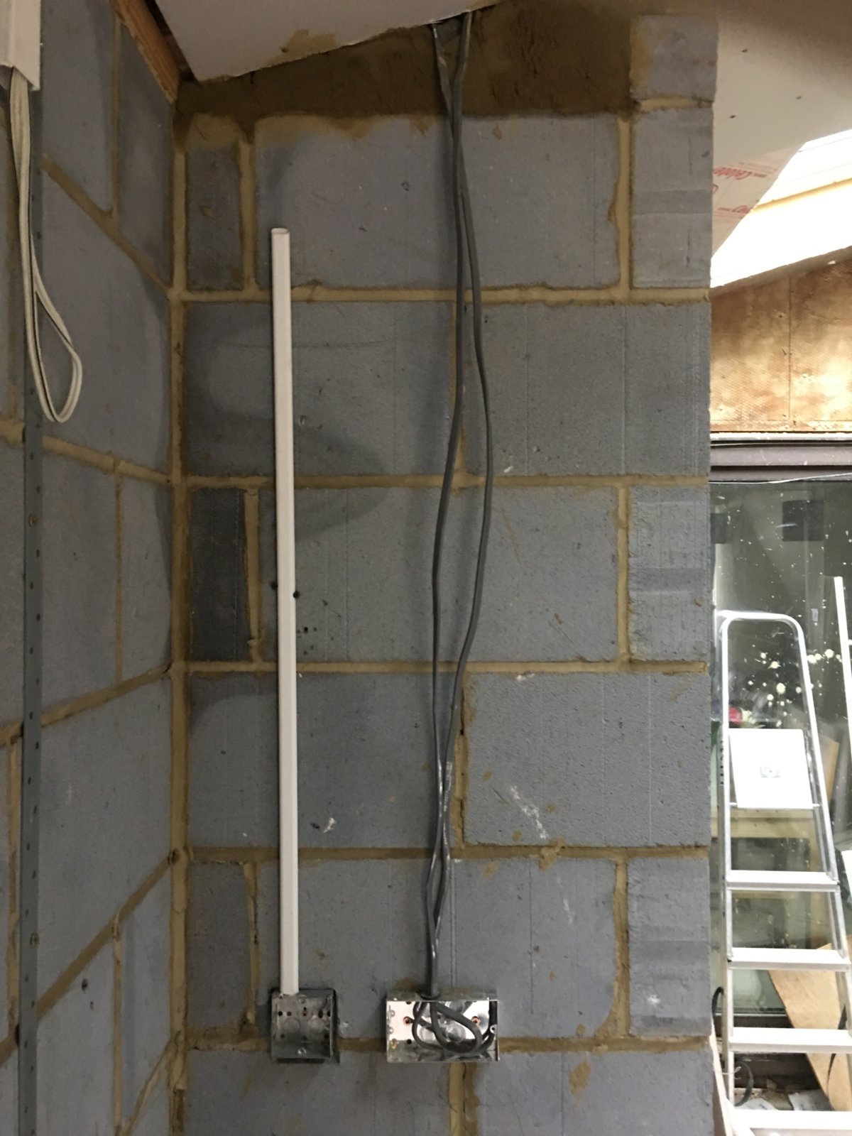

Draft behind plasterboard in new extension
This pic shows the kitchen ceiling. You can see the gap left at the top left of the image. No wonder there is a draft! Have a feeling I will have to drill and foam the top of that wall and hope that works!
There’s no insulation under the rafters.
There is! They put 100mm between and about 25mm across them before plasterboarding. Just can see it in the pics as the board hadn’t be cut round the window in that pic. Definitely there though! However, celotex is not the ideal insulation to prevent drafts as it’ll never be cut to perfection.
Oh right sorry, couldn’t see it but I can see the boards aren’t cut now you mention it.
I think your builder has let you down. He should have foamed then taped the joints between the 100mm and the rafters and then foamed and taped all the gaps in the 25mm (which I also thought should have been at least 50mm).

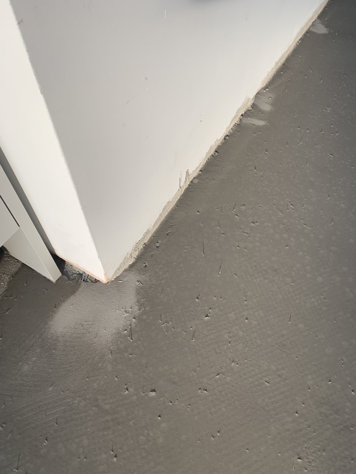

I’ve filled so many holes in the last 5 years with very dodgy walls that I’m not bothered by the hole filling really. I had a quick check if I could access the void from above and noticed that there is a 1-2inch gap under the first row of tiles before the Facia board starts. Another issue to deal with I’m sure! The first row of tiles are nailed but the second row aren’t and can be easily moved. I suppose it’s an option to go in from above (pulling the celitex board up to get underneath) and I’ll check with the builder before doing that. However, the hole foaming is something I can do easily myself and not rely on my builder messing it up! I’m sure that will work just fine but it’s a bit of a mess. I’m hopefull that this fix the issue!
Had the floor latexes today ready for the flooring and could see the draft from the walls drying the latex out! Not even breezy today at all! You can see the light areas on the pic.

My problem was with the plaster boards not being sealed at the top and bottom. I drilled a load of holes an inch or so from the ceiling and filled with foam. This helped but I then found that there were gaps at the edge of the screed blowing air from below the house! This is mainly an issue in the corners where the screed hasn’t sealed right against the wall. Will be filling these holes with foam too and that should make a big difference!
