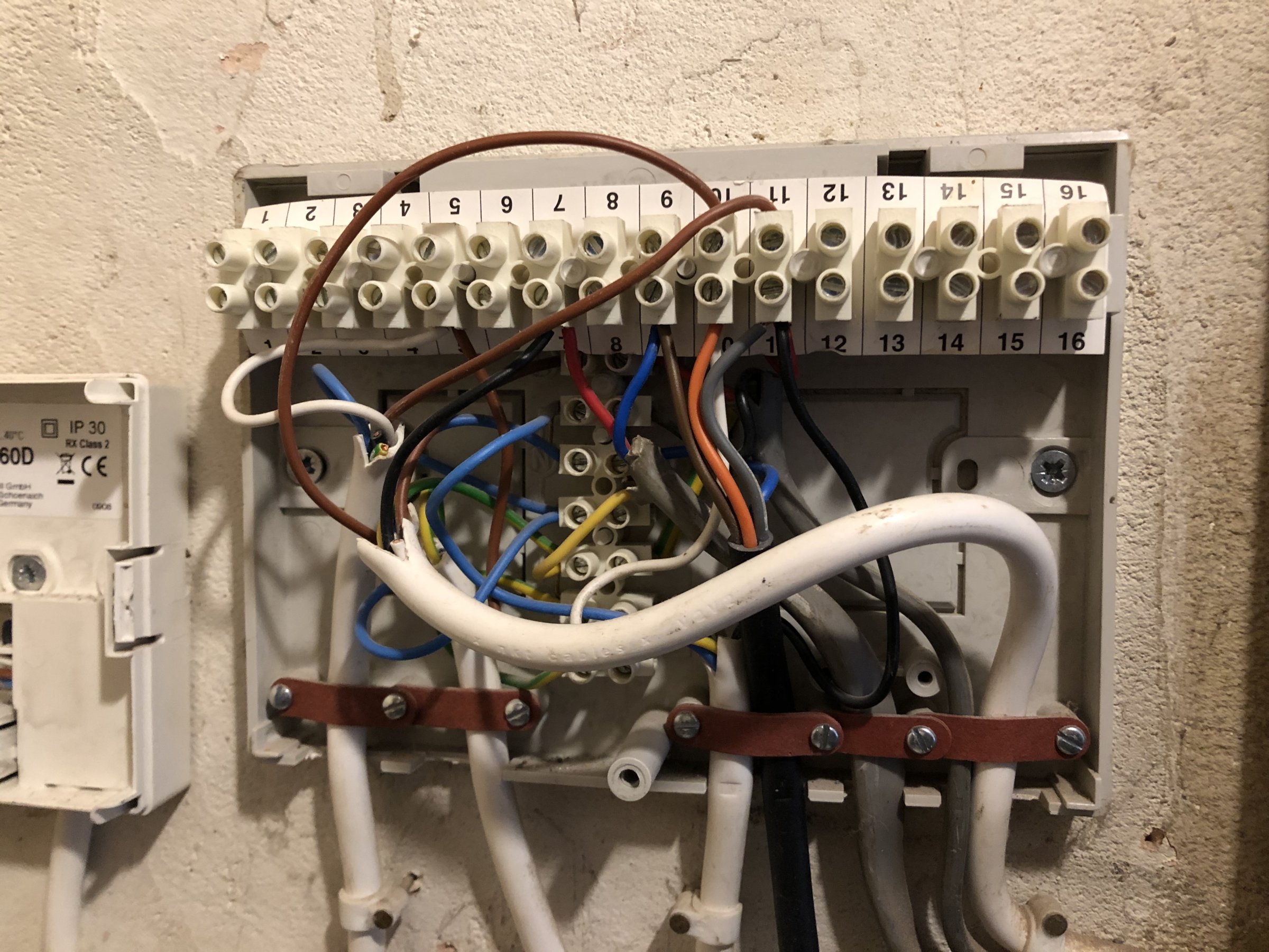

Sorry- yet another smart thermostat wiring question.

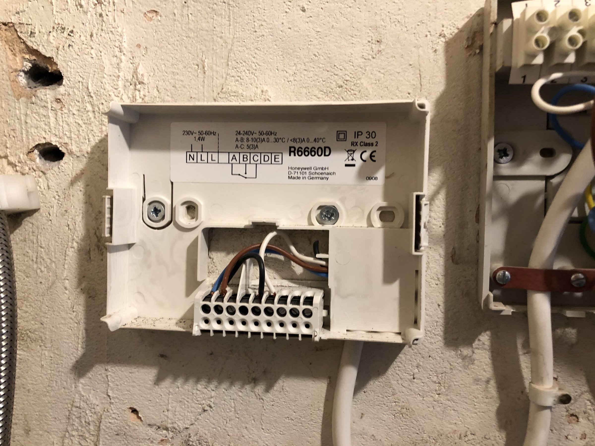

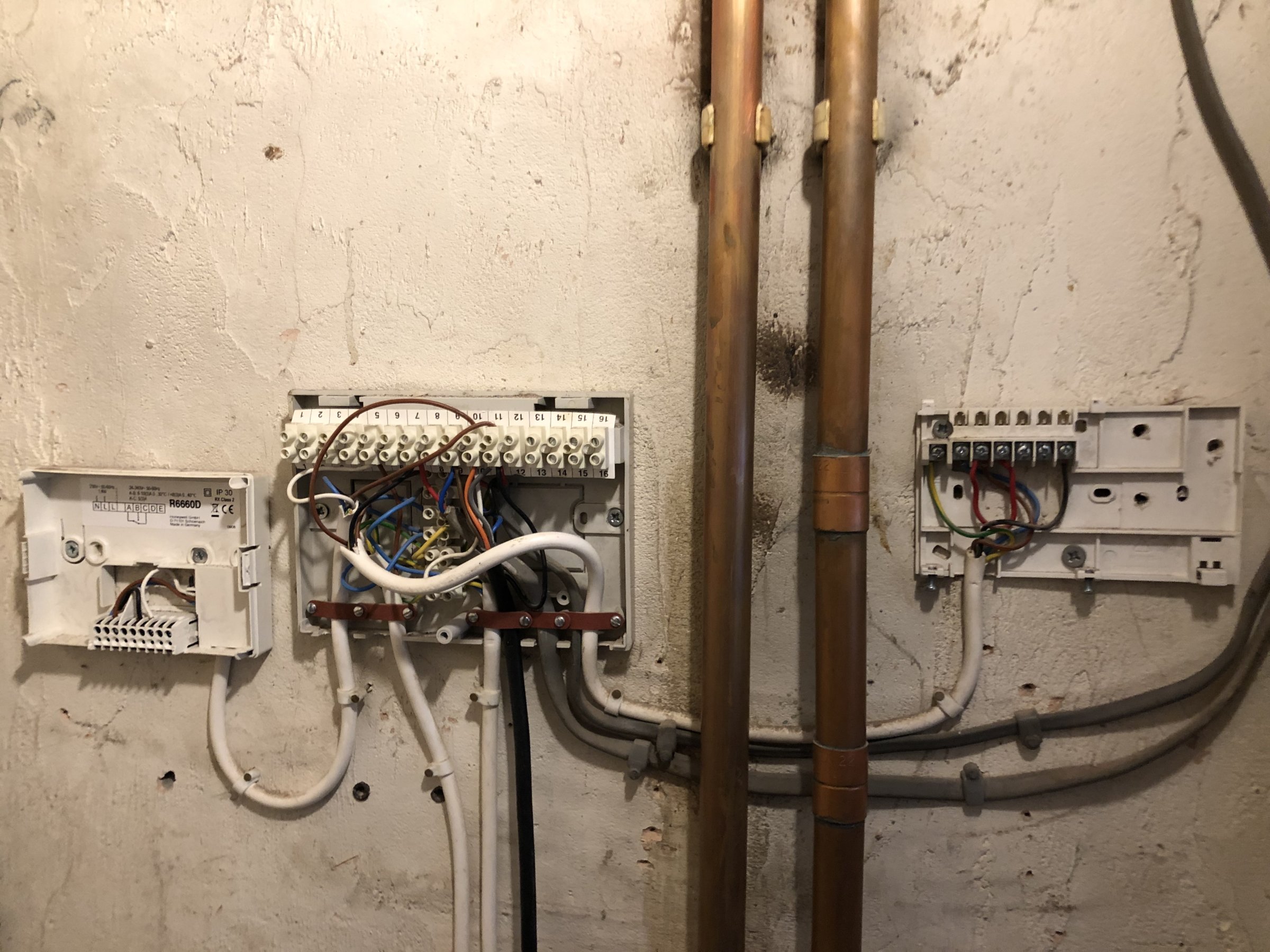

I want to install a Drayton Wiser two channel system. I currently have a Honeywell wireless thermostat (connects to a R6660D) controlling my central heating.
I have a Honeywell wired timer (ST9100c) controlling my hot water cylinder.

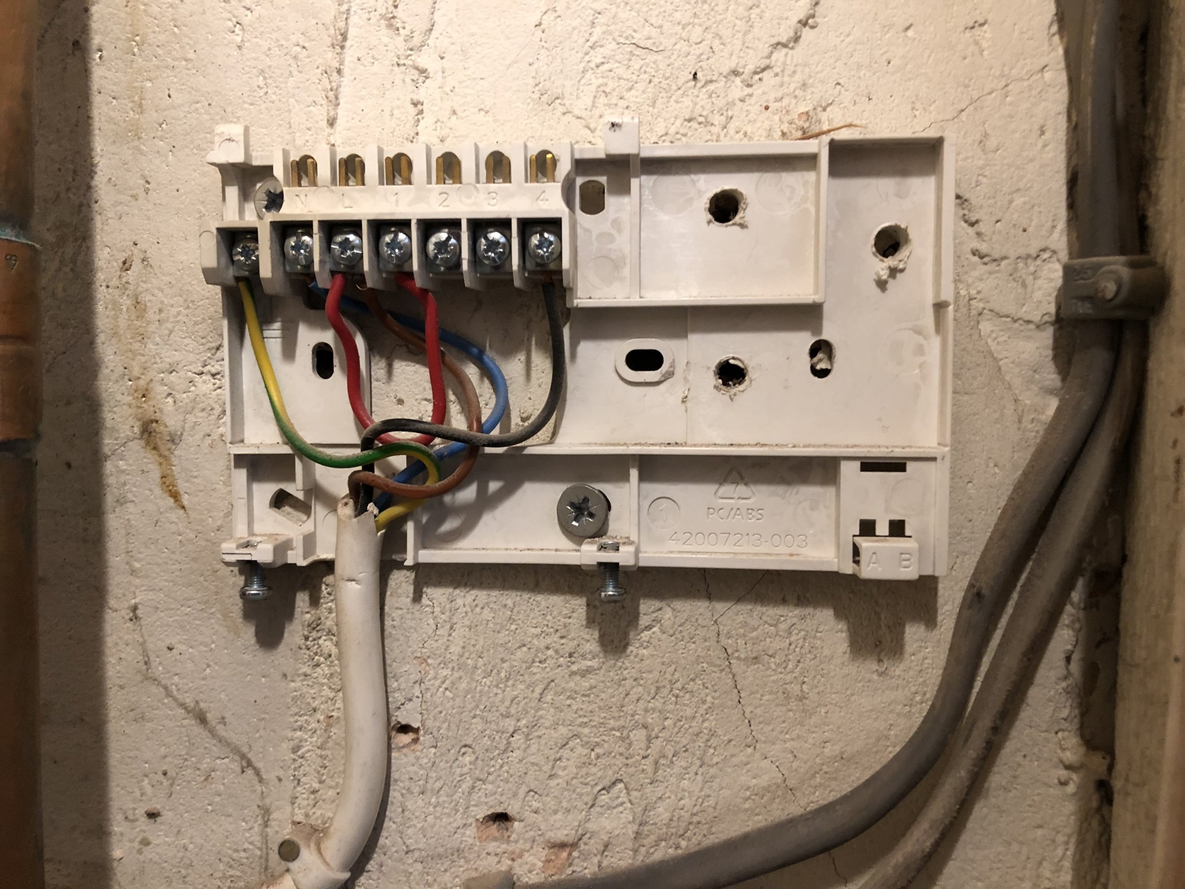

I have no idea how to wire these into the wiser back plate. I’m a competent DIYer but I’m not sure if this is beyond me (or even possible!). Here are photos of the current wiring-
This is the hot water timer.
This is the junction box.
This is the wireless heating thermostat receiver.
This is all three connected.
Any advice much appreciated. Many thanks.
The Wiser contains the switching for both heating and hot water, so the wires from the existing timer & thermostat receiver go to the Wiser instead. The link wires present at both of existing controllers are not required, as the Wiser has these made internally already. So, starting with the hot water timer wiring.
ST9100A Timer
The Blue wire now in the ST timer N goes to the Wiser two channel (N)
The Brown wire now in the ST timer L goes to the Wiser two channel (L)
The Black wire now in the ST timer 4 goes to the Wiser two channel (3) Hot Water On [This black wire is actually being used as a live, so it should have a brown sleeve over it to show this]
The Green / Yellow wire now in the ST earth goes to the Wiser earth

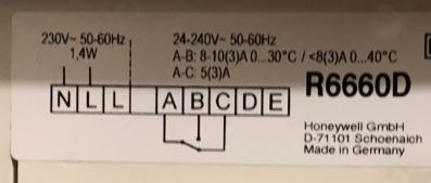

Then moving to the R6660D thermostat receiver wiring
Thermostat receiver
The White wire in the R6660D terminal B goes to the Wiser two channel (4) Central Heating On
The Brown Live in the R6660D, is not required at the Wiser because it has the L from the HW timer already connected. This wire can either be isolated separately, or put into the Wiser L anyway.
The Blue Neutral in the R6660D, is not required at the Wiser because it has the N from the HW timer already connected. This wire can either be isolated separately, or put into the Wiser N anyway.

I have, I think, an S Plan System, with two 2-port valves. I used to assume that the power supply to the thermostat ultimately spoke to the heating valve, and the power supply to the hot water timer ultimately spoke to the hot water cylinder valve. Based on what you say, I’ve been wrong about that, as the Wiser has only one power supply.
Presumably the Drayton will do what needs to be done to send power to each of the two separate port valves at the appropriate times, from its single power supply?
And presumably it won’t do any harm at all if, instead of isolating the extra N and L wires (which might be tricky, but I could look into it if you think it’s the better option), I wire them into the Drayton?
Thanks again.
That sounds like an S-Plan to me.
You are on the right lines with the theory. The existing two control devices are simply switches, on & off. Each has an input and an output connection.
There is a live output for the heating [the wire now in B of the thermostat receiver] that goes to the heating motorised valve
There is a live output for the hot water [the wire in 4 of the hot water timer] that goes to the hot water motorised valve (via a hot water cylinder thermostat, if fitted)
The N & L 230V supplies are there to power the devices, and the L is also used as the input to the switch which is why both existing devices have a short wire link between the L and the input to the switch.
The Wiser combines both switches for the outputs to the two motorised valves via terminals 3 (hot water) & 4 (heating). The L & N are there to power the device, but the link to the input of both switches to the L is made internally for you already.
The wiser doesn't need two 230V supplies. Personally I would use the Wiser terminals to put the spare wires in, rather than introduce additional terminals, or you could even snip the unused wires off at both ends of the cable, after disconnecting them at the wiring centre end of course.
As an illustration. If you had two single socket outlets they would each have wires going to them, but if you replaced both single sockets with one double socket then only one set of wires is required, (leaving the other set surplus to requirements) because the two sockets that make up the double are connected together internally. It's similar to what you are doing as regards the 230V supply. You are replacing two single switching devices with one double switching device.

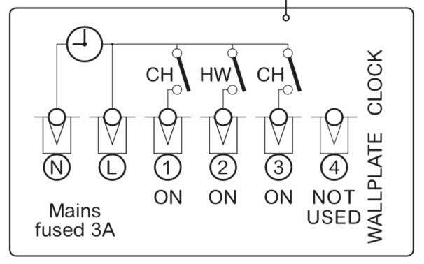

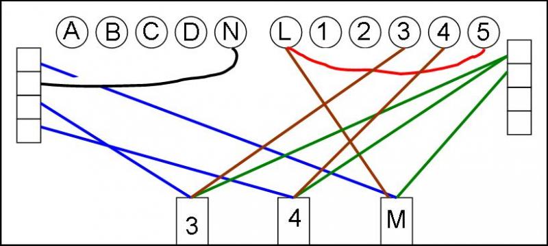

Hi, not sure if this is the right place to ask this question, but I have a simple set-up with a Potterton EP2001 with the attached wiring diragram that I’d like to switch to a Wiser set-up. 3 is hot water and 4 is CH. Do I just copy the wiring in the EP2001 but without the link wire between L and 5?
Hi Miguel
The Wiser has the link to L made internally for you already, so an external one is not required; hence no terminal 5.
If any of the other EP terminals are used A B C D or the earth and N strips at the sides, any wires in them should remain connected together exactly as they are now.
If you have an existing room thermostat it can't just be disconnected otherwise the heating wiring will be 'open circuit' and not operate.
