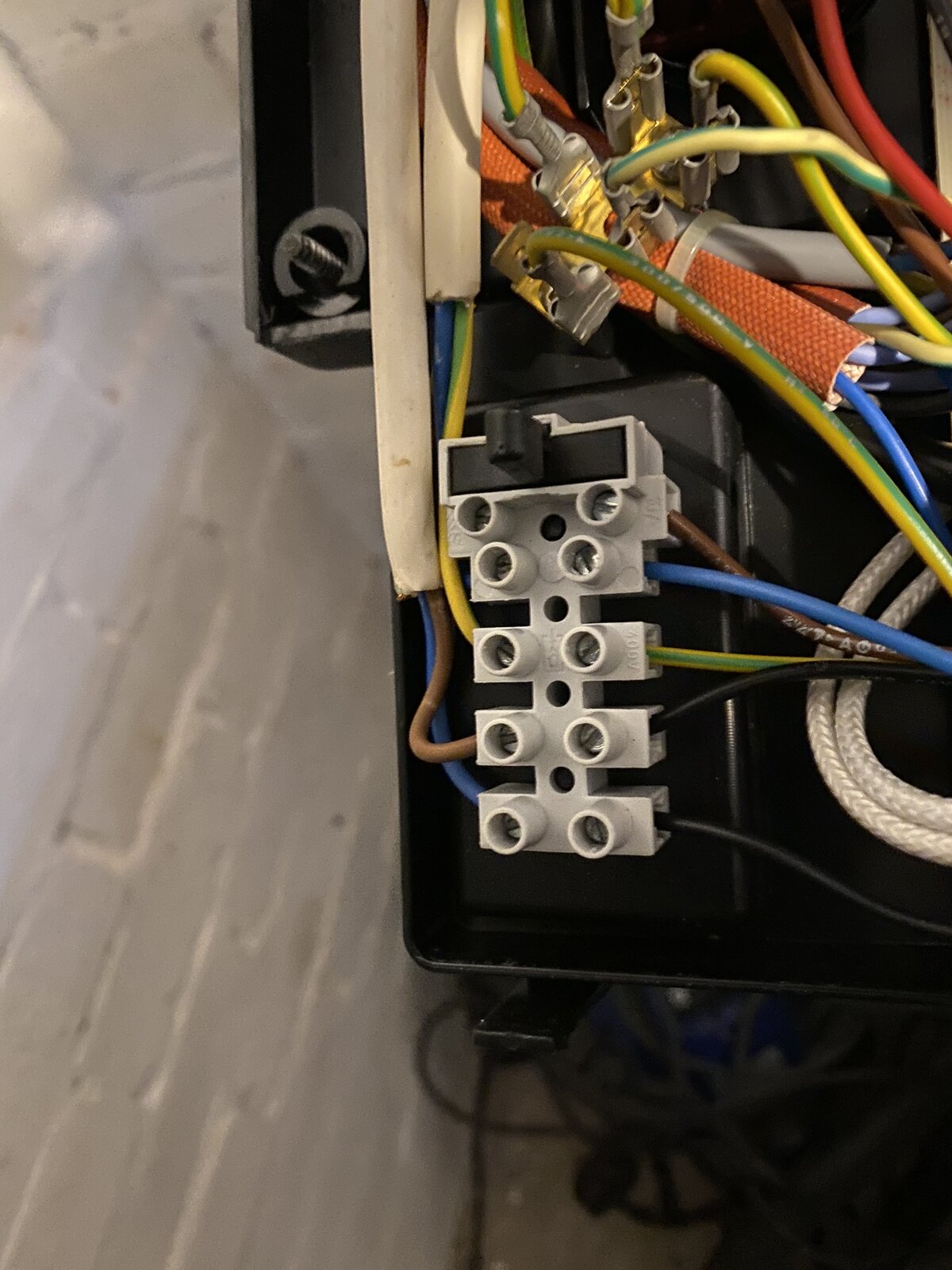

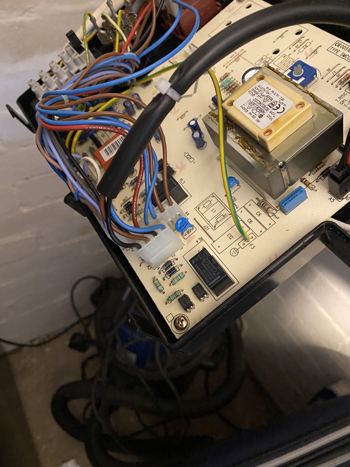

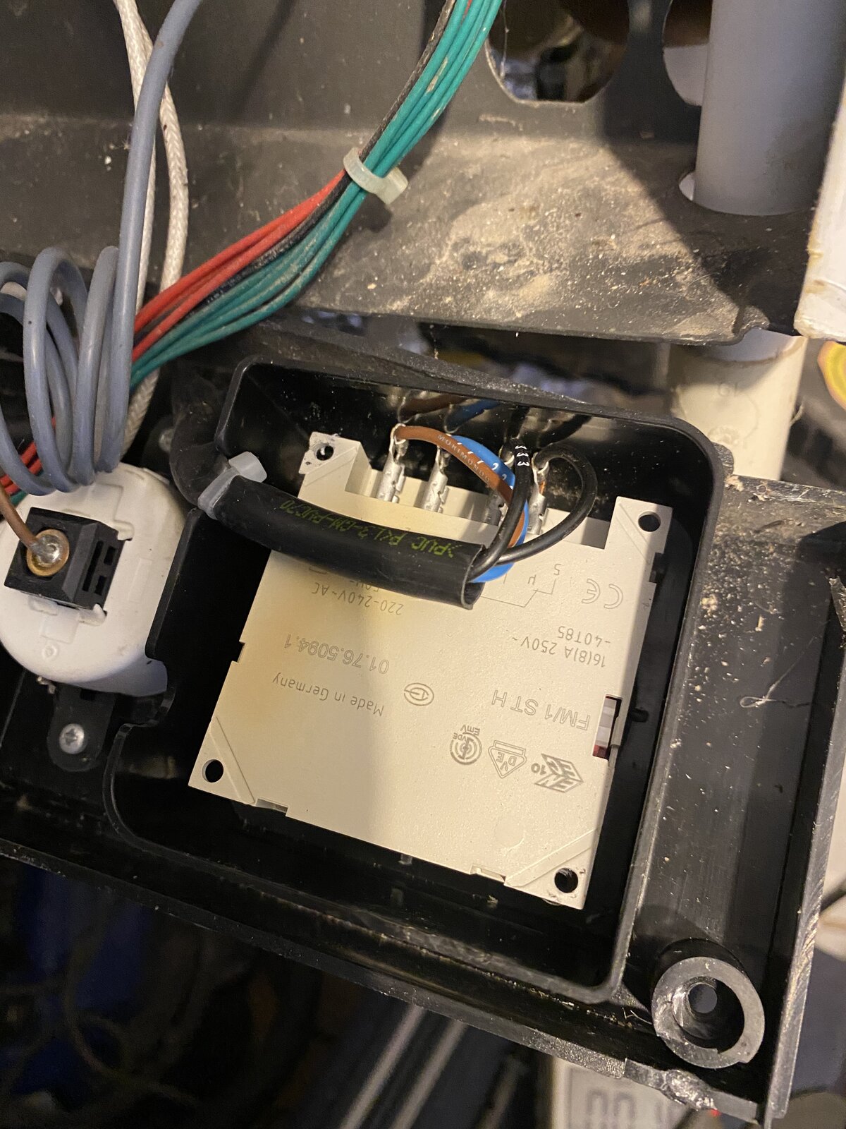

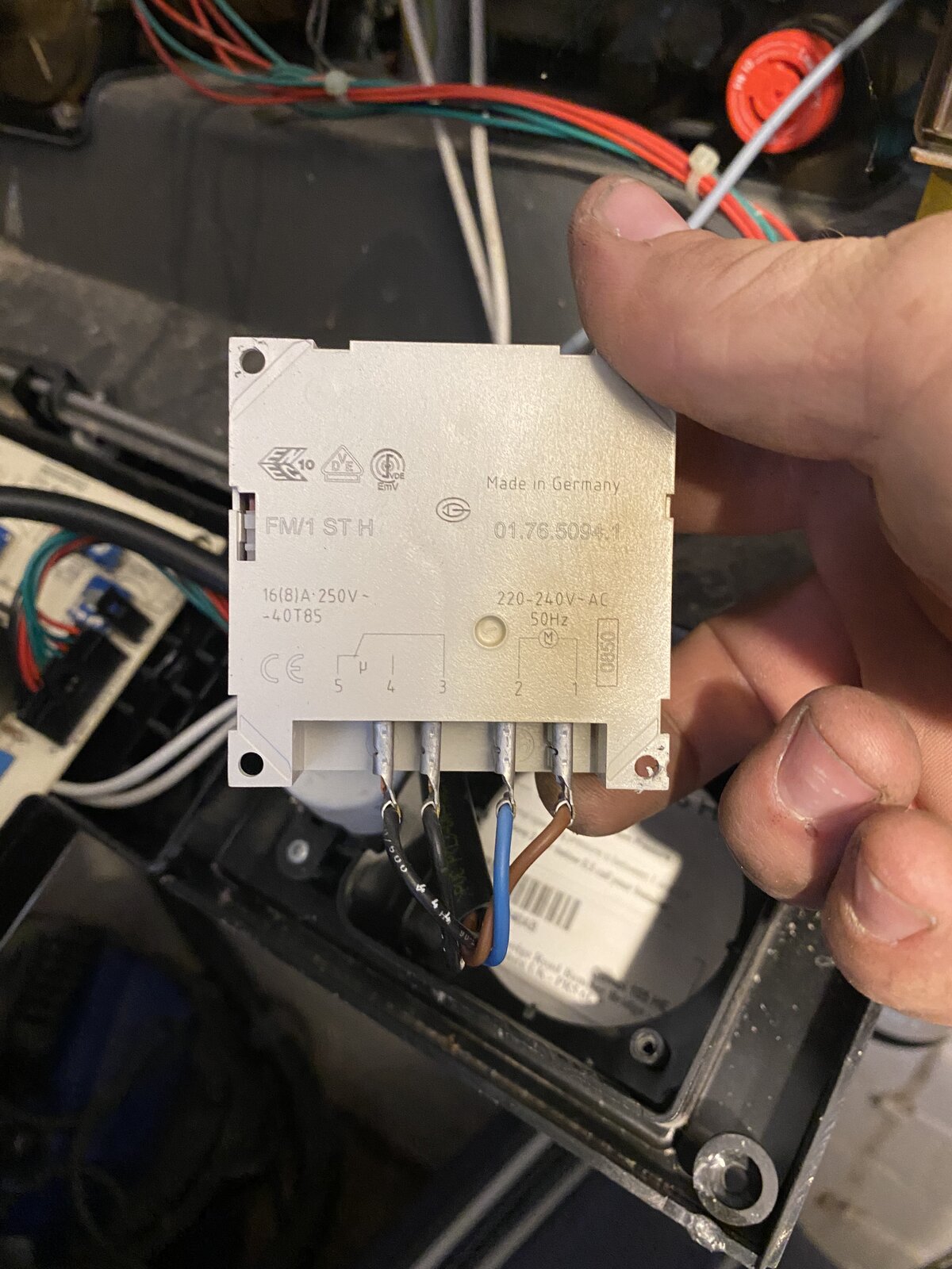

Hi finally got into house and getting round to sorting boiler with my wiser kit 1
Can anyone point us in the right direction to make sure it is wired correctly as looking around I think the boiler needs a permanent live
I’ve got some 4 core with earth cable see pics below of wiring

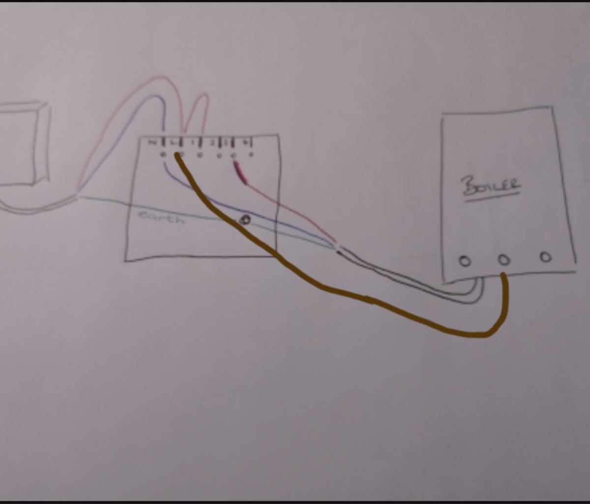

Also the last pic is another forum of someone with a similar baxi boiler

I don’t know the way to wire using the inbuilt timer other than altering wiring at pcb end. You can either decommissio the timer or set to permanently on. Yes, the boiler needs a permanent live, it also needs a permanent neutral too, which it already has.
You can piggyback the l/n/e wiring from the boiler or the spur if nearby, and then use the remaining switching wires.
Thanks for info I was going to decommission the old timer and go from the pcb board
It couldnt be simpler, the 4 wires connected to the inbuilt timer, blue to neutral brown to live, then the two blacks to 1&3, either way round it doesnt matter
Dont make any links at the drayton
Remember with this boiler when you turn the power back on , you have to hold the reset knob for 2 seconds to reset the boiler
