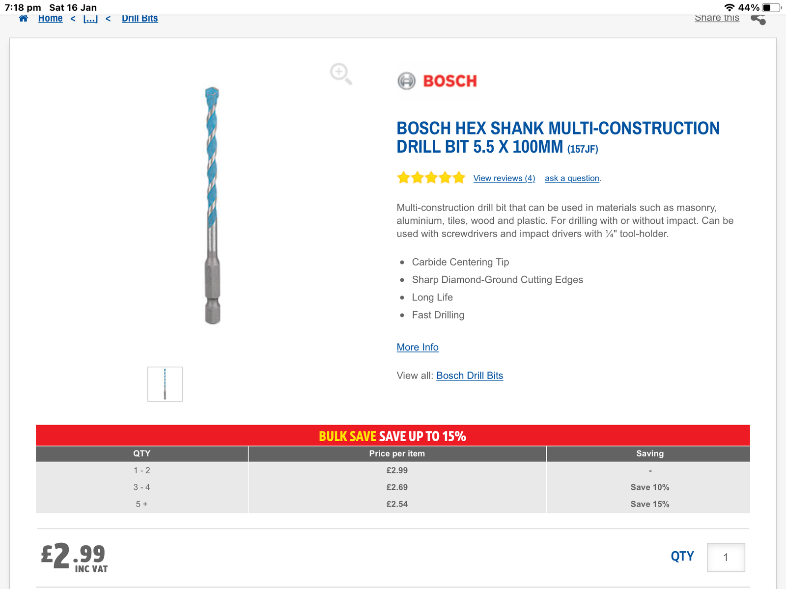

Bosch multi construction. Keep it cool .
I can get a good 20 holes through porcelain per bit.
Don’t bother with tile bits & the little diamond ones. Trust me. Just don’t over heat the tip. They are blue on the worm thread.

Do you think I should try them Bosch ones . The type your talking about are they blue on the tip ? Do you have a link to a pic ?
That type ?
